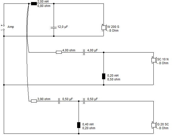

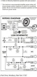

Hello all, i need some help from expert people about croossover design.
I have some normal hifi speakers model jbl l830. They are monitors/bookshelf.
Since i m in lockdown at home because i m positive to covid and i have some sb acoustics drivers around for serveral months (plan to build a good speaker) i start to look at jbl croossover and to my understanding i tried to swap the original jbl tweeter for my sb acoustics satori tw29rn-b-4. I got a mdf base for the sbacoustics tweeter and put it on top.It sounds ok and i like the sound but i see jbl tweeter are only 3.3 ohm.
I attached the jbl schematic. I appreciate if someone with experience could look at it and see if the satori is working ok with that type of croossover or if is needed to change some values. I have some resistors laying around and also some caps and coils. I m using the orginal croossover but with better parts, better caps and a better coil in woofer.
Thks[emoji846]
View attachment 918330View attachment 918331

Not clear to me if the SB replaces the HF tweeter or the UHF supertweeter.
You should run a sim to see how it works.

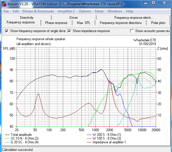

Software | Visaton
Import a similar project into the projekte folder and set it up the JBL way:
3 Wege – Boxsim Projektdatenbank
This might be quite close:
Lotte – Boxsim Projektdatenbank
I don't think your current impedance will be bad with those resistors bumping it up. But generally you make tweeter capacitors bigger and shunt coils smaller with 4 ohm tweeters. Say 5,6uF and 0.15 mH on the tweeter.
It's also quite common to put, say a 2.7R resistor in series with a low impedance tweeter after the filter to make it behave like a higher impedance one. The DC resistance measurement can help here. Usually 6 ohms with an 8 ohm nominal driver.

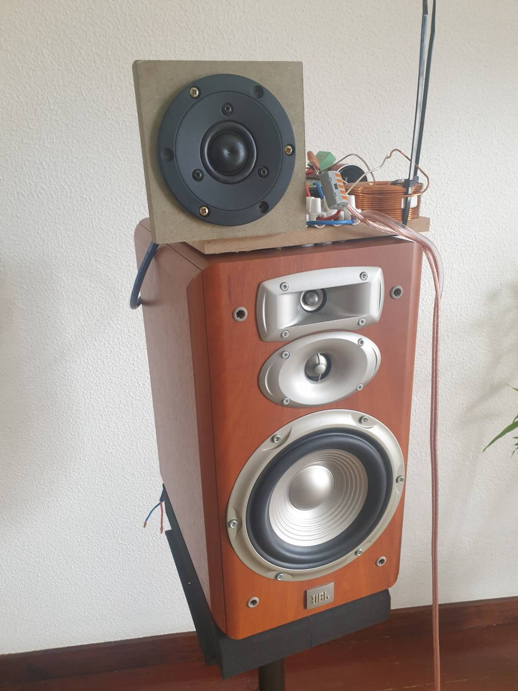

I ran your JBL up the flagpole in a very loose way to see what it does.
First observation is waveguide tweeters are very different animals from dome tweeters:
H1499-06 27TBCD/GB-DXT
H1147-06 27TBC/G
It was all bad news for a simple tweeter swap. 🙁
Nothing will blow up swapping tweeters, but the sound goes all over the place. The supertweeter circuit is dreadful too. Clearly they gave the new young graduate a cheap project to cut his teeth on. That 0.4mH in the supertweeter circuit is plain wrong. Should be much smaller. 😀
I would save that SB Satori tweeter for a better prospect. Few projects here: SB Acoustics & Satori Brand Archives - Madisound Speaker PDF Library

That is a very wrong way to achieve anything meaningful. Forget the swapping tweeters in a crossover designed for another tweeter.... i tried to swap the original jbl tweeter for my sb acoustics satori tw29rn-b-4.

You are plain wrong....The supertweeter circuit is dreadful too. Clearly they gave the new young graduate a cheap project to cut his teeth on. That 0.4mH in the supertweeter circuit is plain wrong. Should be much smaller.
The supertweeter circuit is OK, the 0.4 mH inductor is spot-on.

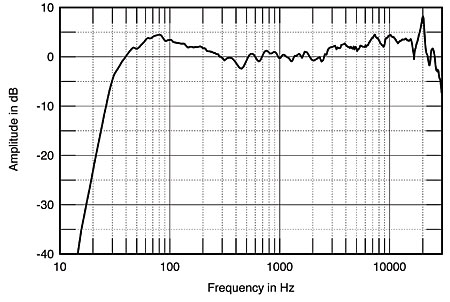

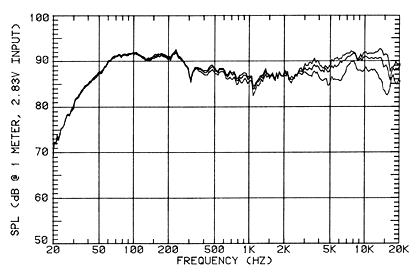

The same tweeter/supertweeter combination from L830 also is used in larger models L880 and L890.
L880 measured frequency response (from Stereophile):
JBL Studio L880 loudspeaker Measurements | Stereophile.com
L880 measured frequency response (from SoundStage):
SoundStage! Measurements - JBL L890 Loudspeakers (6/2006)
Excellent tweeter-supertweeter integration. Elevated highs, though.

on your schematic i see you put 8 ohm drivers.. is that ok?
i think the are 4 ohm..or i´m wrong?

There was no way I could know that your JBL is 4 ohm drivers. You didn't tell me!
Nevertheless, my comments about the supertweeter circuit stand. A rotten design. 😀
The ratio of capacitance to inductance determines the impedance of the circuit.
Here dipping unnecessarily low at 8kHz. A schoolboy error that even Sonce should have picked up. 😱

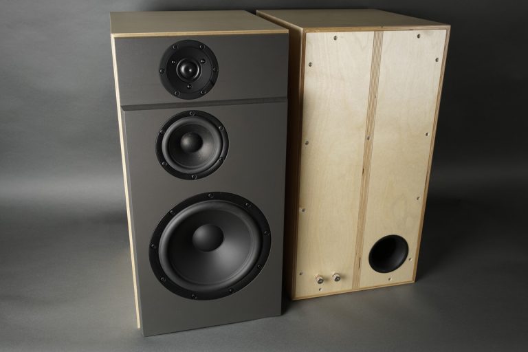

What I moght do in your situation is build an MTM.
Should be affordable. And certainly very nice. Adapting this sort of crossover is easy enough. You could proabably use any SB 5" drivers you fancy if well behaved. I will help you, if you are interested.

Also i have this MW19P-8 woofer. But i can buy 5 inch woofers and build MTM if they are good and afordable, the same apllies to the tweeter.
I think there is a reasonably good loudspeaker lurking in there!
SB Acoustics Satori MW19P-8 Midwoofer
Your woofer has a bit of nasty breakup lurking at 5-6 kHz. We ought to crossover much lower than that.
Therefore I am thinking 2kHz positive polarity.
What we are trying to do is apply some mathematics:
Main issue for you is the box, which looks like reflex 20-30L. Can you build it or buy something second-hand which is adaptable? 😀

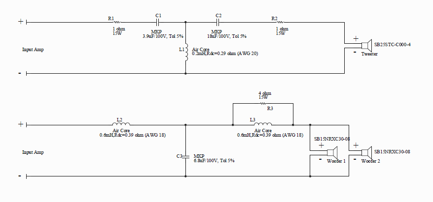

We might get away with something fairly simple, albeit adapted to 4 ohm tweeter with bigger capacitor and smaller coil :

How on Earth can it be a rotten design, when the transition between tweeter and supertweeter is perfect?! See yourself:Nevertheless, my comments about the supertweeter circuit stand. A rotten design.
Even a schoolboy will not make an error you are constantly making - to use a completely different tweeters (Visaton) with the crossover designed for JBL (or other) tweeters.Here dipping unnecessarily low at 8kHz. A schoolboy error that even Sonce should have picked up.
My opinion is: supertweeters are a pure marketing trick and are not required with any competent tweeter.
My learned friend, Sonce. As your experienced Engineering Supervisor, the subject under discussion is this Satori Woofer and this Satori tweeter.

No, the subject under discussion is whether JBL L830 crossover can be used (eventually with some modification) for that particular Satori tweeter:
But it can be modified only if there are measurements of Satori tweeter, which you did not have! It is very wrong to try to design crossover without measurements of exactly that Satori tweeter - it is the mistake you are continually making: trying to design crossover for other drivers, using measurements of Visaton drivers. It is wrong!
Because of that mistake, you are making another mistake, proclaiming JBL crossover faulty:
The correct answer is: No, that crossover can not be used, unless heavily modified.I have some normal hifi speakers model jbl l830.
On the contrary, the JBL supertweeter circuit is good, as can be seen on measurements (post # 13)Nevertheless, my comments about the supertweeter circuit stand. A rotten design.
Obviously, NOT with simulation based on Visaton drivers!...this Satori Woofer and this Satori tweeter.
But you don't know till you try it.
Regarding the croossover i like the simplicity and low values, so if it could work like that i will do it. I just understand that if the tweeter was 8 ohms i will get away with lower values...
Regarding the first grafh, it says "2 way 4°order" that is a more complex filter correct? Can you explain? It is a more radical cut between the 2 drivers?
Having slept on it, I think your SB project is doable.
Mr. Troels Gravesen is being a bit secretive with detail, but he got this to work:
MW19P-8
All a bit experimental. But I incline to this sort of crossover with a bit of fiddling for a loud 4 ohm tweeter:
Ought to do something right. Bit undecided if a LC tank-notch across the bass coil might help here. Some severe breakup on the woofer.
MW19P-8
Is the tweeter inverted?Having slept on it, I think your SB project is doable.
MW19P-8

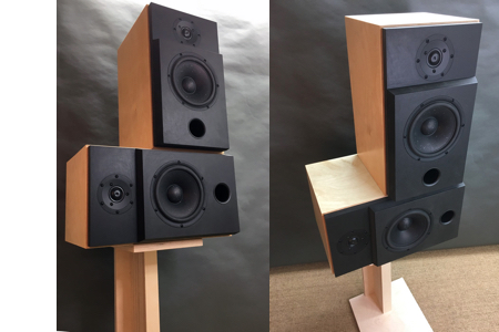

I don't suppose the stepped baffle is all that big a deal. Flat baffle would probably work.

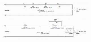

I was trying to annoy Mr. Gravesen by deconstructing his crossover:
https://www.madisound.com/library/stacks/SB17NRXC35-8-and-SB29RDC-C000-4.pdf
Not an immediate issue, because the woodwork comes first. But that Madisound design seems to do the right things. SB Acoustics SB17NRXC35-8 Midwoofer
It has an LCR woofer notch, but we might simplify it. Still a bit of a beast to build. How it is.
MW19P-8
