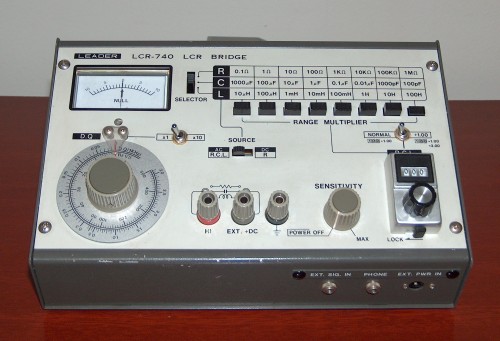

I still use my trusty Leader 740 LCR bridge bought in the 80´s 😀

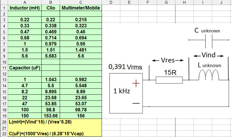

Your method is too out of fashion. Serious members are not used to improvise on impromptu instrumentation.Lojzek said:To assess lcr values it would be perfectly satisfactory to employ Arta and/or Rew. I have made an experiment on how to determine L/C with only a smart phone(1kHz sine .mp3) and a single 15R in series with an uknown L/C.
