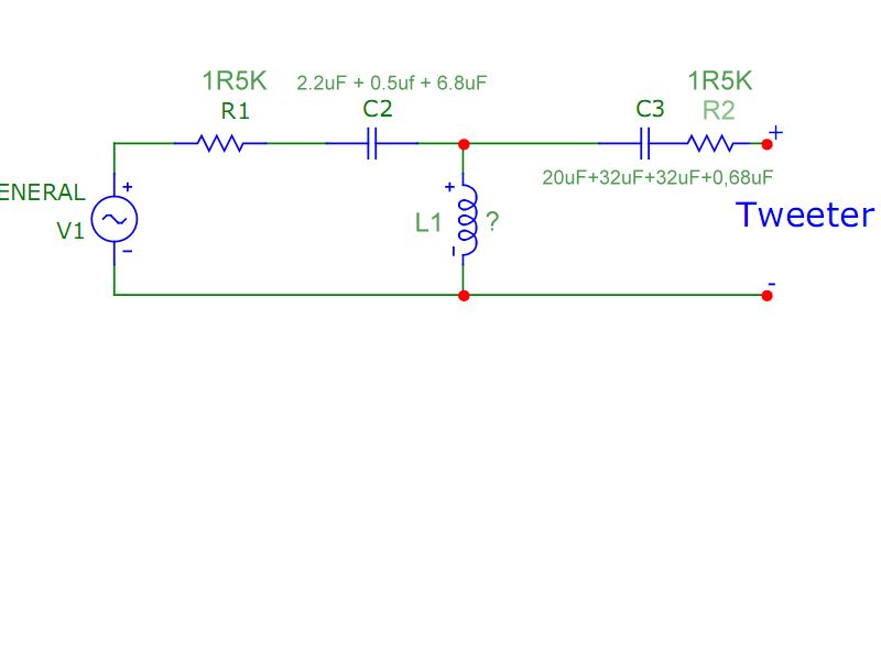

hi guys. I need help with this crossover. I wanted do change all caps with better ones - most of them are Electrolytic cheap caps. The thing is that they are 84uF in total... it is hard to buy such big caps.
Is there any way to change values C1 and C2 without changing L1 and make them "easier" to find? Something from range 2-20uf.

Judging from your circuit diagram, I think you need to recheck your values and your circuit.

Also note in the schematic diagram provided by the original poster, there are TWO 5k ohms resistors in series with the tweeter. That would mean that the tweeter would only be getting 1/1000th of the supplied signal. That just doesn't seem right.
I suppose there are other ways of interpreting the values. 1R could mean 1 ohm, and the rest could be related to ohm tolerance and temperature code, or some such. So, 1 ohms, 5%, 'K' temperature coefficient, or similar.
For a stock 2nd order electrical crossover, the values would be about 3.6µF total. That would before a Linkwitz-Riley; a Butterworth would be about 5.2µF, and a Bessel would be about 4.2µF.
For a stock 1st oder electrical crossover, the values would be about 7.4µF.
So, the values you are giving don't seem remotely correct.
Can you confirm they are in series and not in parallel, though either way they still don't add up.

I think you need to give us a photo of the actual crossover, and a much better diagram.

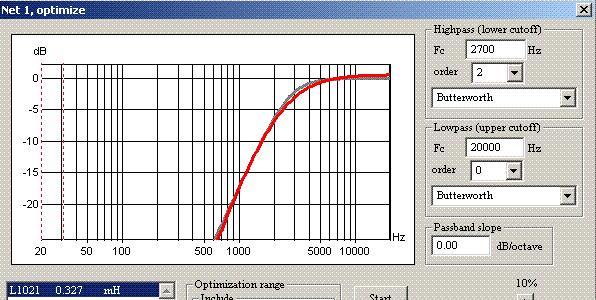

The schematic provided*, produces an almost perfect electrical 2nd order butterworth rolloff at 2700 hz, into a perfect 4 ohm load. If the tweeter has a reasonably extended low end response, we've got no problems here.
* Using a 0.33mH inductor.
I assume the resistors are 1.5 ohms or something similar perhaps.

I have checked again. The values and schematic is fine. Caps are parallel. The resistors in series with the tweeater are 1,5Ohm - not 1.5k - but they are branded as 1R5k - it is misleading I think a litte bit.

While the spec sheet on the M33i speaker says 2nd order Acoustic crossover, but the configuration of parts is for a 3rd order filter (C2, L1, C3).
The values we have from the original poster are C2 = 9.5 µF and C3 = 84.68µF.
I looked up the resistor markings and they are indeed 1.5 ohms each.
Using a 4 ohm tweeter and an 8 ohm woofer, the standard values for a 3rd order at 2,700hz are -
C2 = 9.8µF
C3 = 29.5µF
L1 = 0.18mH
If I adjust the frequency on the Crossover Calculator I am using to see what frequency give me the correct value for C3, I have to drop the frequency down to 940hz, which gives me a C3 of 84.65µF.
They may have done something with the second (C3) capacitor to alter the response curve slightly. So, it could make some limited sense. Though without a circuit simulator, I'm not clear how it would alter the filter.
Perhaps the have created a 'staged' or 'cascading' filter. Maybe as the frequency goes down, it rolls off at 12db (2nd order) between 2700hz and 940hz, then when it reaches 940, it continues to drop at 18db (3rd order)?
There are certainly those here who know way more than I do, but to my limited knowledge, this is the only way I can make sense of the values I'm seeing.
Now the only remaining question is, what is the true value of the inductor? My calculations indicate something in the range of 0.18mH. But, in this non-standard configuration, I'm not sure how much we can rely on 'standard' values.
I suppose one could measure the dimensions of the coil, count the number of vertical winding and the number of horizontal winding layers, estimate the wire gauge, and use that to make some determination of what the likely inductance is.
As far as replacing the cap, a quick look at Parts-Express.com indicates that the nearest full standard value is 82µF, and I did see crossover caps that go as high as 200µF. So, it is possible to buy them in this range.
In your case, perhaps a 47µF plus a 39µf for a total of 86µF would be close enough. Still there is a full range of values, so you can come up with some combination to get it exact.

I have to disagree here, the large value of C3 is like Bluewizard says - it delays the initial roll off towards 2nd order, the filter then tending towards 3rd order as frequency decreases. What C3 also does is alter the shape of the response around the crossover frequency and also alters the phase.
No doubt C3 at this unusually large value was and is absolutely necessary in the design, otherwise Mission would not have used it, or used a smaller cap.
Decreasing the value of C3 increases the initial rate of roll off in the tweeters high pass, but also increases the output of the tweeter smack bang where you don't want it to - the 1-3khz band. You're directly altering the range your ear is the most sensitive to, whilst at the same time changing the tweeters phase and spl in the most important area - the area of integration with the woofer.
If you don't want to buy and parallel many expensive caps to reach the large value of C3, simply buy one high quality one and replace the 20uf one in the original crossover. Although quite honestly, I bet that's what Mission have done with the 0.68uf cap anyway.
Thanks guys for help. It looks like mission made everything with purpose. I'll live it like it is and add some quality bypass caps. 😎
