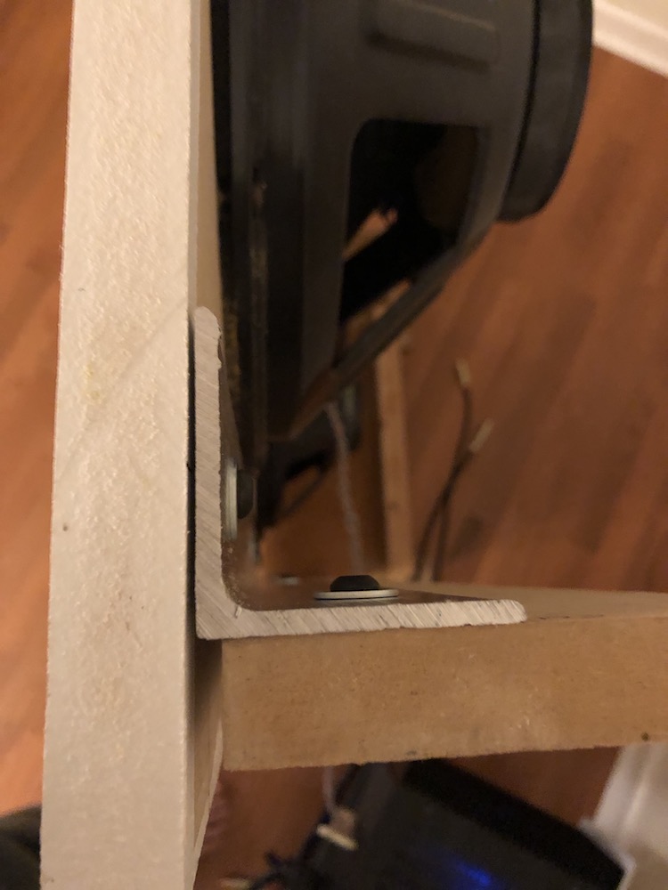

Baffle width is 22.25 inches, and may reduce it to 21.25. I thought I could get away with it (WAF), being that my current speakers are 19"w x 49"h x 9"d, but the cloth grill is only 14"w and the rounded edges make the old speakers appear MUCH less imposing.
Right now I have mock-ups and will most likely use some oak I picked up on clearance a few years ago. The easiest thing to do would be to make 5.5" wings. If I get ambitious, I may make the sides start at 2" at the top then widen at the base to 5.5", or more oak scrap, glue and clamps to give up to 12" at the base. Base will most likely be an oak stair / step plank cut down to the width of the front baffle.

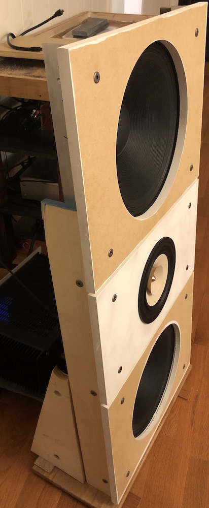

Here are a few photo's of approximations of what I have in mind.
First, a view from the top. I have the baffle isolated from the aluminum frame with buna washers. Don't know if it would help, hinder, or make no difference.
Next is if I go with a sloping wing, I don't know enough if this would decrease the sensitivity of the lower woofer while lowering the frequency. It's not deep like descriptions of U baffles I've read of.
Last is similar if I go with simple wings on the side with a depth of 5.5" + 0.25" for the spacing between the baffle and wings.

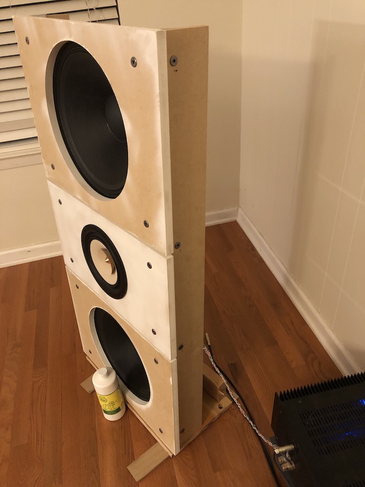

That bottle near the woofer is a bottle of bitter apple dog deterrent which he respects. I have a two year old that is curious enough to destroy the drivers, so a grill of some sort may be needed for the full range. He can hear things I can't, and is very inquisitive with his nose. His paws are strong enough to take down a deer, so not much to do if he decides a punch is needed to investigate.
It took some time and back pain to get all the holes drilled. Maybe it will make it easier to swap out individual baffles, but going with a single baffle would have involved much less labor. I'll try some dampening on the back as suggested eventually.

Jeffs.... thanks for posting pictures and approximate dimensional info. One thing about the design is the asymmetry of the woofer baffles in terms of path difference. The bottom woofer, as pictured, has a path difference of around 15"-16". This provides an F= of about 144 Hz. However, the top woofer path length is shorter at around 10"-12". This results in an F= around 195 Hz.
This difference needs to be included in the crossover design because the woofers will exhibit a different frequency response characteristic.
In other words, each woofer will have to be corrected differently to yield a flat response. A dicey situation. We need them to sing together.
Lets assume we target the system to play flat to around 50 Hz. We have to correct the bottom woofer by around 8-9 db. The top woofer however, will require 10-12 db. The top woofer will be 3 db less efficient acoustically.
So we need to increase the top woofer path to match the bottom woofer with a 5" wing across the top (rear of baffle).
Once the two woofers are roughly equal path wise, we need to work out the woofer pair low pass crossover component(s). Which gets to the next question, how low do you need your system to play before it starts to roll off?
I'll be going with 3.75" deep "wings", rearward facing ends of the wings will be rounded over.
I'm not sure what "path" means but have some guesses. To use what I have on hand, is 7" good? Suggestion was 5", but am guessing that was a minimal figure.

I built the following open baffle speaker.
<image.jpg>
<image.jpg>
Using the following components:
Tweeter
Dayton Audio PT2C-8 Planar Tweeter
Mid-Range
Tang Band W8-1808 8" Neodymium Full Range Driver
Bass Woofer (2 bass drivers for each speaker)
Eminence Beta-15A 15" Driver
