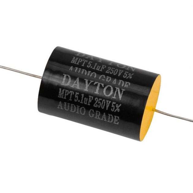

For smaller values i use cheap dayton crossover capacitors. These pp work great for me. Plenty to choose from. Just an example.
https://www.parts-express.com/Dayton-Audio-DMPC-5.1-5.1uF-250V-Polypropylene-Capacitor-027-423

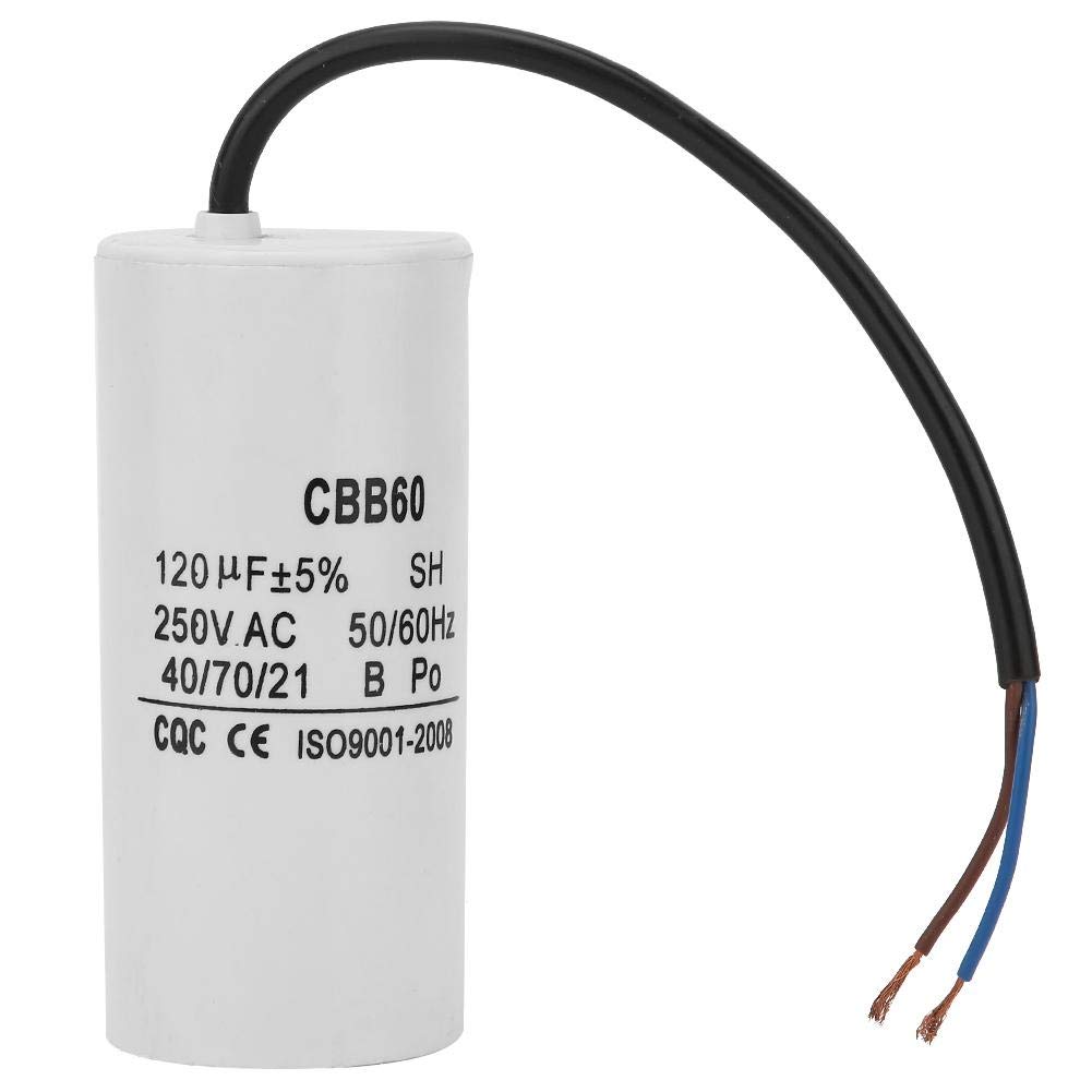

I'm using simulators and I know the value of the capacitor I need lol, the problem is finding the ideal capacitor, today I went to several stores in my city asking about it and they only told me about the PP capacitor. And in one of these stores they showed me a capacitor saying it was PP but for audio I think it would be unfeasible.Yes. If you ask the question you will receive many questions in return, and they may not have answers.

The first one would be hopeless for audio, but it's 120 microfarads: where would you use that anyway? I think it's for a flourescent tube fitting.

The Dayton would be fine for most purposes; note that Dayton has two types "DMPC" (basic) and "PMPC" (a bit better, for about 20% more money)
