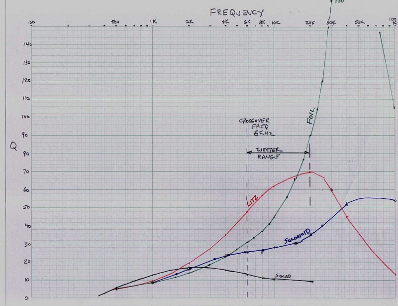

Don't put Litzes on tweeters. The capacitance of the multi-strand can actually be detrimental in higher frequencies. I actually favor Litz/solid on woofers to any cored type.
I don’t think those frequencies are in the audio band, just like the technical benefits of using foil inductors does not exist in the audio band.
See this chart below comparing the Q of various types of inductors, all 14AWG and of the same total inductance:
A lower Q indicates greater losses in the filter response and conversely, a higher Q corresponds to less losses.
For filter target frequencies between 1.6K-40KHz, litz wire is the higher Q inductor material. Below 1.6KHz, solid core wire edges the rest out.

FWIW, I've been responding here but my posts aren't showing up because I'm a newbie. Your Q chart is very interesting Brinkman, especially given the 1.8 khz crossover point of the drivers. I'm not that knowledgeable on some of these finer points, but I wonder how general those plots are? In other words, could the best foil have a more satisfactory Q curve than a mediocre litz coil? And as wolf teeth mentioned, I also am concerned about the capacitance resulting from all that dialectric, though I may be really misunderstanding. I had a set of Litz speaker cables when I first set up the Aegir, and it was an absolute no-go, the amp went into protection mode no matter what I tried. Other cables, no problem. My only wild guess at the time was the higher capacitance of those cables was freaking the amp out. They worked like a charm on my previous 100w AB amp, which was cooler in sound and pretty high contrast, and the 16 core Litz wire warmed it up. I figured it was all about capacitance, and attenuating something in the higher frequencies. I'm still learning, so I have to go with the best conclusions I have!
The above attached chart is for a three-way horn speaker where (as noted on the plot) the mid-horn crosses to the tweeter horn at 6kHz where, as can be seen on the chart, the Q of the litz construction inductor is much greater than of the other type constructions. For a crossover at 1.8kHz I don’t think the technical benefits warrant changing out inductors. I personally think foil inductors would be a step in the wrong direction however. Other types of HF drivers, such as compression drivers typically require various forms of EQ correction in the crossover and on those occasions where the center frequency for the EQ may benefit from the increased Q a litz type inductor might require.

That's enough to scare me off of Litz coils for my tweeter board. I think some of the issues about foil stated in the North Creek article have been remedied, and the Mundorfs look like great quality. How can air reach the copper when it's encapsulated in dialectric material? And they aren't using elves to wind the foil, I'm guessing that in the last 15 years they've paid some attention to the weak areas of production. But I don't build speakers for a living, and know enough to make some bad things happen to my system. My original thought was that I'd have a better result with foil inductors in the tweeter board, but maybe just a higher quality solid core is about as good as it's gonna get? I just don't want to give up on the foil idea, higher Q in the upper range and stability are two things worth investigating.

The parasitic capacitance of an inductor is electrically in parallel with the inductance; you could look at it as a parallel resonant circuit.
First you would measure the inductance (L) of your coil at the standard 1kHz.
Two different ways to find the resonant frequency (Fs):
1) impedance vs frequency sweep of the inductor. the point of highest impedance is your Fs. Or,
2) frequency sweep of the inductor with a series resistor. Attach a volt meter across the inductor and the frequency at which the voltage across the inductor is at a minimum is your Fs.
[DATS can do method 1 above but the hi-frequency limit is 20KHz so only within the audio band]
Since the formula for a self-resonant frequency is:
Freqency self-resonance = 1/(2pi(sq rootL*C))
and you know the L (measured above) and you know the frequency (measured using method 1 or 2 above), you can rearrange the equation to solve for the C, the parasitic capacitance:
C = 1/(L(2pi*Fsr)^2)
What you will find is that the Fsr is well outside of the audio range. In fact, Al Klappenberger (who produced the graph I posted above) has said as much and given his extensive background in microwave filter design (RF work) I wouldn’t try wasting my time trying to prove otherwise.
