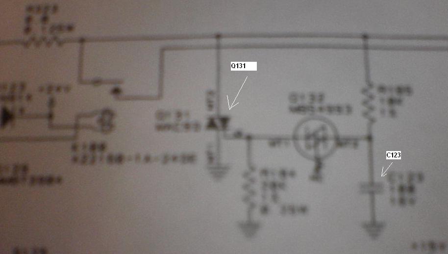

I have a Crown CE 2000 power amplifier with a problem. It goes in and out of protection in both channels with a load connected. With the load disconnected the amp stays out of protection. The load has been checked with an impedance meter and is not the fault.
Any ideas before I rip and tear?
Hi burnedfingers,
Have you checked for oscillation? I'm guessing you have ruled out DC offset.
-Chris

Thanks for the reply. Yes, I checked the Dc offset and it was normal. I'm not thrilled with Crown amps so you could say I'm trying to get my confidence up to look at it. Can't run a signal thru it because the relays keep going out. Haven't ruled out oscillation as of yet. Heatsinks are cool so that would probably be a positive.

Hang a 'scope on the output before the relay. Watch for oscillation. You may even find that the protection circuit is defective (caps). If this is the case, the supply bypass caps would be good to look at.
-Chris

I found the problem.
Unfortunately it is a surface mount part and I don't have the equipment to change it so off to Crown it goes.

Sorry to bump an old thread but I am having the same problem with a Crown ce 1000. It also has the parts highlighted in the thumbnail on the first page.
