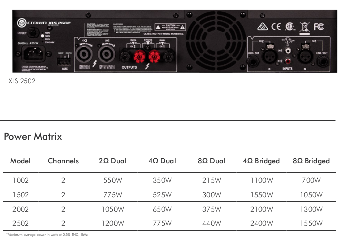

XLS 2502 | Crown Audio - Professional Power Amplifiers
1200W per Channel into 2R. 2400W bridged into 4R

Check with the dealer. AFAIK such products rely on the phase of one channel being inverted wrt the other and another inversion at the output when operated in stereo. The idea is that low frequency music is generally in phase and you avoid or reduce power supply pumping. It's a thing with Class D. Bridge operation avoids the problem entirely.

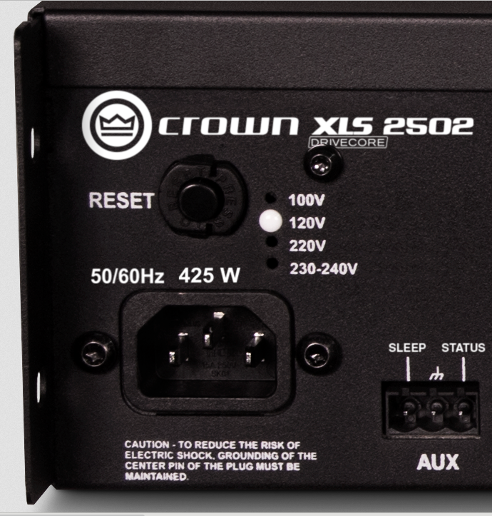

Not sure what happens when she discovers his claimed 2400W stack is only worth 425W.
