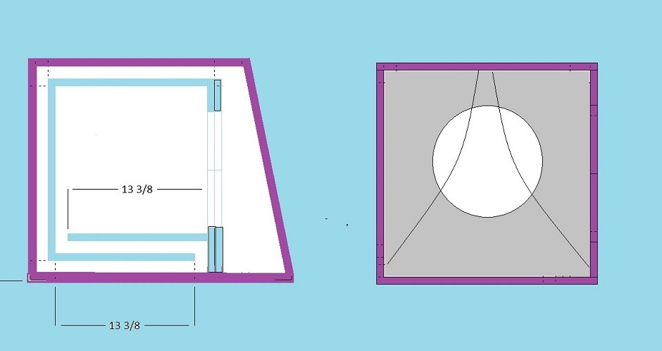

A little tilt and triangular aperture to the front chamber and - K-ish - (probably chuffyish too)
Now nick named the Karlson Infra, all the swag of a Cubo Infra, with all the benefits of a Karlson.

This is really cool! I have a hacked up ugly version with a square aperture that’s not even of Carlson worthiness… from leftover junk wood /osb during Covid lockdown boredom/wood acceess… These pictures are inspiring to give it another go now that lockdowns over. It sounds really good and deserves it. Why is basically a mass loaded (dalene step initially) transmission line with the abbreviated rear chamber/exit.Now nick named the Karlson Infra, all the swag of a Cubo Infra, with all the benefits of a Karlson.
Just as low, just as Karlson.
If you get lucky you can swap the location that port entry in the main chamber and fill in the void at the top, which might smooth it over if you look at the simulation.
WoW - I was half joking with regards to your CUBO - but a way to tune low in a K if one desired.
Booger weldz: I loosely based the baffle to front opening angle on the picture below. Having the port enter at the other end of the Karlson slot will likely have worse low end performance. The extra space due to the angling won't increase performance for the infra part, that's for sure. How would you go about it?

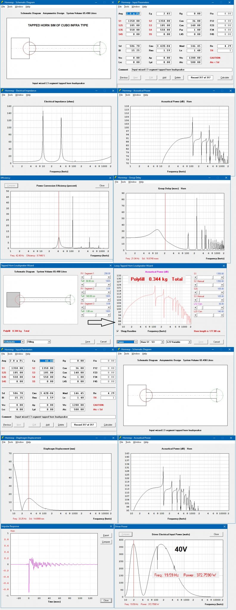

With a port of that length, the impulse response is going to be horrendous. For home cinema rumble and car audio-like one-note farts it might suit your needs, but you should never, ever consider a design like this for music if you have any interest whatsoever in fidelity...
The response is frequency and SPL dependent. Are you sure that SPL for SPL, it is that horrendous? It often is not. In that case, for good fast sound you just HPF it higher when needed.

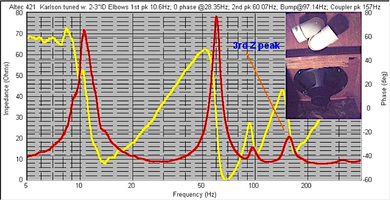

IMO the original Karlson (aka "K15") is an excellent sounding cabinet when used with appropriate drivers. Its tuning is around 48Hz or so with the 260 sq.cm port shown in the 1954 plan above. The front shelf does some correction - shift for a dip. To remove the front shelf may deepen the dip unless the front cavity is made more shallow. (which would increase height from 33" to say 36" to maintain low excursion in the 10-120Hz area.
K15 makes a wonderful sounding subwoofer when used like John Tucker did with the "Exemplar" project and low fs Altec 15. This doesn't make much sense to me as it would seem the front chamber would be contributing very little with crossover at 80-100Hz. Perhaps its the linearity and low mass of 515 or 416 which makes it sound "adept" ? The Exemplar mod needs no modification to existing K15 whose port width is 3.5"-4.5" as is accomplished with two right-angle pvc elbow. Boost is applied like that for 6th order reflex at ~30Hz. A 15" Eminence/Dayton 295-070 in 6th order reflex measured close to my K15/Altec but sounded crude in comparison.

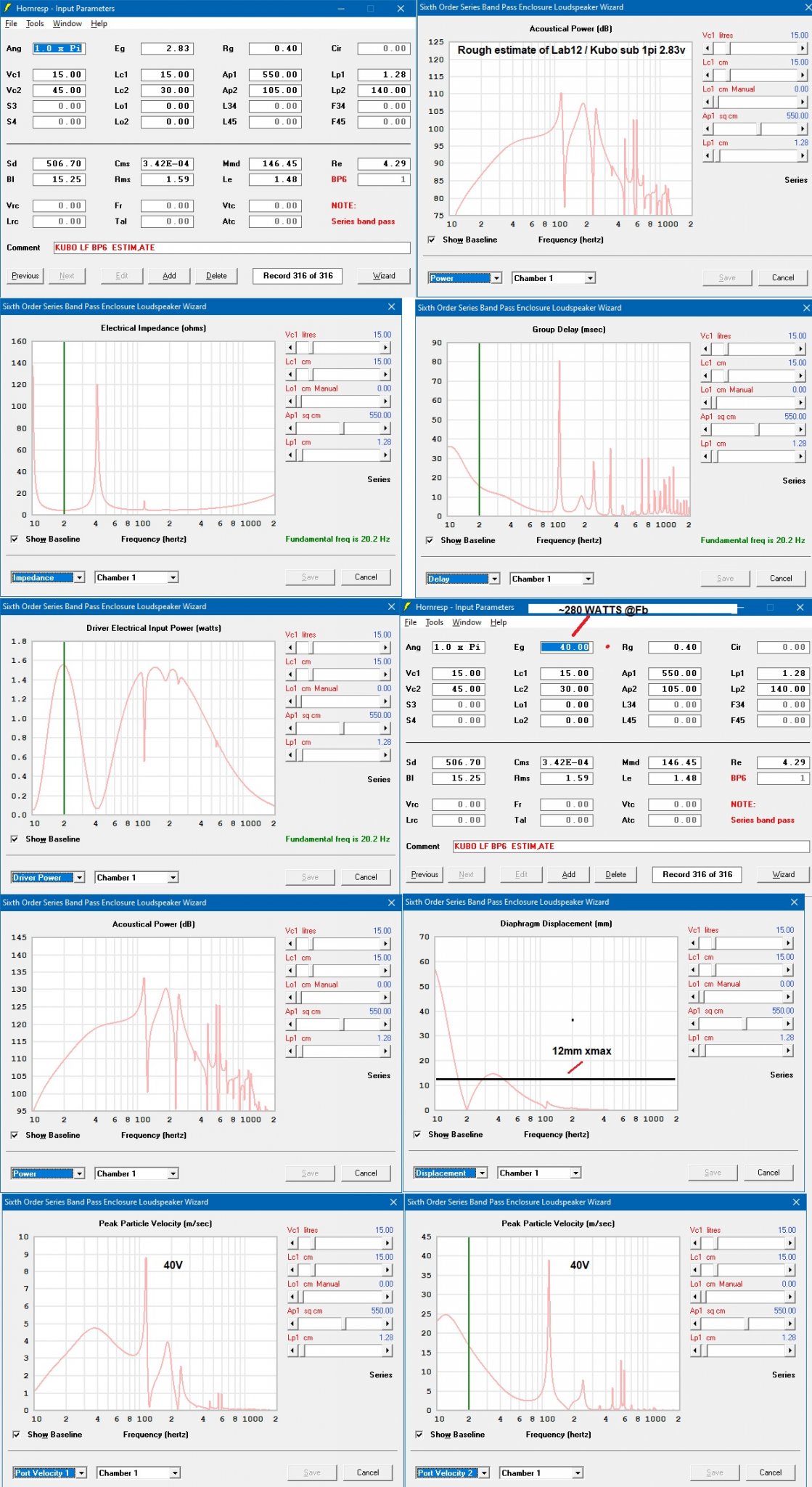

@CUBO - I'm too stupid to make out the width and approximate chamber volume of your Infrasub but did do a rough guess as a BP6. There's probably another way to enter it into hornresp so impulse can be calculated.
I don't have skills to figure out much and would like to do a little Karlson 2-way of merit - I've apnea - reflux - heart failure - diabetes - cancer - obesity and old age working against time plus stay with my son who can't tolerate the clutter of my audio toys.
