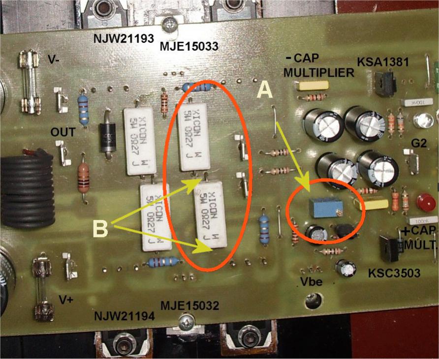

white square things are the emitter resistors from the outputs to the speaker. When the large output transistors are biased correctly... 15mv- .015/.22 = 68ma per device. do not replace these with a trimmer. The trimmer should be the only control close to the big output transistor/ emitter resistors , it is 1/2w (small power) but critical to the thermal stability of the amp.
If you have it working now , be thankful. With it's advanced age , you are lucky it has a protection circuit .... between the bad caps and old trimmers , it could go up in smoke at any time. 😱 I build PC's, too. My PC knowledge compliments my amp knowledge. Actually , a switching power supply in a PC is 10 X more sophisticated than these kenwood amps. But if you just "swap" PS's , that's a different story. I only bother with repair of 700-1KW PC supplies ... all the rest - to the garbage. 😀
(Below 1) is a basic amp like the kenwood . "B" is the emitter resistor and should have 10-20mV across it. "A" is one of those precision trimmers , clockwise makes the mV go up , counter clockwise makes it go down.

Mucking about with trimmer pots for bias current may end up in dead output transistors, as in most cases extreme settings are really extreme - one is zero bias (lots of distortion), the other is WAY too much bias = too much heat and dead transistors.
STOP twiddling those pots without knowing exactly what you are doing or your curbside find may well end up on the curbside again, in even worse shape. Honestly, i really don't understand where people get ideas that if it can be adjusted, it should, without the faintest on what is adjusted and shy. Would you open up the engine bay of your car and randomly screw or unscrew bolts and screws just because you can obviously do that?!

On the simples tlevel, let me ask you this: if you wiggle pots around and it ends up in smoke, what will you learn, assuming learning was the idea? Maybe, that it's not a good idea to mess around with pots, which is what i said. There is a chance you had to deal witha woefully incompetent tech so some adjustment may cure the problem, but if that person knows 50% of what they are doing, what makes you think going in blindly with meaybe 10% of that knowledge will result in you doing a better job? You asked about it, and i answered honestly - to be blunt, pots do not misadjust on their own (i.e. gnomes did not get in there over night and played with them, although an incompetent tech may well do it), unless they get damaged or corroded (in which case they are best replaced and then adjusted) - do you know how to recognise this?
I should also mention that often it is written on the PCB what the pots do. And, some settings are destructive (although not necesairly immediately so). Oh, and some CAN end up in your house burning down, and, obviously, poking around inside can cause electrocution, which is why it says on the back panel 'no user serviceable parts inside'. So, believe me, the analogy holds - I can tell you that from a lifetime of servicing and designing electronic equipment, including certifying it so ut may actually be sold to people. Some of this experience is way too many repairs of other people's 'repairs' or users fiddling around blindly with anything that fits a screwdriver. I will gladly admit that reading about it touches a nerve or two.
