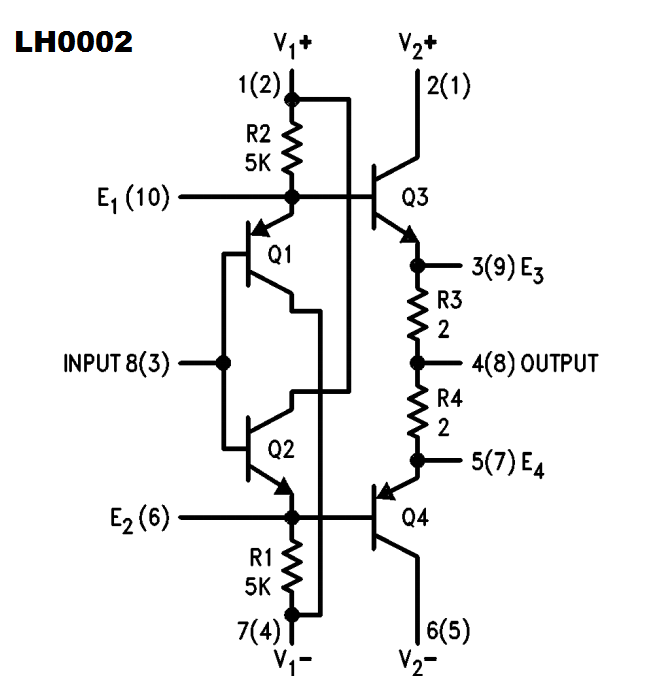

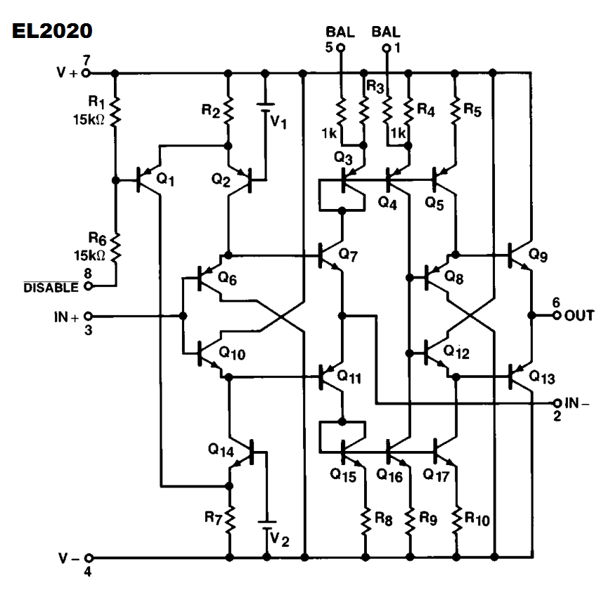

Why not name it after its most famous implementation?
We call the circuit in Figure 1 "the LH0002 buffer" after the NSC product.
Instead of "current feedback amplifier" why not call cicuits like Figure 2 "EL2020 type amps" after the Elantec product? I looked at a bunch of Comlinear datasheets but they don't have internal schematics.
_
_
It so far predates Comlinear this is a waste of time. The current feedback name was applied to some amplifiers that had some uniquely different properties, time for people to let go of this.
EDIT - @Waly those skilled in the art design circuits to achieve desired results and generally know all this stuff and mix and match topologies to get what they want. I'm not sure where this controversy arose but I think it was from folks with narrow ultra-academic ways at looking at these things, i.e. why do they care?
I shudder to think of the results, how droll, 100's of millions of $ of ADSL drivers shipped of so called CFA's oh the poor duped customers.
No, it arose from those calling the CFA the best thing from sliced bread, when it comes to audio reproduction. And from those claiming that the CFA is some sort of secret sauce to audio performance. And from those believing a "CFA" somehow allows more loop gain to linearize an amplifier with a certain GBW (without any stability margins penalty).
BTW, because somebody else mentioned single ended CFAs, the Curl standard topology is exactly a "CFA" and can be analyzed as such. Just an example of yet another "CFA" topology, that AFAIK not even the author ever officially mentioned it as such (although he could rightfully do so), too bad the audio review chimps were at the time not overly excited about "CFAs".
