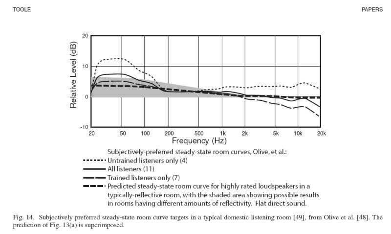

Does anyone know what the current / definitive Harman room curve is? I've seen numerous variations around. Some folks say a curve from a given low freq. right to 20k, others say flat to a mid freq. then curve down to 20k. It would be nice to know the real deal.
I don't think it is "one curve that rules them all"...
From my own experience, I've adjusted my speakers to my liking (by starting with some known curves, like B&K, another curve from Bob Katz and some different curves from JBL I came across). In the long run, I kept adjusting what I had over a long period of time. After quite a while of adjusting and zooming in on my own preferred curve I came across this particular group of curves as presented by Toole from their research on the subject:
Low and behold, the curve I ended up with by myself had a more than remarkable likeness to the "Trained Listeners" curve as presented in that graph.
It may not be an exact fit, but it's closer to my own "curve over time" than any of the other curves that I had seen. So now, whenever I (have to) start over, I just start with that curve (trained listeners) and I may tweak a few little things to make it all fall into place.

So this may not be the 'end of all curves' from JBL, but it does clearly show not all of us prefer the same things. By only looking at these results it becomes obvious there is definitely room for your own taste to play a role too.
It could depend on more than one factor, the speakers you use, or the room they are in but also personal preference... Take it as a starting point and go from there would be my advise.
