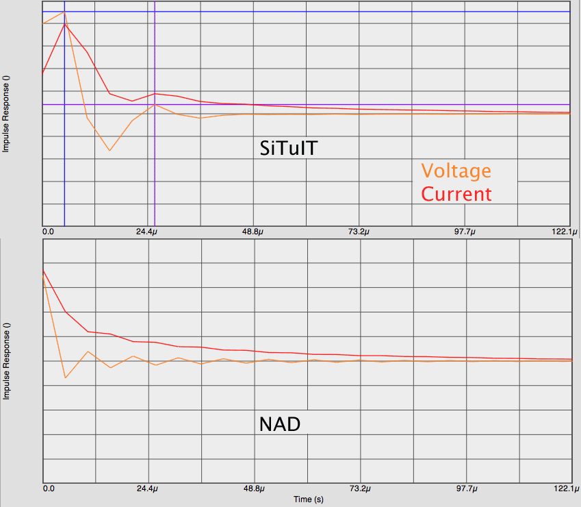

Correct me if I'm wrong, but isn't it the current through the voice-coil that makes the sound? So, why are we always measuring voltages on the output of amps? To makes things worse, most of the time a purely resistive dummy load is used for these measurements.
To see what happens current wise I used a 0.1 ohm 'current sense' resistor to measure the current. Three channels were captured and used for analysis: input voltage, output voltage and output current. A dual FFT analyzer was used for the analysis. Sampling rate was 192KHz, FFT size 768000, pseudo-random noise excitation, rectangular window.
Two amps were used for the measurements, my single ended tube amp and a NAD C320 solid state amp. The load was a Fostex208S in a Replikon BLH/BVR enclosure.
The graph shows the impulse response (voltage and current) for both amps. I'm definitely operating at the limit of what is possible with this setup, we're looking at individual samples 5 microseconds apart, but I think the result is still interesting.
My interpretation (open for discussion):
The back EMF from the driver is more pronounced in case of the tube amp and also reflected more in the current response. The graph for the NAD shows feedback in action, the amp is working like mad to get the voltage down.

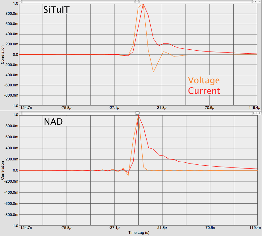

The next one is perhaps even more interesting: input output cross-correlation. I must admit that I'm still not clear on how to interpret the results, but one thing is certain: Voltage and current each show a different picture. Looking at the voltage cross-correlation I would say that the NAD looks much better. For the current the picture is less clear, I think the tube amp has the advantage here (look at how the tail decays).

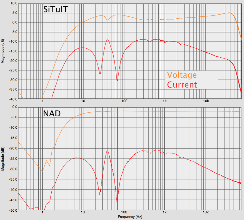

I'm familiar with the work by Klippel, it's one of the things that prompted me to start this investigation.
The difference in output impedance between the two amps can be clearly seen in the amplitude response for the output voltage. The current response shows the impedance of the loudspeaker, with the inclusion of some nasty peaks.
It is my intention to take a closer look at distortion products in the current at several frequencies to see how the amps cope with the peaks in the impedance plot of the loudspeaker.

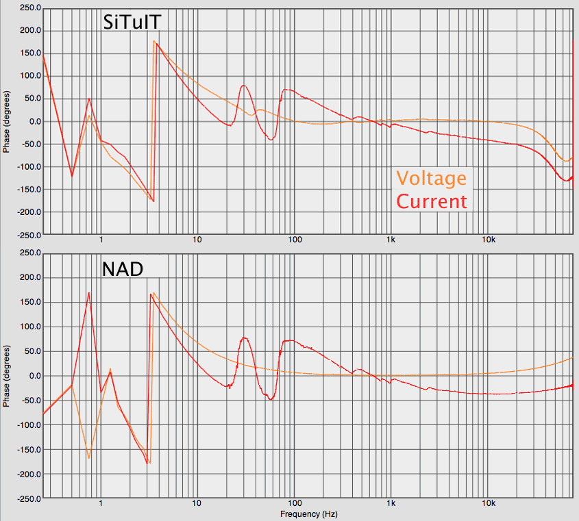

Attached is the phase response for current and voltage. Notice that there are just four points where voltage and current are in phase.

Voltage/current differences observed at the amplifier output relate to amplifier output impedance characteristics and whether any form of feedback or error correction are applied; also to the nature of the loudspeaker load connected.
Re Post#1 traces.

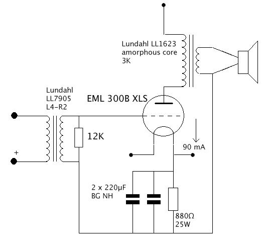

I would really need to see circuit diagrams for both amplifiers to help me attempt to interpret what the amplifiers are doing, especially whether any form of feedback/correction is applied, whether the phase angle of any NFB damping is coherent throughout audio frequencies, also the nature of passive output impedance.
The SiTuIT control is clearly more 'relaxed' when compared to the NAD and shows different settlement characteristics which, although both are supersonic and above what we can hear via the LS, still cannot fail to impact upon reproduction because the deviations are in series with necessary on-going electrical corrections arising within the amplifier circuit.
A voltage alternation about the zero voltage line has much more significance with a SS NFB amplifier if this has a class-AB output stage due to current conduction repeatedly crossing over between output halves as the error voltage is 'actively' minimised.
These responses would be quite different if the loudspeaker were multi-driver with crossover. Co-connected circuits generate separate but coincidental back-EMFs which simultaneously interact with respect to the amplifier's attempt to generate an undistorted copy of the input voltage waveform.

Interesting suggestion, I can do that. I just need some more cabling, my audio interface has plenty of channels and the analyzer software can also handle lot of channels simultaneously.If you have two identical output stages and connect one to a resistor and one to a loudspeaker, then have a sensing channel connected between the two outputs, you could observe any effect upon amplifier drive caused by the reactive loading alone.
As far as I know the NAD is a class A/B amp with lots of feedback, my tube amp has no feedback. I attached the schematic, it is as simple a can be. The amplification is 0.5, hence the name: Single Tube Impedance Transformer.Voltage/current differences observed at the amplifier output relate to amplifier output impedance characteristics and whether any form of feedback or error correction are applied; also to the nature of the loudspeaker load connected.
Nice term, relaxed. Although the tube amp is a bit slower due to the bandwidth limitations (~50Kz) it looks like it needs fewer oscillations to get to zero. The NAD is faster but it oscillates more.

Another intereting plot is to have the resistor current as input to an 'X' axis and the difference input (between resistor and loudspeaker outputs) to 'Y' axis as if feeding and oscilloscope screen. Will your software do this ?
Reactive loudspeaker induced changes will cause what would be a straight line diagonal trace to loop out along the 'Y' axis wrt 'X'.
However any crossover induced errors will be seen as additional spikes along the 'Y' axis these become shifted away from the zero resistor current axis as the loudspealer currents become phase shifted.
Thus when 'X'-'Y' comparing the resistor-loudspeaker diffence outputs from a class-AB amplifier two sets of spikes might be revealed; one from resistor loading close to the zero current voltage axis, and then another phase shifted and displaced in both amplitude and time by the loudspeaker loading.
Clearly a tube amp would not generate such spikes.

Re the tube amp trace in Post#1. There is some slight ringing. Maybe the output transformer could do with having a Zobel fitted ? Pure guess maybe 2200pF/1000V in series with 470 ohms.
If the heater is DC maybe one 220uF to each side of the heater, or if AC to a heater winding centre tap. Each electrolytic should also be parallel bypassed by say a quality 1uF as well because these components are in series with both input grid and output anode circuits.
Will read the other posts shortly.
Cheers ......... Graham.
Hi Graham,
The software will not do this directly, but maybe I can route the signal through my digital audio workstation and use an M/S matrix to get the sum and difference for two channels. I would need to make sure that the DAW does not mess things up.
As for the ringing, I did not put any capacitor across the input transformer because I could not see any effect while measuring with the Clio system (48 KHz SR). The new measurements indicate that I have to look into this again.
The heating supply is DC, CRC filtered followed by a voltage controlled current source (VCCS). The capacitors are Black Gate NH non-polarized types in a 'Super E cap configuration', definitely not standard electrolytic caps.
