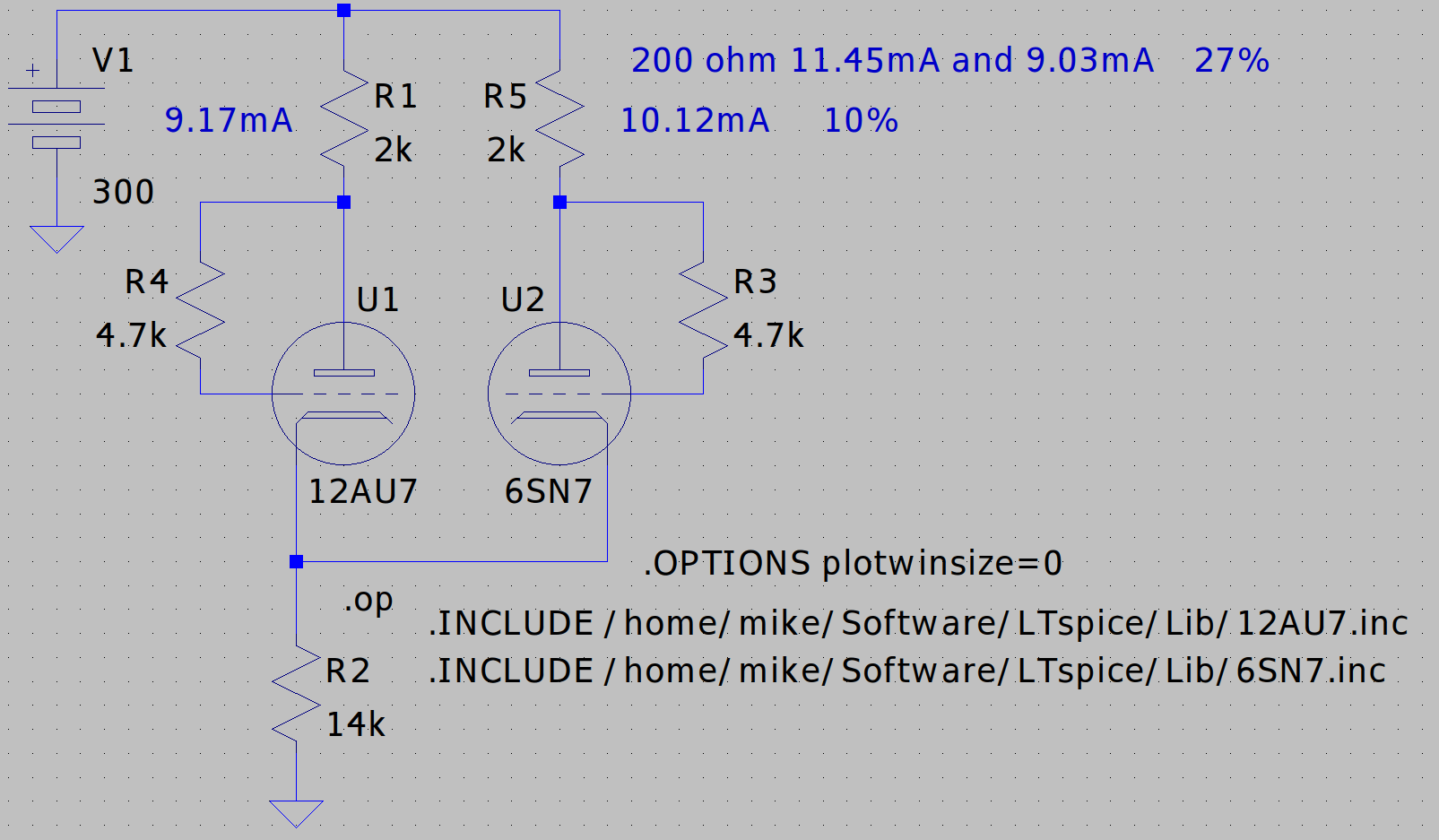

I was thinking about current sharing in parallel damper diodes (or diode wired triodes for that matter). Not being able to find a rule of thumb I decided to crank up LTspice and see what I could see as it were.
To simulate fairly mismatched diodes I used two somewhat similar triodes in the form of 12AU7 and 6SN7. As a first pass I ran a single 12AU7 and divided current by voltage drop and got an effective resistance of 2K. This is no where near the data sheet Rp but I just ran with it. Now with the two "diodes" in parallel with a 2K resistor in each plate I got a 10% current difference v.s. 32% with none (1 ohm) and 27% with 200 ohm resistors.
I suppose the 200 ohm would be "safe" but the 2K seems really solid given that the simulation was with totally different triodes.
Does anyone have a rule of thumb that they use?

Or are you just trying to model 'Parallel Diodes' by using 'Parallel Triodes' that have a resistor from the grids to the plates?
For Damper Diodes, start with the "static" resistance of the diode (data sheet voltage drop/current).
The dynamic impedance may possibly be lower than that static resistance.
Consider those values, when you pick the value of the series resistor in each plate of the damper diodes.
In reality, I've found using 27R or 47R per plate works fine to prevent hogging.
Also, why not tie grid to cathode instead of to plate through 4k7?

In the parenthetical I mention "or diode wired triodes for that matter" as I assume the issues are the same. I used the triodes because it was easier to figure out two similar triodes than two similar diodes in my model database and I was considering using a diode wired 12AU7 as a soft start element in a SS rectified B+.
I tied the grid to the plate as a positive grid should turn it on harder than tying it to the cathode. The resistor is of course there to limit grid current.

You could take the practical approach and test the dc voltage with a known load when just using one 'diode' at a time, then pad in some series resistance to equalise any differences. You may want to confirm that mains voltage doesn't change between measurements.
I did static voltage drop testing on a large batch of 5U4 of unknown history - each diode's drop can certainly change with use, but also the static current can change at different voltage drops, so just balancing on one static measurement may be misleading.
