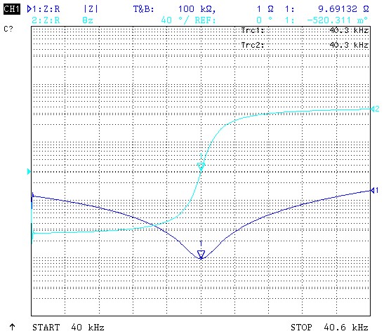

Here's the rub: The "40kHz" machine may not actually run at 40kHz. I measured a commercial record cleaner with 40kHz transducers and it ran at 35kHz. The individual transducers were designed for 40kHz, but none of them had their resonant frequency at 40k (see first plot below). When lumped together in parallel, there was no resonant peak at all, the impedance just dropped with lower frequency (second plot). As far as I could tell, they adjusted the frequency until the power consumption equaled the rated 200W (if I dropped the frequency further, I could get 350W consumption), although power consumed does not equate to sonic power produced. As with any tuned circuit, maximum efficiency is achieved when the generator frequency equals the resonant frequency of the load.
I have the Degritter USRCM and the transducers appear to be hand matched (they all had the exact Fr written on each one and they were all very close). When measured in parallel, there was a definite dip in impedance at 120kHz so the load is well matched to the amplifier driving it. They also sweep the frequency around 120kHz to ensure all 4 xducers are working at max efficiency.
