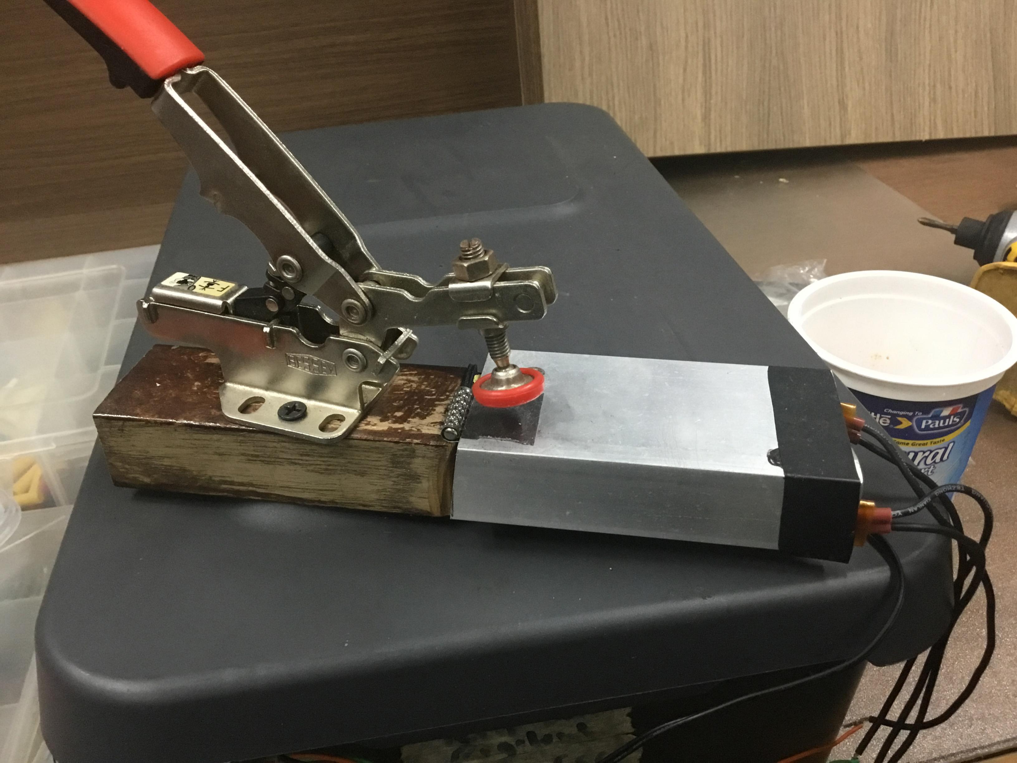

I want to achieve curve traces that are taken at (sufficiently) constant temperature. As it is now, I mount the DUT on a heatsink and then get readings at different voltages and currents, i.e., at different power dissipation. When readings are taken at low power, the DUT will be realtively cooler than when readings are taken at high power. Therefore, depending on the tempco of the DUT, the curves will be affected by the temperature change between low-power and high-power readings.
The temperature drift is avoided with short pulse testing. Howeever, this does not work with common-garden bench-top PSUs as used in my setup.

This looks interesting. How does the temperature control work?
I used a PTC heating element (60 degrees iirc) under a aluminium u channel. Toggle clamp and a bit of graphene on the surface of the Alumiunium below the toggle clamp. This helps make sure that each test is done with the same contact pressure.
Cheap, not very neat, but works very well. The sanity check is to measure the same device again after some time or some days and the curves match perfectly every time so I’m happy.
Thanks! The PTC heaters are clever, but they might be a bit weak for high-power transistors (100 W dissipation or so). The PID controllers are also nice (but more expensive), and will work with heater elements of 1000 W or more 😎
The Ptc heaters are available at multiple voltages and temperatures. If you want higher wattages than available you can double the Ptc heater element (that’s what I did) - makes for a more even temp bed. 200 watt Ptc is available but I think at higher temps.
I only used the jig for power mosfet. Turn on heater and wait till temp settles, clamp mosfet, wait till temp settles (5 mins) then curve trace. The current drawn by the Ptc might also be another nice way to determine when quiescence has been reached...
