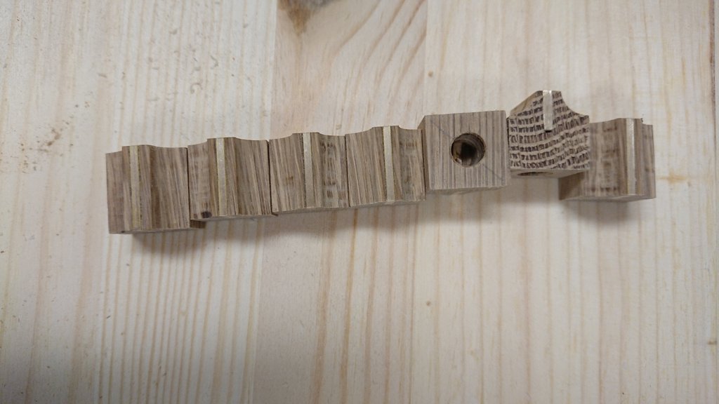

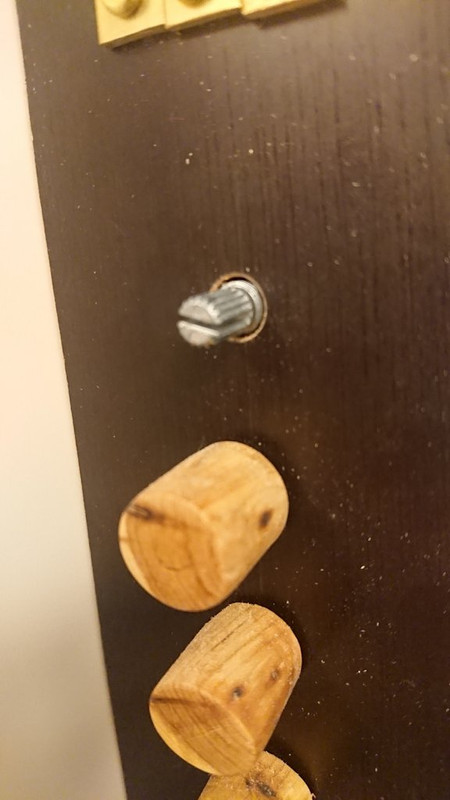

With this little report I want to share how I managed to use almost every object as a poti or fader knob. In fact anything that can be drilled and glued will work. I'm covering only potis with a rippled shaft thoug, as I found them to be most problematic. Knobs for these potis (and faders) work simply by friction and I didn't quite succeed at drilling holes with just the perfect fit (loose enough to be taken on and off while still tight enough to be safely turned). Not all materials would even be suitable for that perfect "friction fit" - wood will wear out while metal is too smooth.
What I came up with is to 3D-print sort of inlays that feature the same ripple pattern as the poti shafts and can be glued into easy to drill holes (say 8mm). The 3D-printed material (PETG in my case) provides good fricition and some flexibility at the same time to allow for a perfect fit. The plastic is not visible from the outside and only serves as an adapter between shaft and knob.

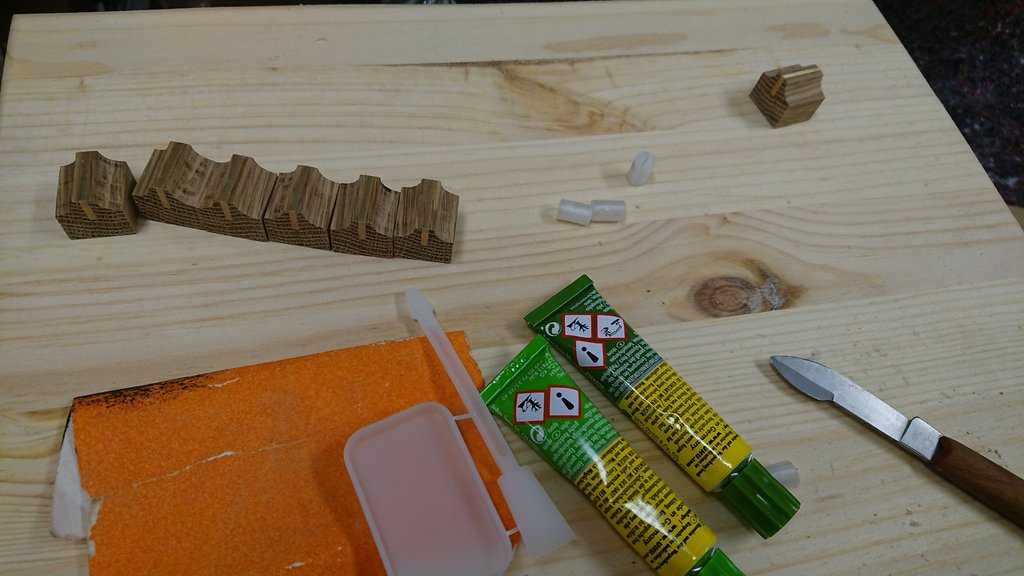

I glue those 3D-printed inlays with 2K epoxy glue into the knobs, which will keep them in place forever and works on almost every material.

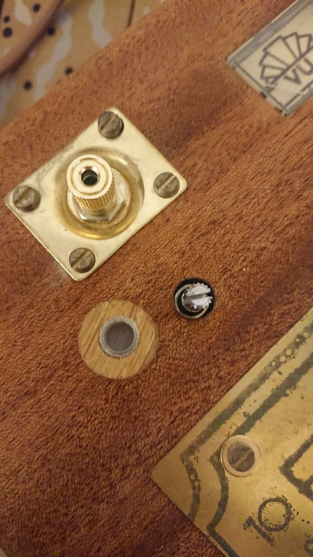

Here's another example for fader knobs made from oak with a brass inlay:
