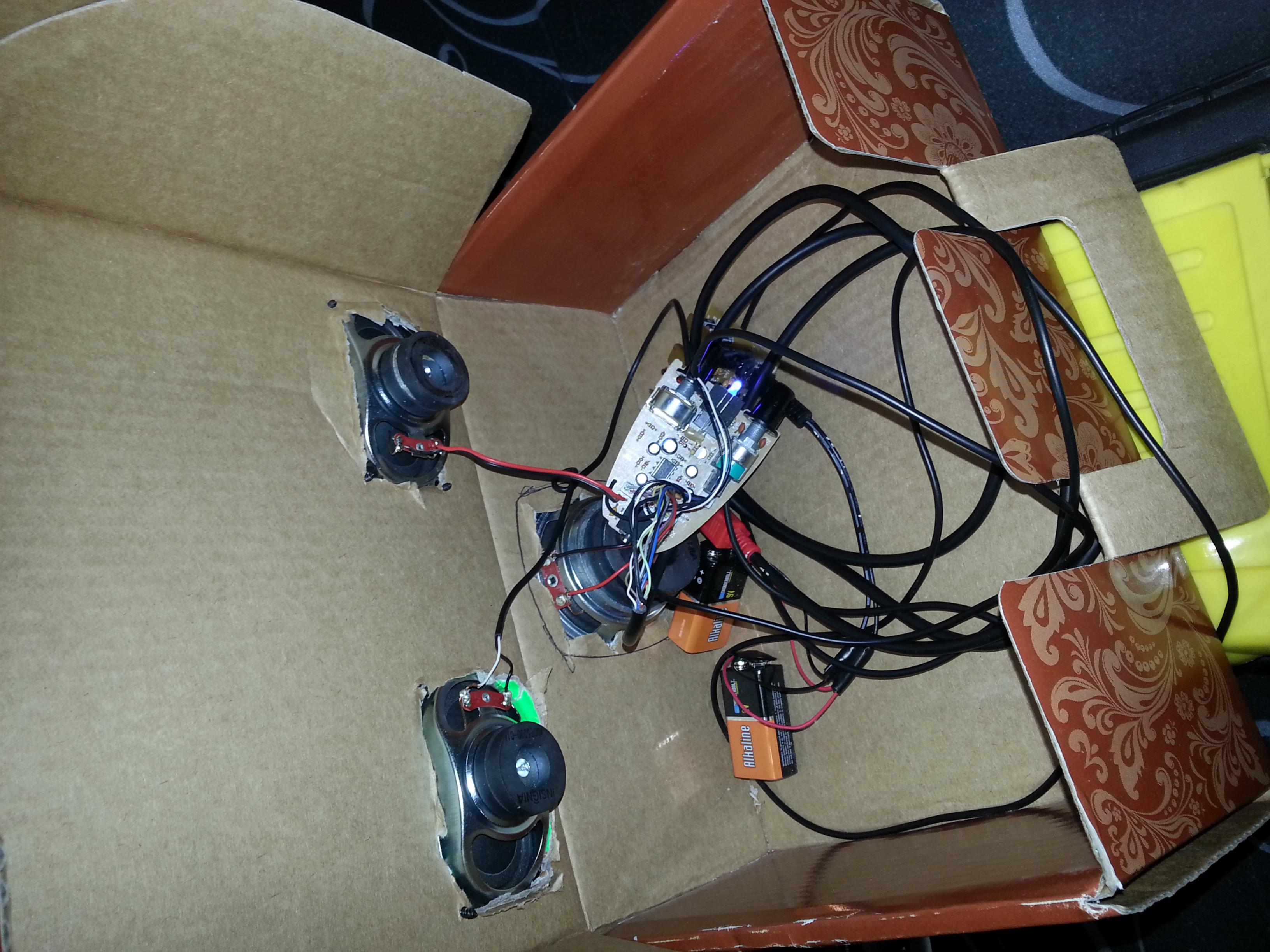

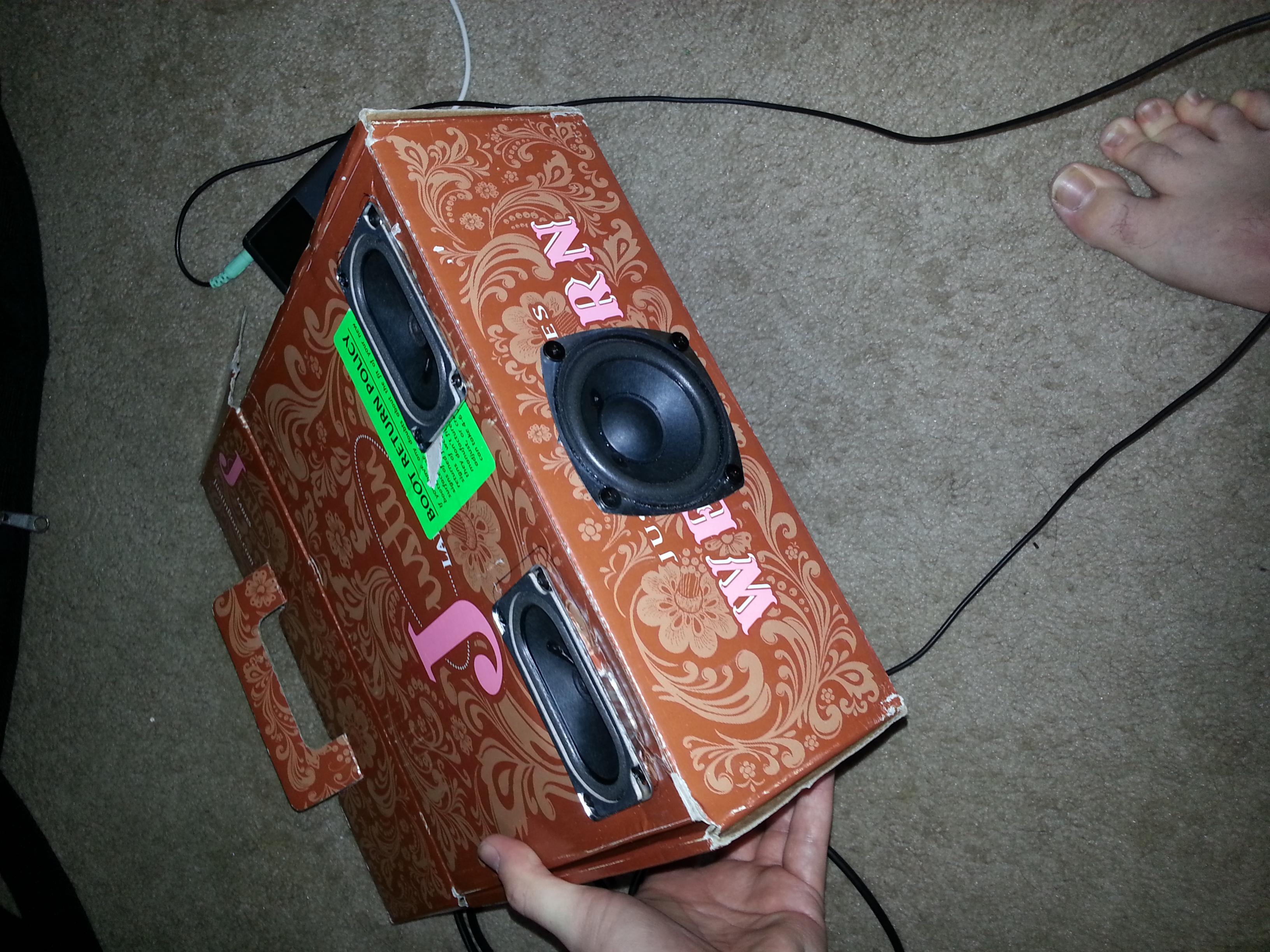

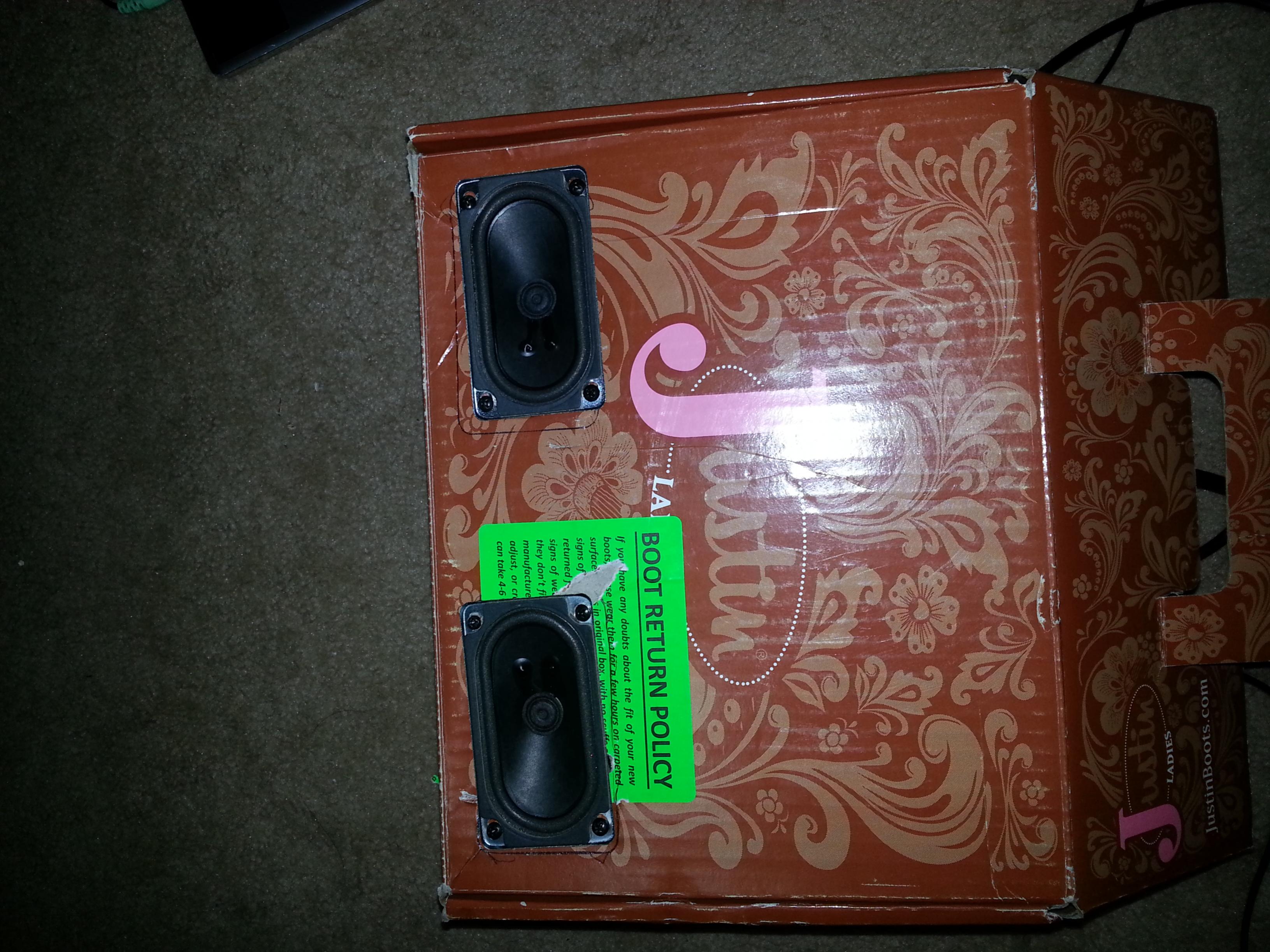

Thanks for the reply, I will have to look into all that tomorrow as it is getting closer to bed. I plan on running them on 2 11.4 volt lipo batteries in parallel and splitting the power to 9v if i keep the current speakers and about 5.5v for the pi and screen and separate usb hub for more ports. I love bass so I wish to keep a sub. I am running normal 9v batteries with my current speakers. Two 9v batteries in parallel give me 6 hrs of run time. It runs around 1000mah. It would be nice to have a better sounding speakers with less power being drained.
Attached are some pictures of the box project.
