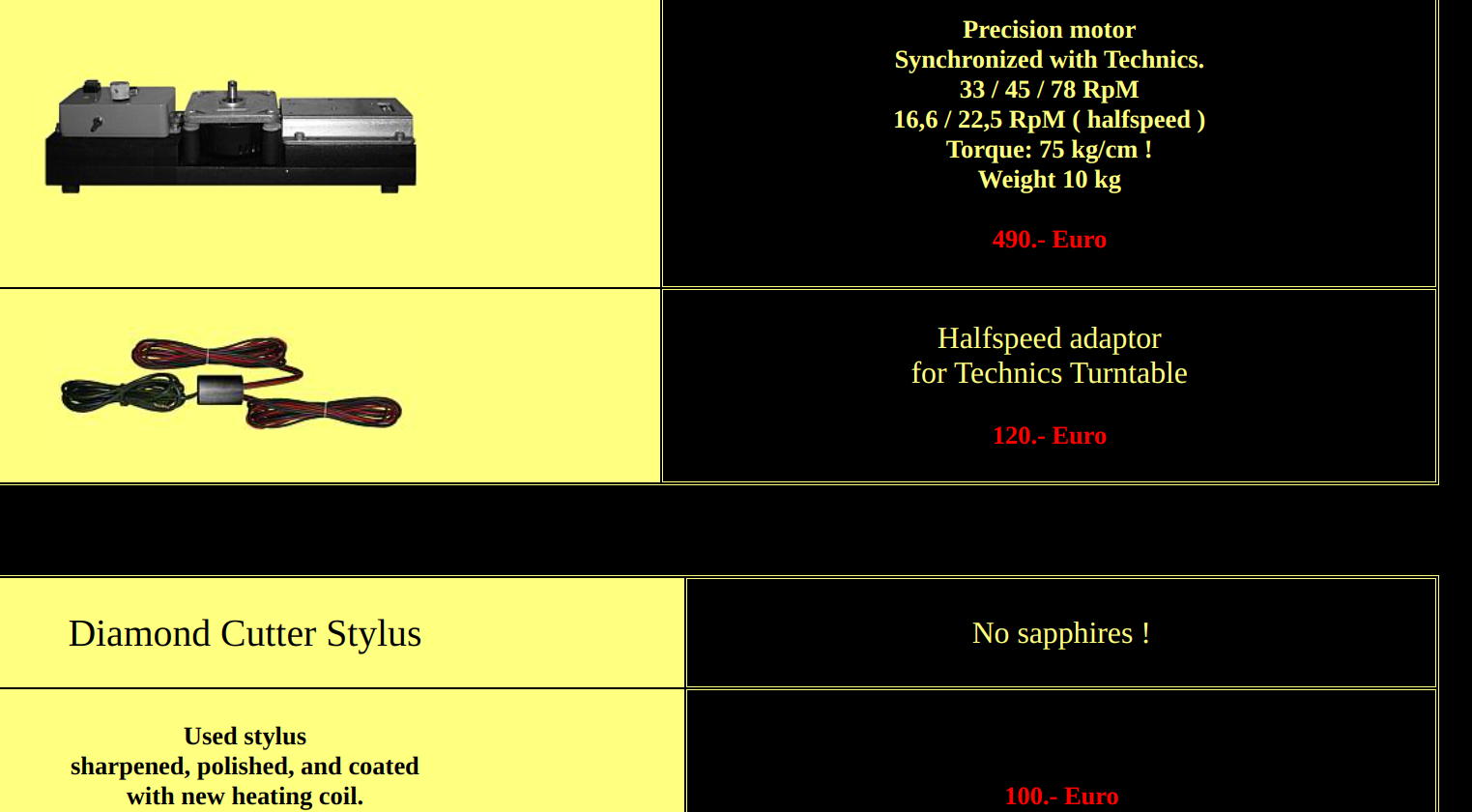

Yes, all that is possible:I still didn't know how long it takes to cut a disc, are they cut half speed?
Precision motor
Synchronized with Technics.
33 / 45 / 78 RpM
16,6 / 22,5 RpM ( halfspeed )
Torque: 75 kg/cm !
Weight 10 kg
