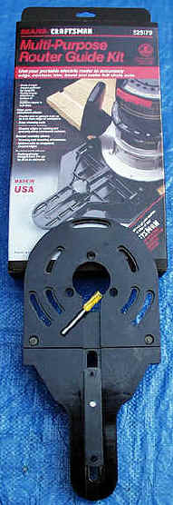

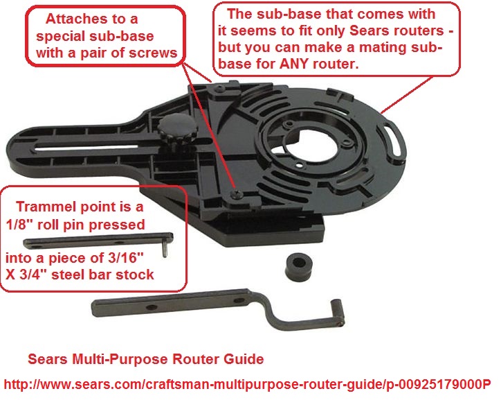

Here's a guy who says the Sears "Multipurpose Router Guide". . . A Jasper and Porter-Cable 690 combination is simple perfection for speaker building.
is as effective as the Jasper, at about half the cost.
http://www.berrysweb.com/router_guide.htm
I tend to agree with him, though the Sears accessory only fits Sears routers.

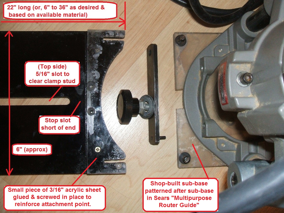

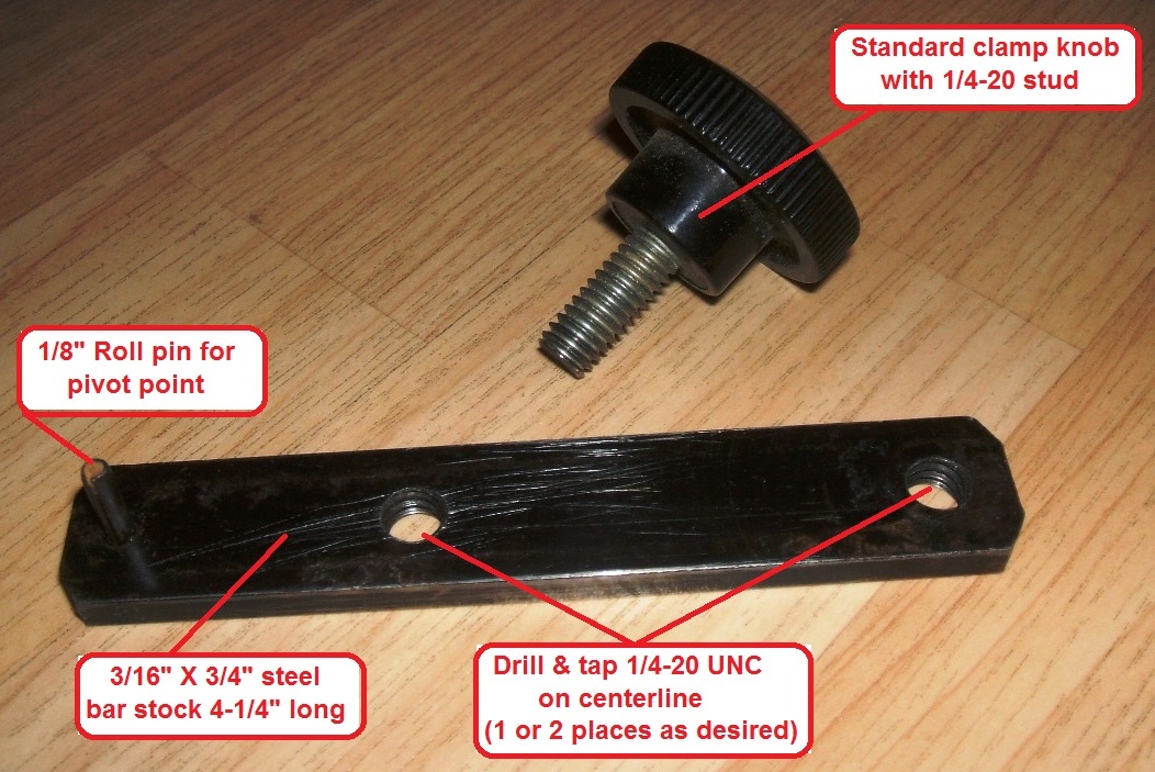

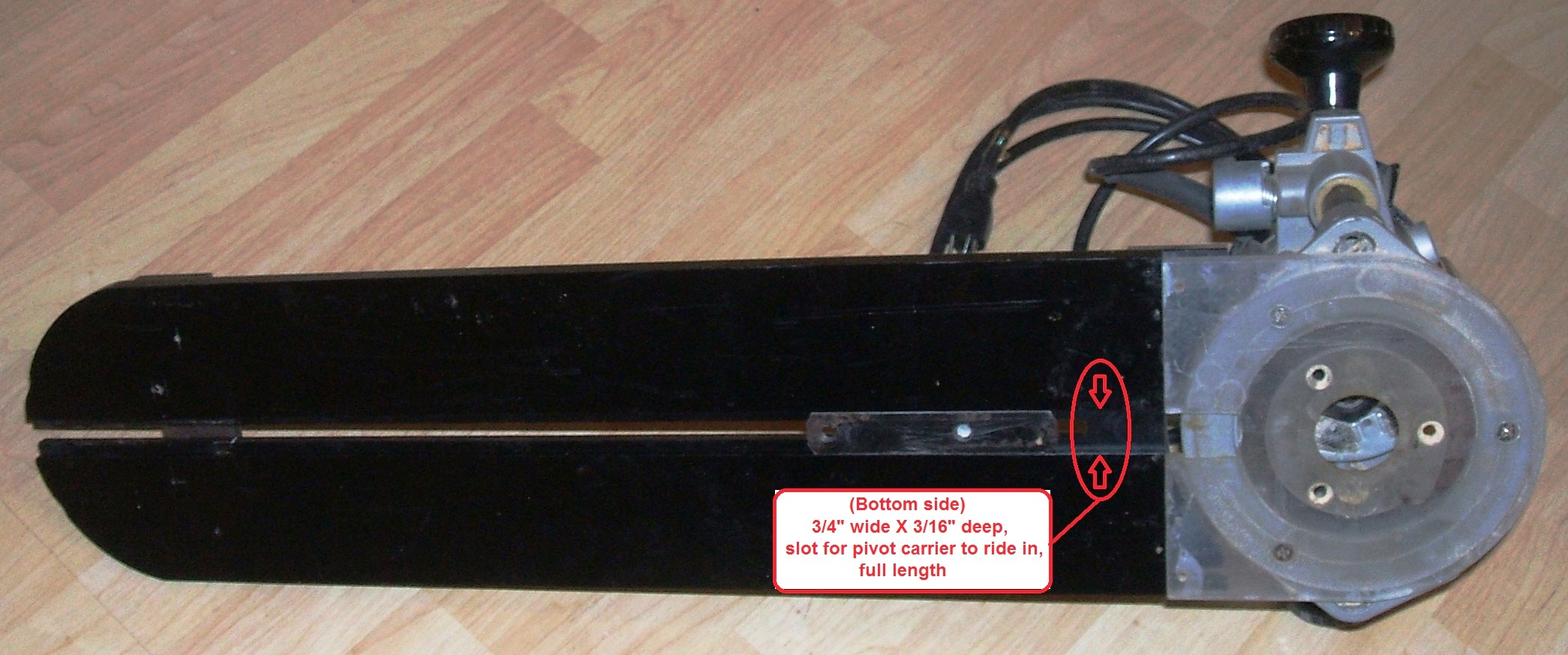

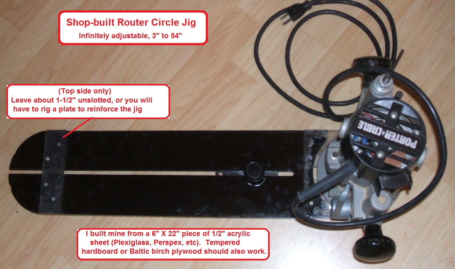

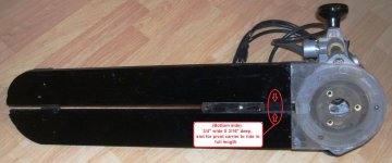

About 35 years ago, my first router (yeah, from Sears) came with one of those "Router Guides". The router is long gone (the only power tool I ever legitimately wore out), but that Router Guide is still quite useful and I have made sub-bases so I could use it with each successive router I have owned over the last 35 years. (Anybody who has used a router for more than 60 days has figured out how to make additional sub-bases for attaching jigs and accessories. I like to make them from acrylic (Plexiglass, Perspex, et al) or polycarbonate (Lexan), but tempered hardboard or common plywood also works.)
The attached photos show my current shop-built circle cutting jig based on the Sears Router Guide. Since it is infinitely adjustable it takes a minute or so with a tape measure - and perhaps a practice cut - to set it up, but that also means you can easily get things like exact width and depth of flush-mount rabbets, beveled or rounded edges, etc.
I think the photos give all the info you need to either duplicate or adapt my design but feel free to post questions.
