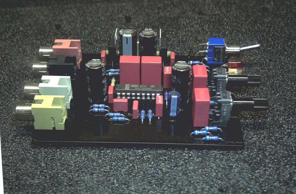

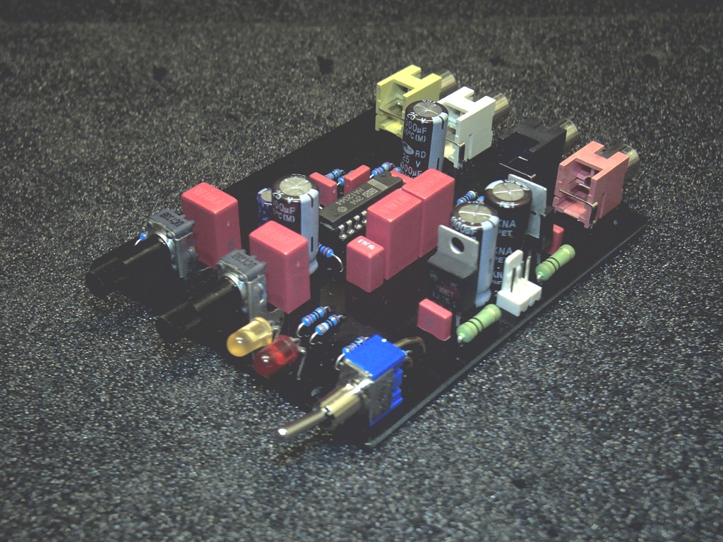

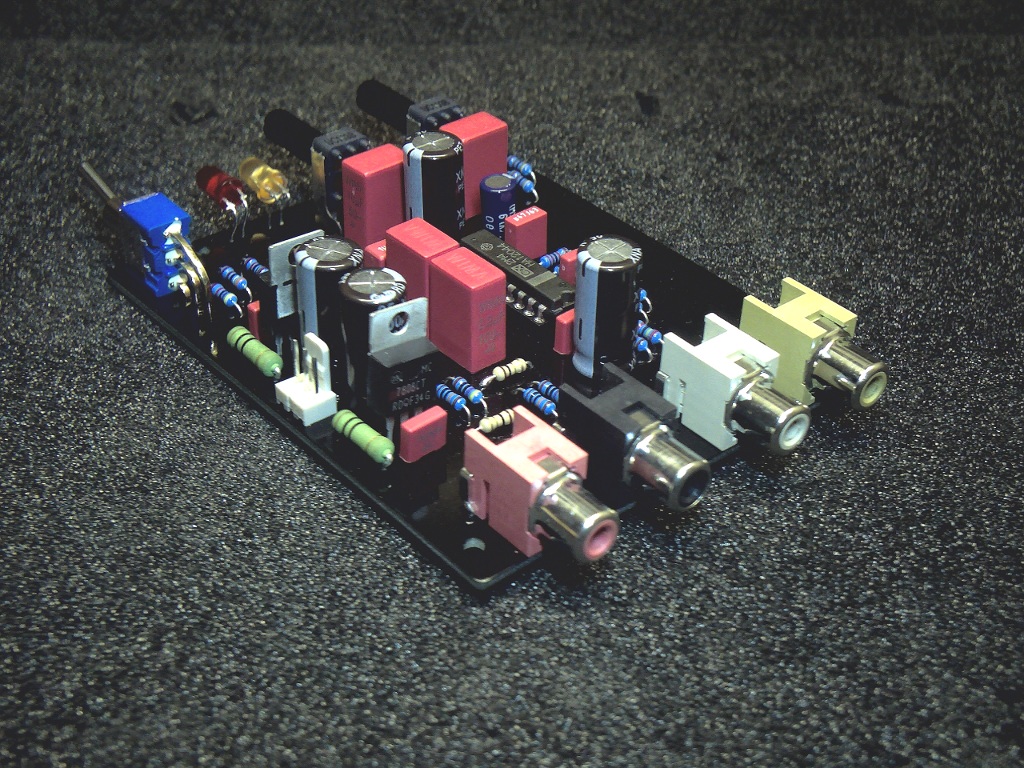

Let me introduce my newest build:
a "CX Expander/Decoder"
Some month ago I leafed through my old electronic magazines and found articles and circuits for a "CX noise reduction system" for vinyl records.
The system was introduced around 1980. It uses specially coded LPs, but those can also be listened to without decoder.
Strangely enough, I can not remember having read about it at the time. So that was new to me and I became curious.

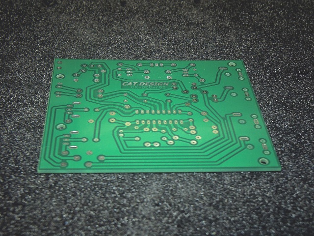

One of the circuits is quite simple by using a special CX-IC from Hitachi: HA12044. This is actually still to get as NOS. So I bought such an IC and made a board design for the circuit.
Today the device has been finished and immediately tested.
It works better than expected.
You hear almost no more running noise from the record; e.g. in empty grooves between music pieces.
With the cx-records quiet music passages are almost completely noise-free. But noises due to scratches and dirt etc. on the record can not be suppressed by the system, of course.
I was able to get some mint used CX LPs. There were not so many titles made with CX back then, and most of them do not match my taste in music, but I find the system so interesting that I wanted to try it.

It is perhaps due to the thread title, that this topic finds little interest. Maybe it does not say anything to anybody.
The CX system works really well. From the listening experience you can reach CD level; concerning background / running noises / hiss / subsonic.
Astonishing that CX could not even establish to a small extent.
As I was able to read in the meantime, this was not only due to the upcoming CD. There was also resistance in some recording studios.
The purchase of the decoder was too expensive for the customer or its adjustment too laborious.
Incomprehensible for me, considering, for which balderdash much more was paid otherwise .
(such as for devices like the Denon "Phono Crosstalk Canceller" etc.
Calibration of the decoder requires a calibration record that came with most decoders.
When changing the turntable, the pickup, etc., the decoder must be readjusted.
But this is quite simple, there are two indicator LEDs and one controller pot per channel.
When playing the test signal, the pot of each channel must be set so that one LED just extinguished and the other lights up. That's all.
In my opinion, the CX system would be worth reviving for newly produced vinyl LPs.
