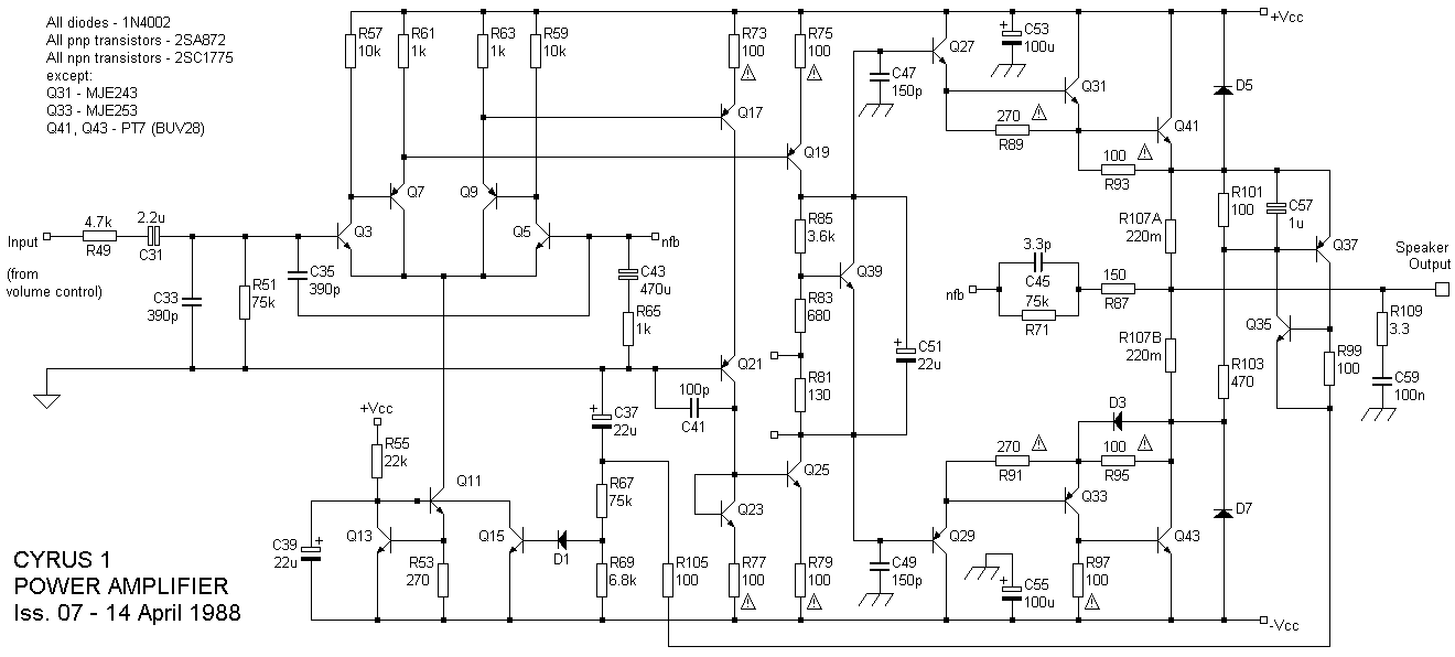

After 30 years + of use, a mains inlet failure has finally promted me to refurb my beloved mission cyrus one. With the help of this fabulous forum and others I have gathered the following info :
Schematics : attached
Video : YouTube (a cyrus two but still relevent I hope)
The most used and recommended replacement caps appear to be Nichicon ES non-polar (the green ones)
The caps I plan to replace (left channel/right channel), their values and Nichicon ES replacements are :
C41/C42 - 6.3V 470uF - UES0J471MPM
C33/C34 - 50V 2.2uF - UES1H2R2MDM
C39/C40 - 25V 22uF - UES1E220MEM
C49/C50 - 25V 22uF - UES1E220MEM
I note that the values of C33/C34, C49/C59 on my board differ from the attached schematic

1. Is my amp with its different capacitor values to the attached schematic just a varient ?
2. There are a number of other capacitors on the power stages. Is it worth replacing these as well ?

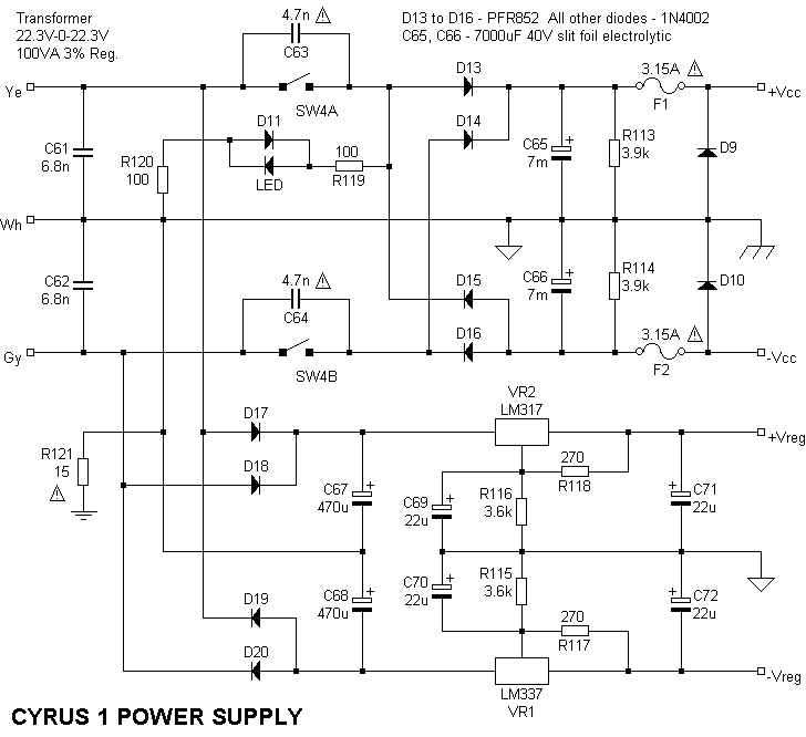

3. I have read that the two power supply capacitors - 50V 6800uF - are of the slit foil type and are usually ok. I will test. But, if I decide to replace, What would you recommend ?
I can find plenty of 50V 6800uF - but not slit foil type.
I have found these slit foil type:
ST2-010: 10000uF 80V Supertech 2T Slit Foil Capacitor | Hifi Collective
but they are 80v 10000uF - would they be better or worse than the original spec ?

There were 3 revisions of the amp. You'll probably find the big caps are fine, but there is a
little red circular capacitor marked "ROE" which is notorious for going bad. Make sure you definitely replace those ones.

Thanks for the info Jaycee - and I've jsut noticed that by one of the big capacitors the board is marked "Cyrus by Henry Azima issue 03" .
The red capacitors marked "ROE" on my board are C41/C42 - 6V 470uF - replaceing them with UES0J471MPM .

Hi. If you are going to replace any, you might as well replace all electrolytic caps, polarized and non-polarized alike. Note that you can use non-polarized in place of polarized if that saves you money. But don't replace any non-polarized with polarized. 🙂
thanks AndrewT and traderbam - yes I see what you mean, guess I was jsut wondering which caps were most critical. So yes it makes sence to change everything else while I'm at it. Should I go with NP all round or is polarity critical to the circuit design ?
Bi-Polar are generally larger and more expensive than the same value of Polar.
Bi-Polar are not available in high values.
That size/availability may force you to using Polar where Polar are already specified.

Anyone have thoughts on replacements for my (slit foil) 50V 6800uF resevoir/smoothing capacitors ?
The voltage rating marked on the side of a capacitor - does that always refer to DC?
Measure your PSU voltage and the mains voltage at the same time.
You can then estimate the maximum voltage your PSU will output.
If that worst case maximum is (well ?) below 40Vdc, then you can use 40V 6800uF slit foil.
sorry AndrewT I think we may be at cross purposes - what is there originally are two ELNA 50V 6800uF black caps that I read somewhere wer of the slit foil type, I cant find a liek for like replacement online. Bur I found these: ST2-010: 10000uF 80V Supertech 2T Slit Foil Capacitor | Hifi Collective and was wondering if they might be ok. I have since read that it may not be a good thing to go messing around with these cap values .. open to opinions - but now thinking i should just go for a good quality (whatever that means) 50V 6800uF -again open to opinions.
cheers
Rob
cheers
Rob
I think the originals are DNM Slit Foil manufactured by BHC. I would agree with just going for good quality 50V 6800uF capacitors though, as capacitor manufacturing technology has come a long way in 20 years
Your choices will be narrowed by the physical dimensions and termination type of the originals. I suspect they are snap-in or screw terminals. Making sure the replacements fit nicely is important.
50V and any values between 6800 and 10000 will be fine. Vishay, Nichicon have plenty of choices in this range. If you still have several perfect fits to choose from buy an above average priced one.
