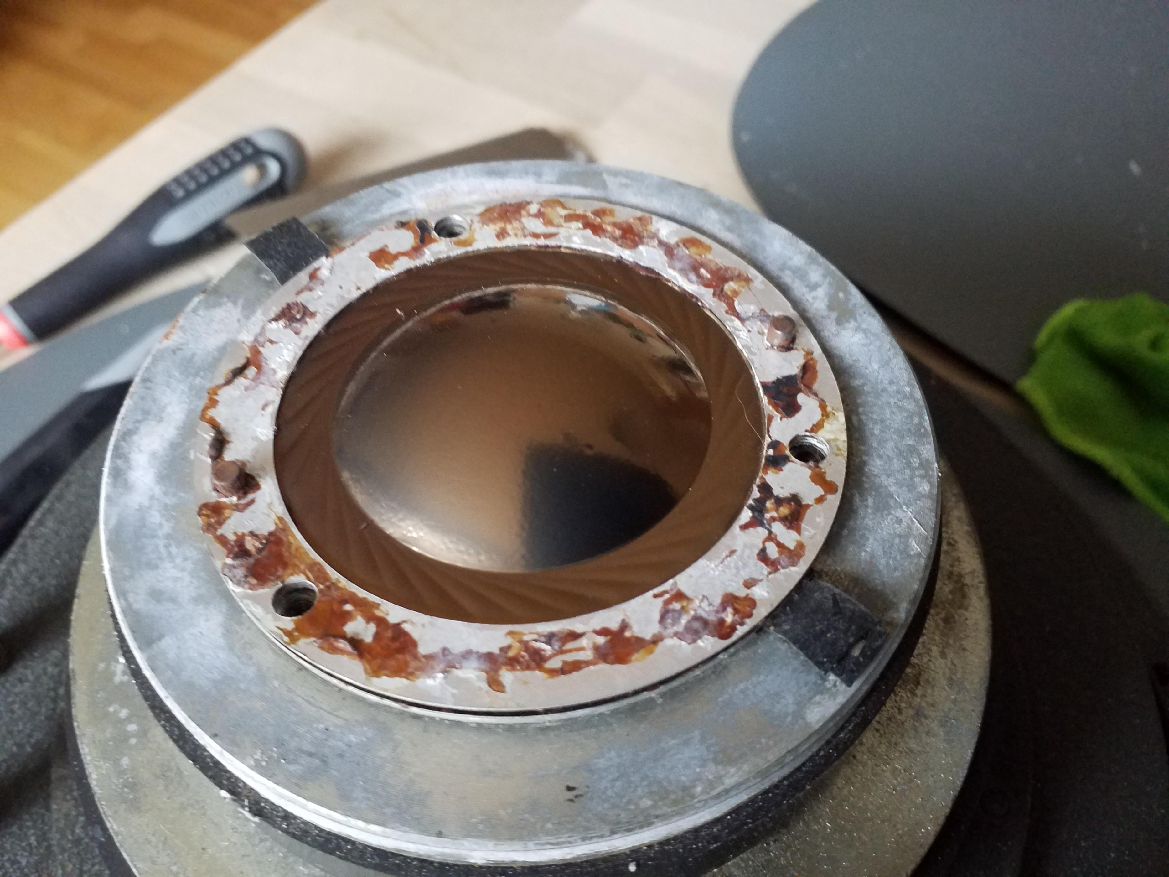

Wanted to clean my new d.a.s fullrange speakers today, seems like I made a bad deal. I think they have been kept in moist cold environment, the diagphrame was totally stuck, and yes I'm fairly sure it's a m3 tweeter, I checked for diagphrames, but they're 200 dollars a pop
