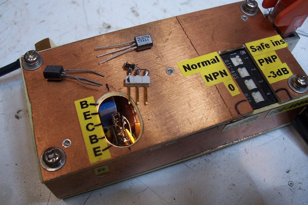

I have found the BC817's, in -16 and -25 selections.
I compared them to BC337-16 and -25 in my transistor noise tester:
attachment.php
The results are consistent: the 337's produce a noise output of 120mV, whatever that means (I don't remember exactly how the output relates to the noise, I would need to browse my documentation to know the exact relationship) and the 817's produce 90mV, thus significantly less.
I used the tester rather than a denoiser, to eliminate the effects of the 317, protection resistor, etc.
That's pure transistor noise performance, and depending on the context, it might make a difference, or not.
40 or 50 years ago, the 817 began its life as a pure electrical clone of the 337, but at some point they diverged.
Both my samples are from Philips, made in the mid-2000's, just before the NXP conversion.
