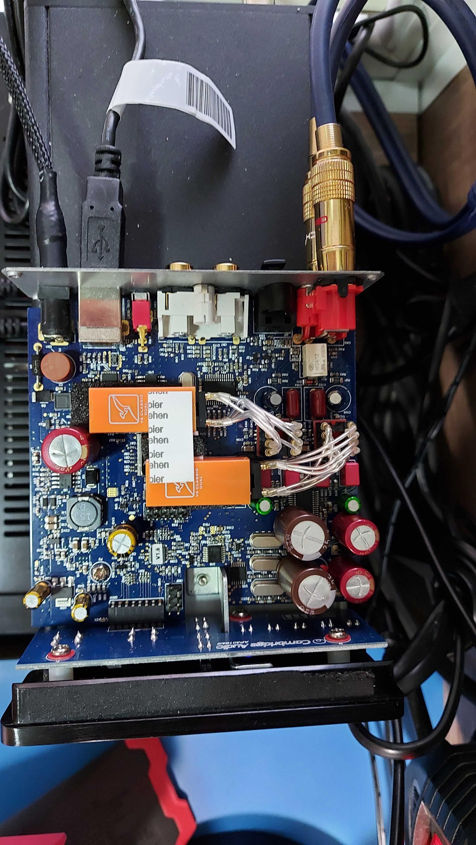

Hello ManoloMos, thank you very much for the reply I will be very happy if be a problem with the driver but it's not the USB port is completely dead but it's not shorted.Something get wrong with ROM I personally think.
The new DAC unit, before the USB port stopped functioning, it started interrupting during the activation of home appliances. (Reproduction completely stops and it needs to be turned off and on again in order to work) very strange behavior. After that, the USB completely stopped functioning, and the computer cannot recognize the DAC unit.
The problem with the older DAC unit is very similar to new one, except the computer can't recognize the driver, no samplig led indicator turned on.

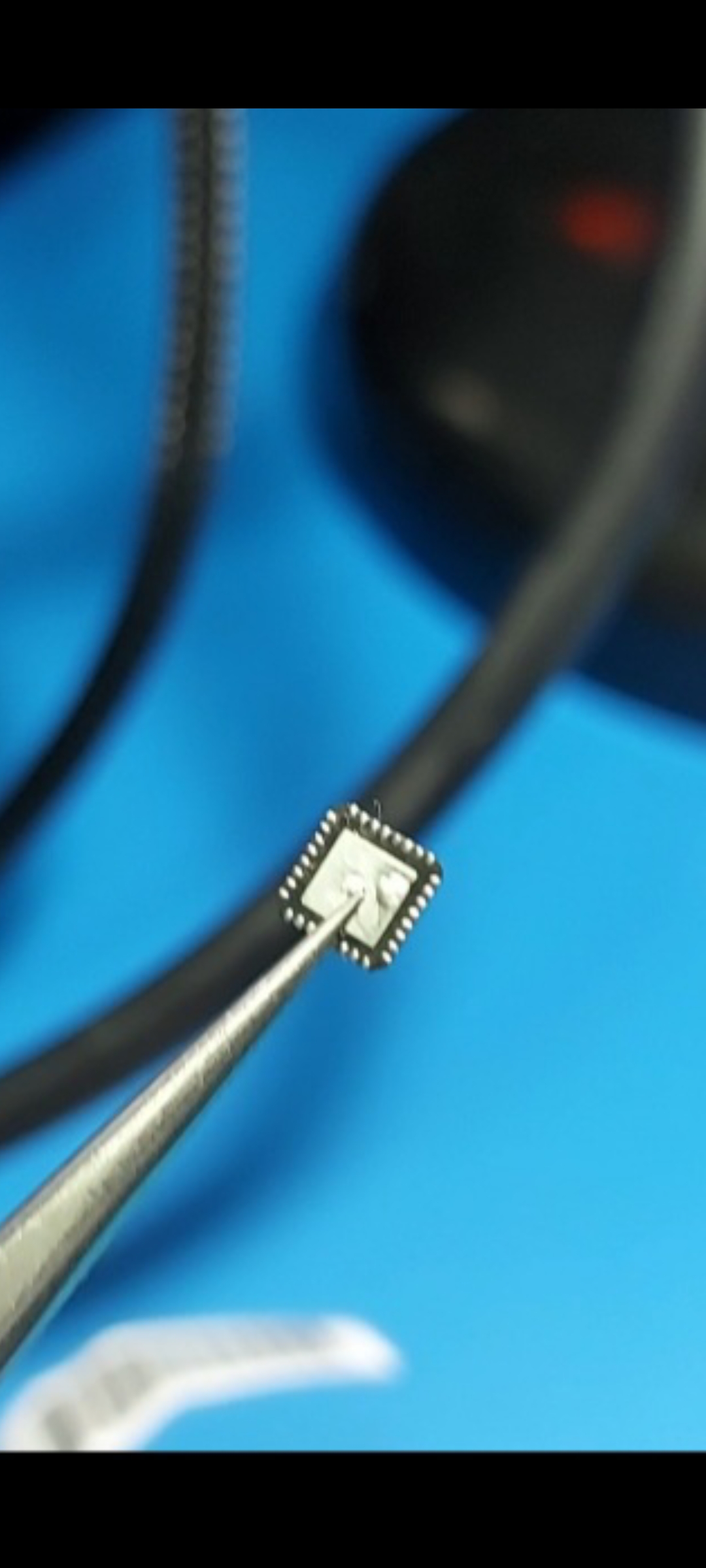

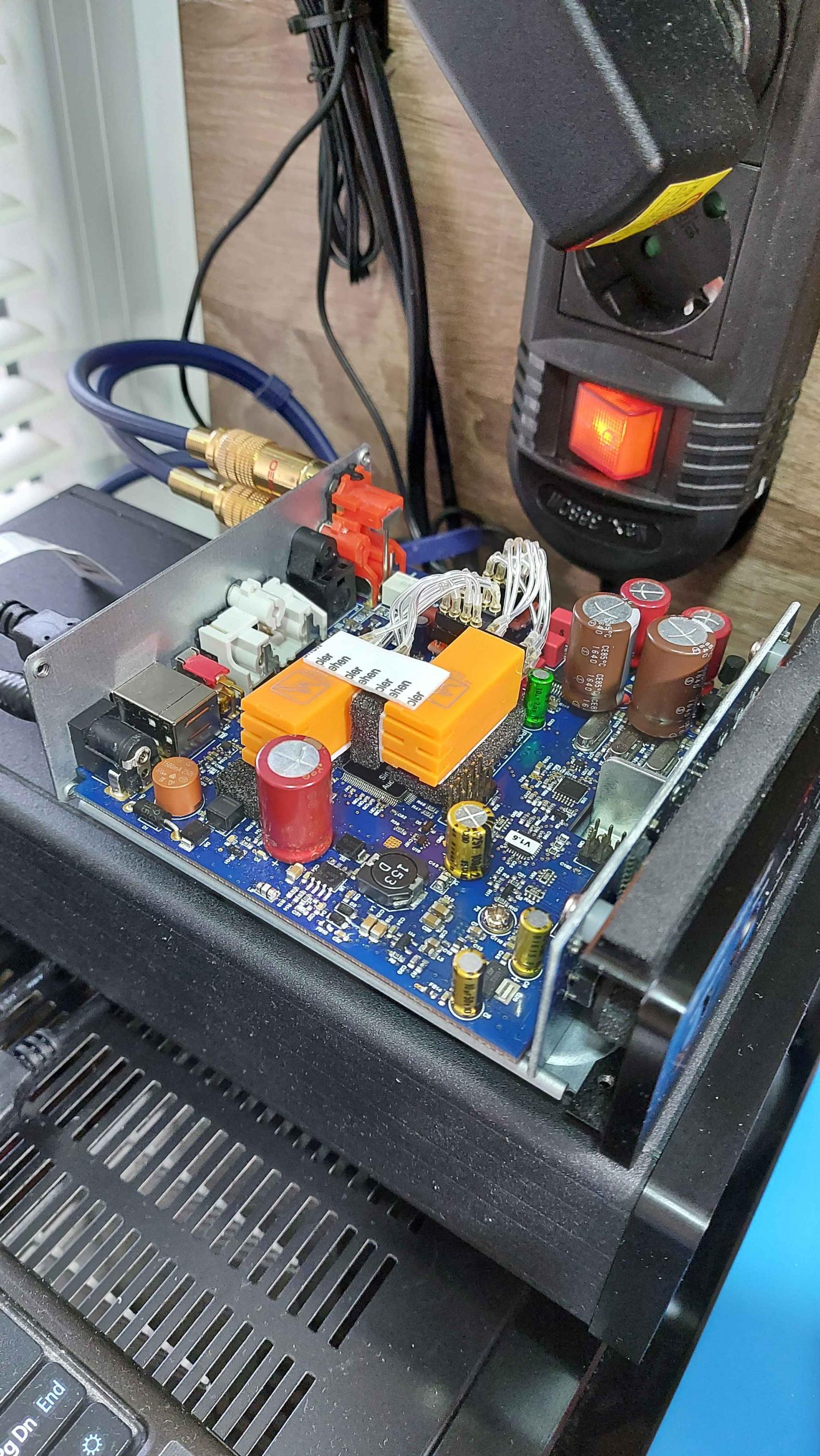

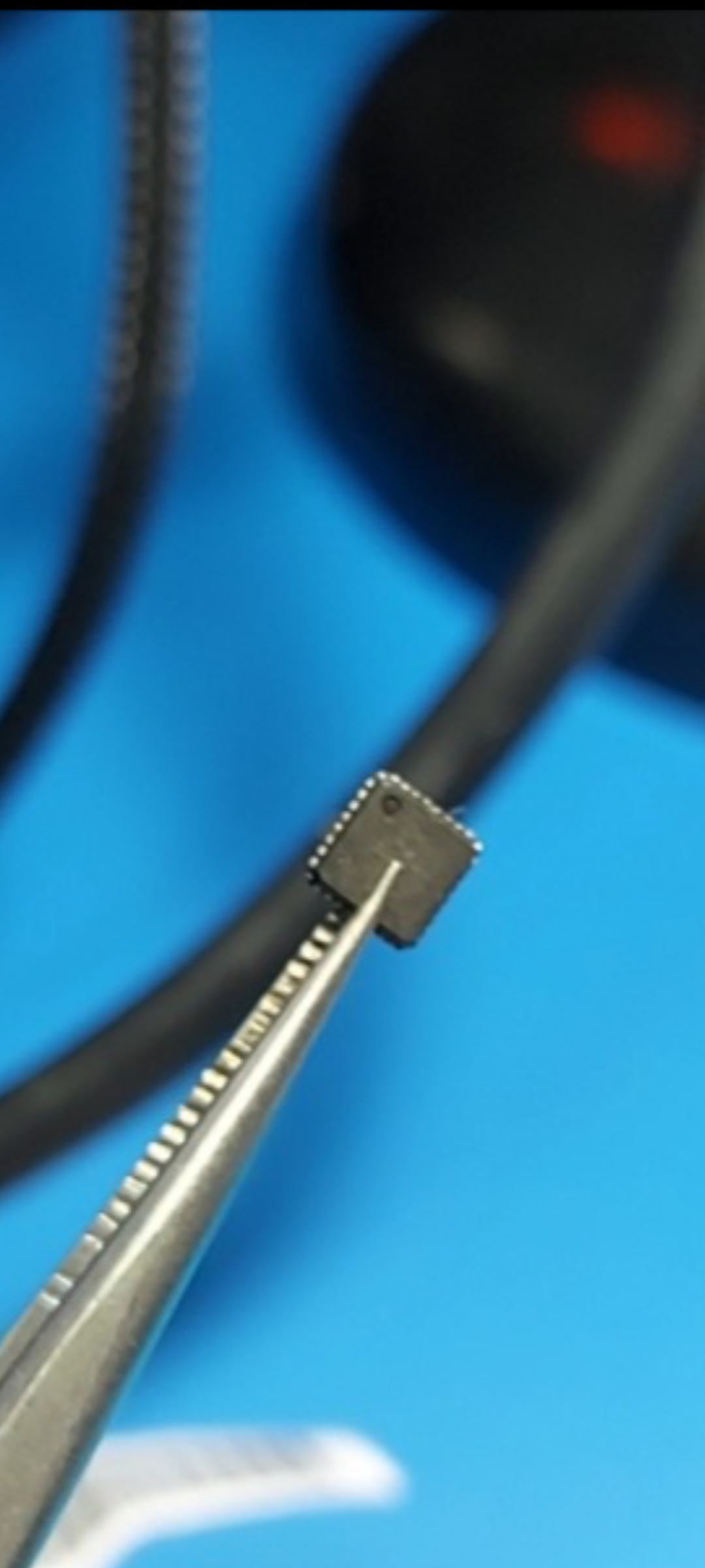

DAC MAGIC 100 usb port problem solved!

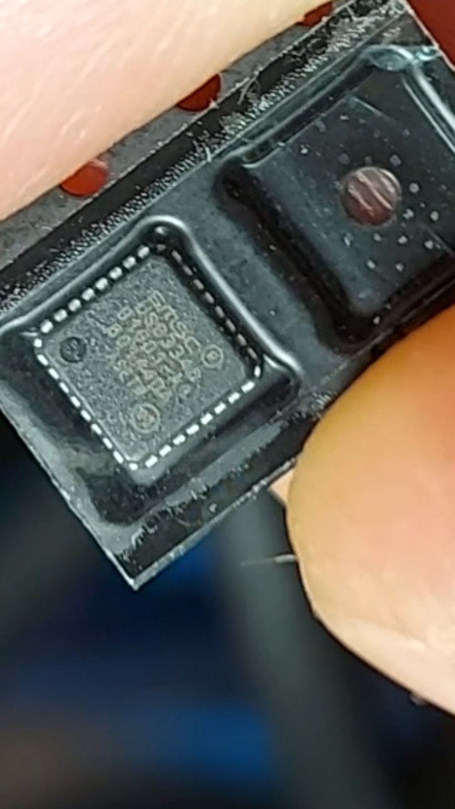

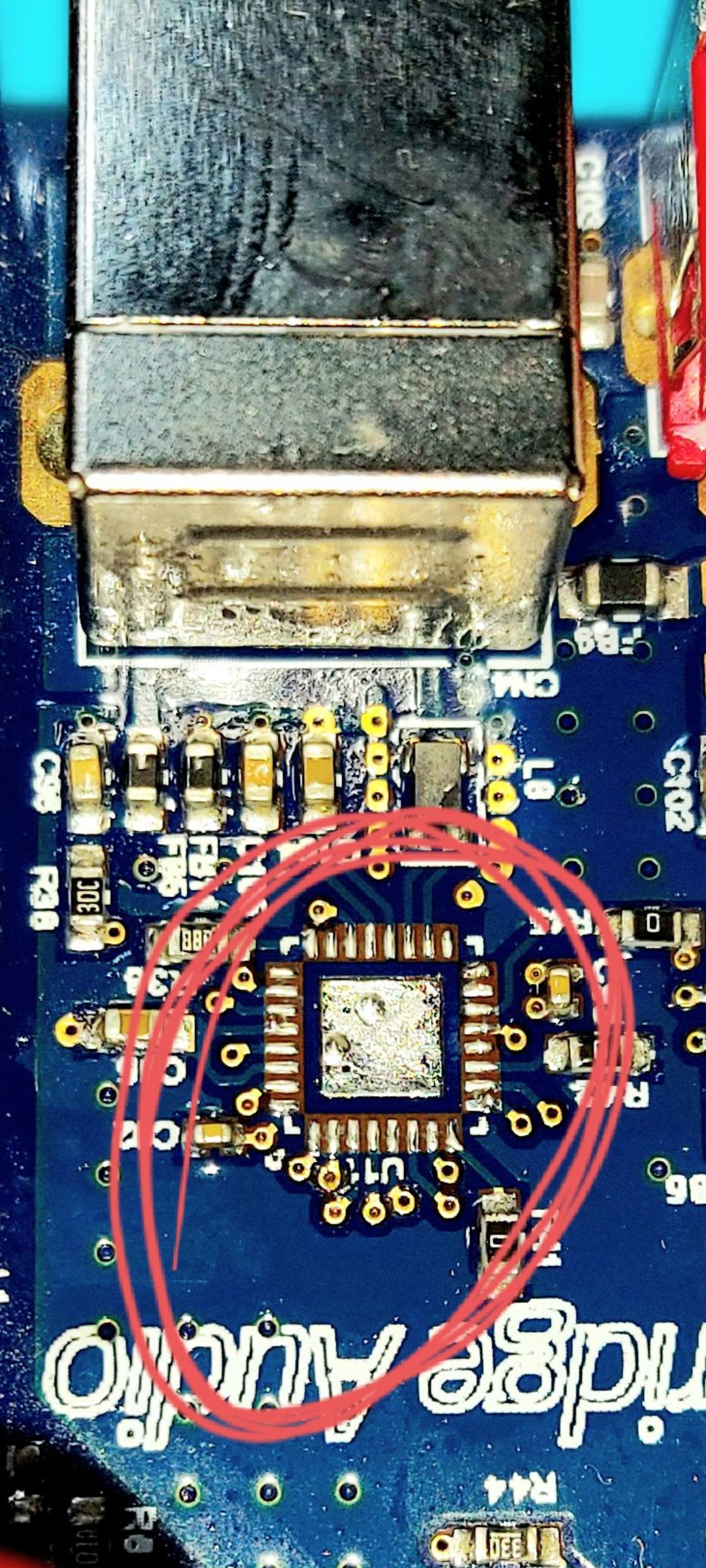

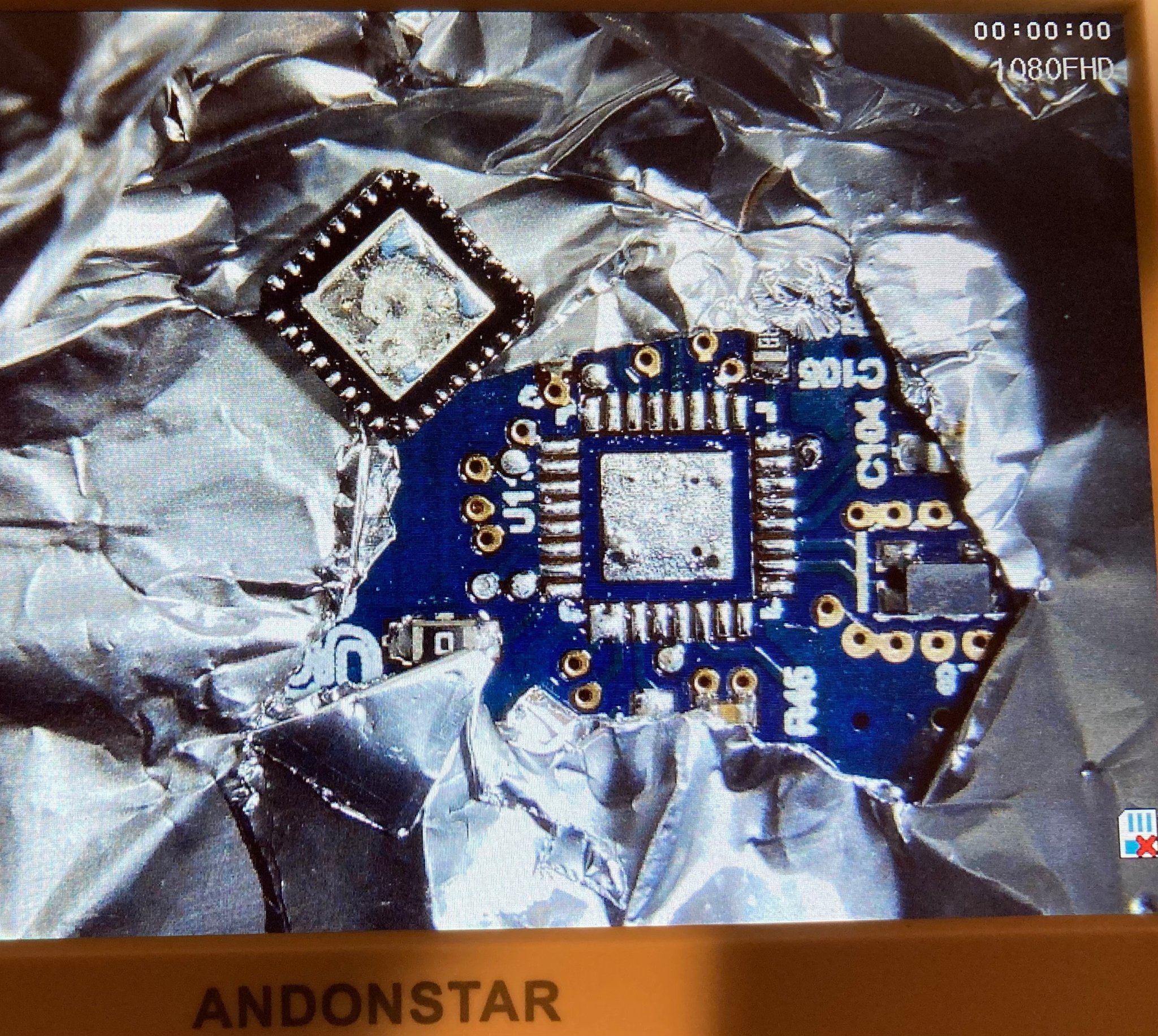

Finally solve the problem with the Cambridge audio dac magic 100.
I replace the chip qfn package USB3340 it's a USB 2.0 transceiver also try to understand what exactly happend.
Finally found the inductive switching transients spikes from my cooling water machine during switching off, voltage collapsing and destroy my usb port.
I change the plug to a different phase and buy APC surge protect power strip
Now everything working perfect, hope to help someone.

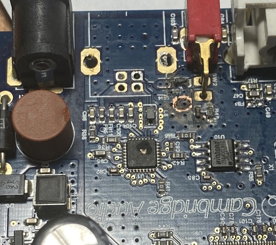

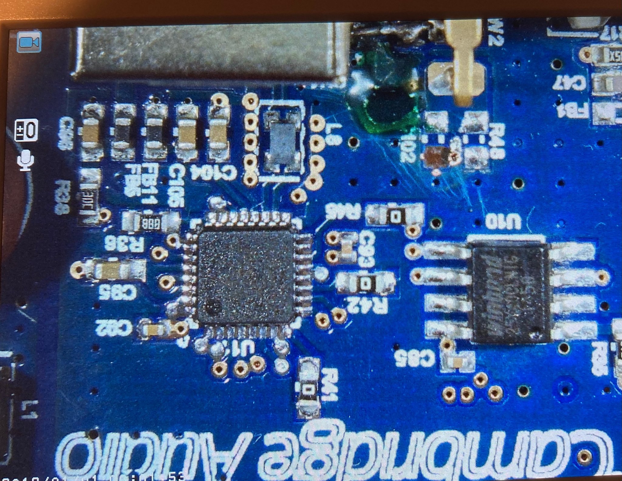

Hello, i have problem with my dacmagic 100 after thunder.
I need replace USB3340 and some parts around GND toggle
-R48 is 100 Omh resistor
-C102 is ??? capacitor
-FB9 is ??? ferrite bead
Maybe who measuring or knowing what is value this components, and suggests about repair my dac.
Big thanx!
Big thanx!
