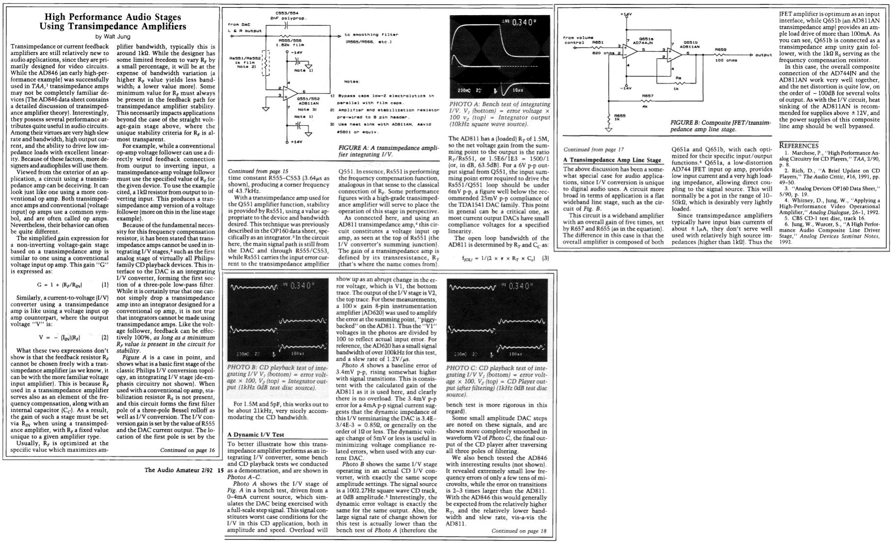

There is a schematic in an old Walt Jung article, but I'm not sure if it is usable in the form Jung presented:
Spec-wise, AD812 is rather a long way from being a dual AD811. But its certainly usable as I/V. The main drawback I've found in using CFB in I/V applications is noise and AD812 is noisier than AD811.

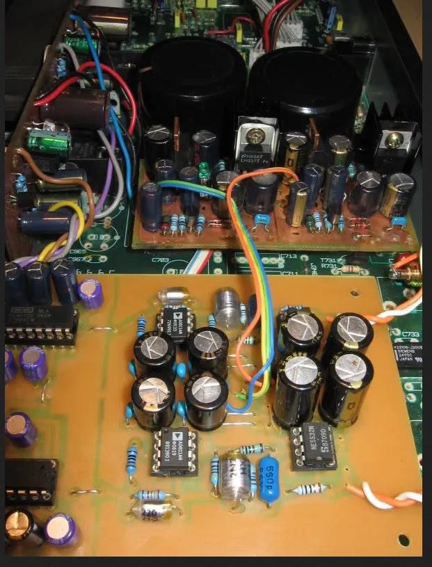

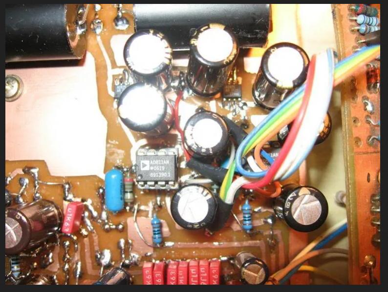

The AD811 can be used for i / v according to a schematic from old W. Jung article.

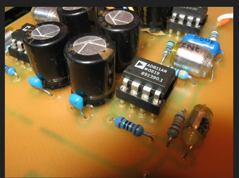

I used them a long time ago in two of my projects with TDA1541 and PCM1702 for the i / v stage. The supply voltage was +/- 8V from the W. Jung superregulator as seen from the pictures.
The sound was great especially with the PCM1702, however shortly after this I switched to the tubes for the i / v stage which I still use today.
But now I'm doing a new DAC with TDA1547 and I'm thinking of using the AD811 again.
With the AD811 you should pay attention to the PCB and not give it too high supply voltage because then you need to mount small heatsink on them, that's why I used +/- 8V.
