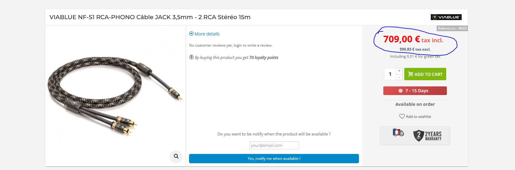

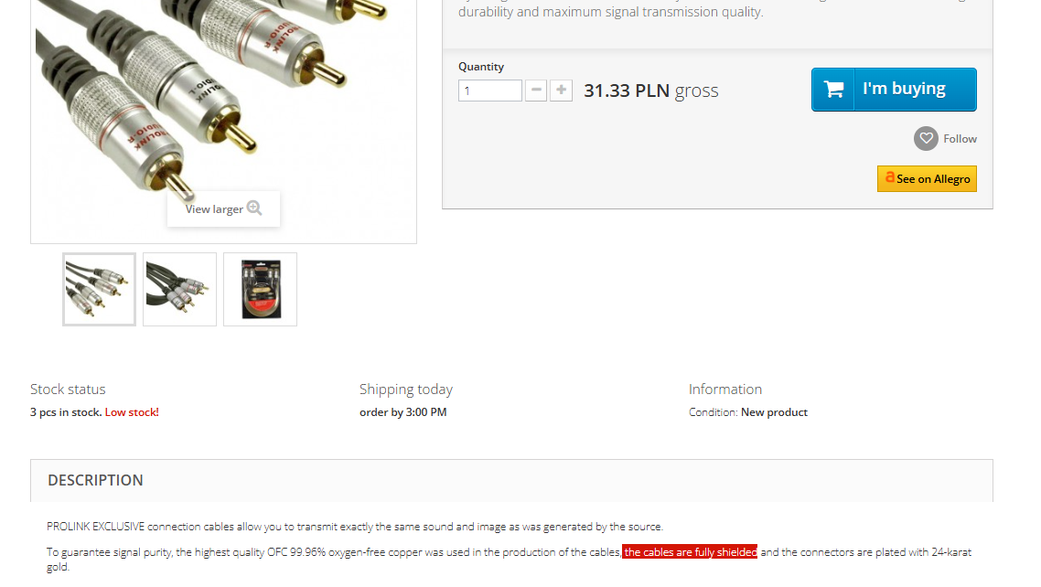

I bought two 10m jack to rca cables ( not the cheapest ) and they weren't coaxial, just 4 wires. Now the expensive ones are rather short, I don't know if I can find some good , long cables that won't cost excessively. That's why I would like to make it myself.
They are very flexible cables and feel good in your hand when you handle them. The connector seems well thought out and has a tiny screw on the side so it seems to be removable. From the looks of it I would say they are coaxial but I can't guarantee this. Maybe I will take the time one day to try to disassemble/open a connector to see exactly what the cable looks like inside.
I also tested other cables from the same place but they were much stiffer and the connector wasn't as secure. I ended up cutting them and saw that they were coaxial but made by a different supplier.
Anyway, at that price I think you can afford to give it a try. They've never caused me any noise problems and the connection is firm without being forced.
