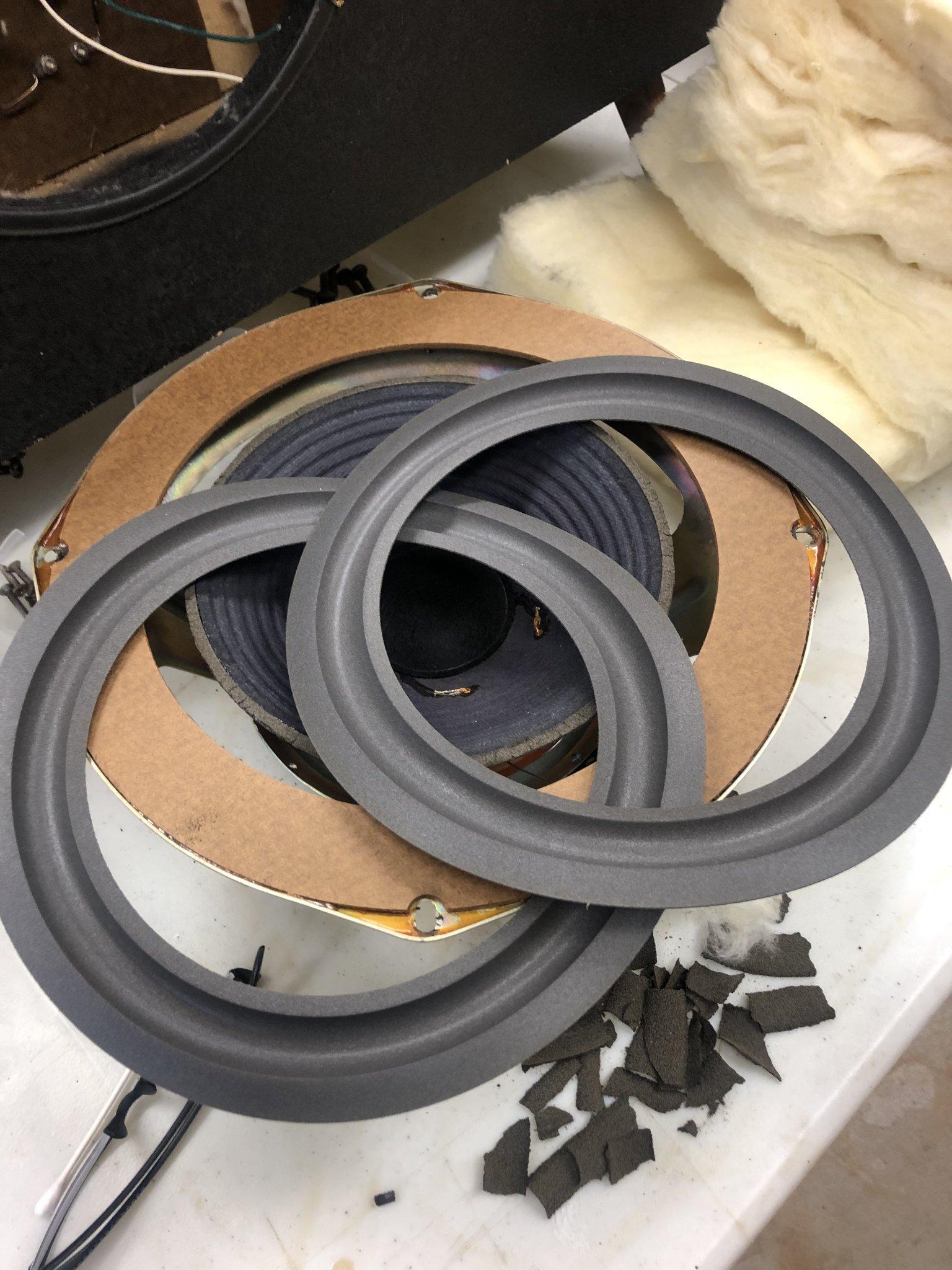

I just grabbed a couple of Dahlquist DQ 10s for 200 Canadian is there a thread on this forum that can assist me with the subject of rebuilding them and potentially modifying the crossovers and possibly adding a passive rad to the back of the base cabinet I just registered on this site today so I’m not familiar with it my apologies for posting my question in the wrong section if I have done so
I think Jon did a pretty decent job of system engineering with these so I’d take a very cautious approach, starting obviously with replacing the surrounds on the woofers. The most adventurous I got with mine was to mirror image the mounting of the drivers - actual quite a fussy bit of work - and even though the material of those 4 “open baffles” was quite thin, to chamfer their edges. At well over 40yrs of age, it’s also likely that the ELCOs may benefit from replacement, and there’s certainly not much to lose except hours of research, analysis paralysis and probably several hundred dollars by rebuilding the XOs. I never did with mine, but maybe start here:

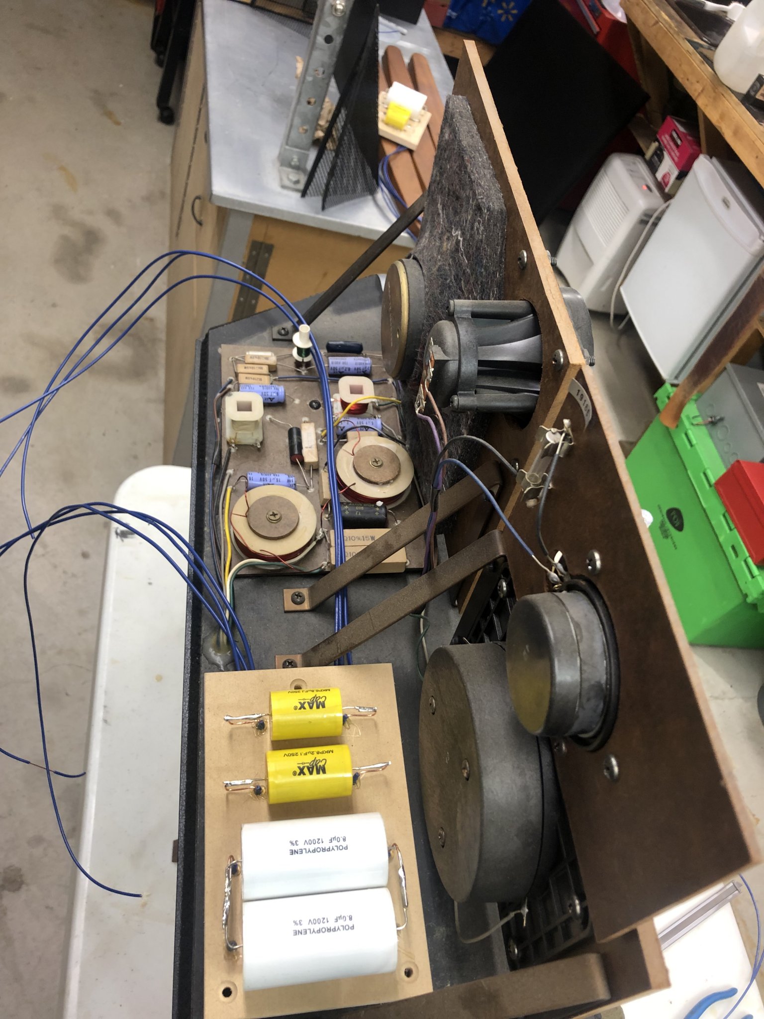

A lot of knowledgable DQ10 people there. I have worked on a few pairs, did the mirror image on one. I wouldn't do much more than consider the mirror image project, redoing a few parts of the crossover and consider some of the tweeter replacement options. Redoing surrounds is easy to do as well. I've not had any issues with the dome mids but if those are in bad shape you are probably screwed. The mid bass drivers can have stiff surrounds, there are a variety of opinions on how to approach that.

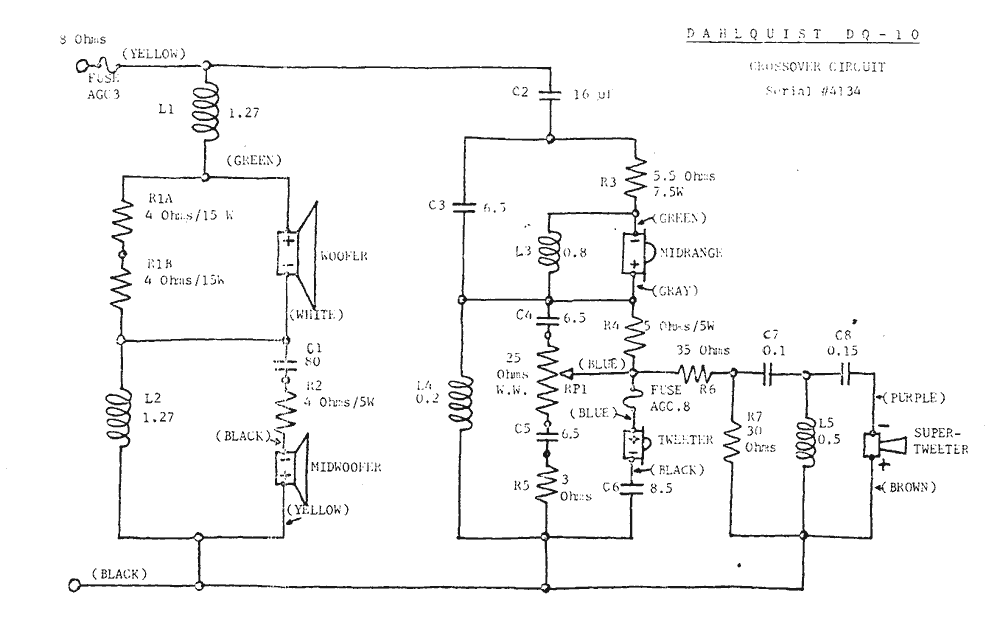

Crossover was optimized to provide best possible square wave response. I would leave it as is.
👍 I think Jon had a pretty good handle on that.

Provided the voice coils and lower spiders are intact, resurrecting the woofers should be too much of a problem, but should any of the other drivers aside from the piezo super tweeter need replacing, things would get tricky.

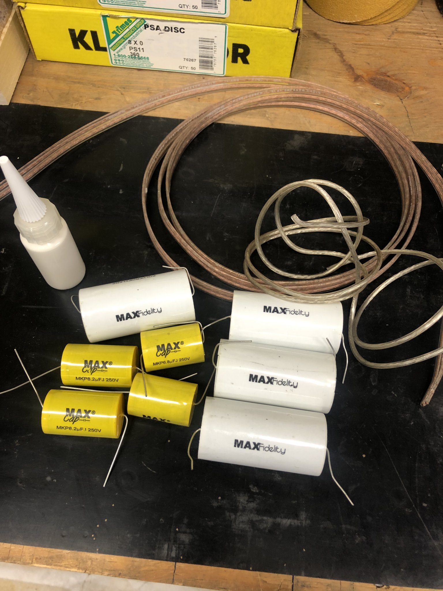

Every cap has to be replace, preferably with film, and the caps for the mid/tweet and above ought to be high quality and as they get smaller the cost shouldn't kill you and use a .01 uf in series with the cap for the highest frequency driver - helps get rid of cruft.

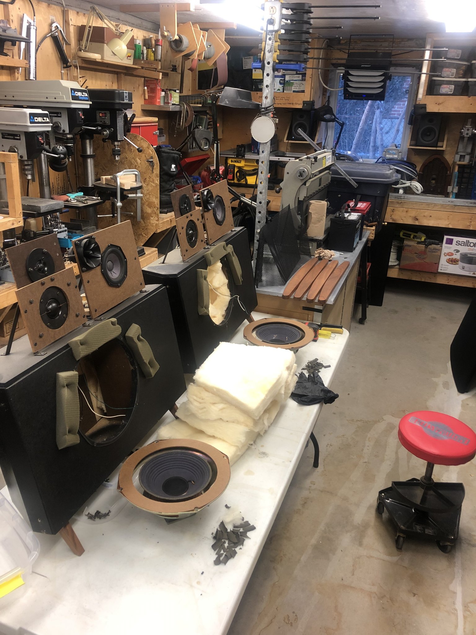

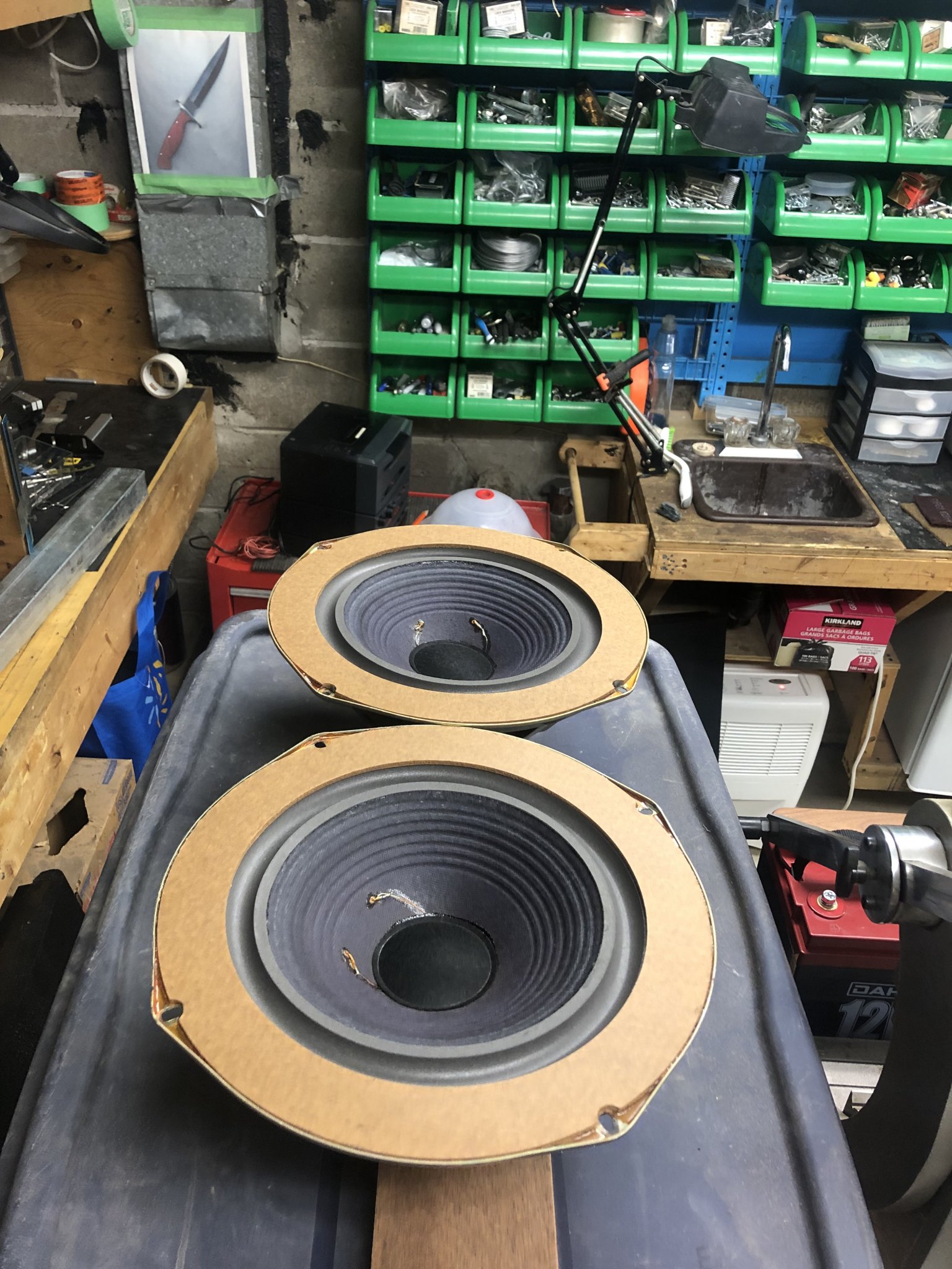

Thanks for all the input. I travelled quite a ways to a speaker repair shop and ended up speaking with an older gentleman with 40yrs in the business of speaker building. I told him I wasn't limited in my budget and I had time to refurbish the DQ10s I also have a hobby shop and am quite handy. What he ended up selling me was new foam surrounds for the Advent woofers and capacitors they were GIGANTIC OMG I had to build separate crossover boards, the guy explained to me the most critical cap to replace will be replaced by the giant caps 16UA he had smaller cheaper caps for this but told me there is no more critical upgrade I can make in these speakers than replacing the 16UA cap. I have since installed the foam surrounds, simple job. He spent a fair bit of time with me discussing crossover mods . He pointed out that since I wasn't limited in budget and he sells parts he could easily have my bill at $500 in no time at which point he chuckled. What he ended up doing was going into quite a bit of detail with respect to what parts were on my crossovers, what would give me best bang for the buck, and what would only provide me with diminishing returns for my money as well as what I should leave well enough alone. At this point he has been helping me for about 45 min no charge. I am hopeful that I will be happy with what I got for under $200 Can. I don't know anything about speakers or crossovers so if something in my mods raises a flag please let me know. I am going to consider all the mods already mentioned here by members ( thank you ) including mirror imaging ( worth the effort ? ) cabinet dampening etc also do I simply remove the high frequency fuse and solder the leads together? And the treble control dial is under ten bucks so regardless of the current ones functioning well why not drop new ones in while the woofers are out? The base cabinet was filled with what looks like home fibreglass insulation is there something better? I wasn't comfortable trying to get all these answers from the guy at the speaker shop as he had been so generous with his time so here I am.

There are two paper cones the bass driver and the 4" mid bass driver correct? I have never heard of these products, coat the cones front and back? how much do you apply? When you say basket you mean the frame of the woofer? Is plumbers putty sufficient? Thanks for now.Puzzlekoat/ModPodge the paper cones. Ductseal the basket

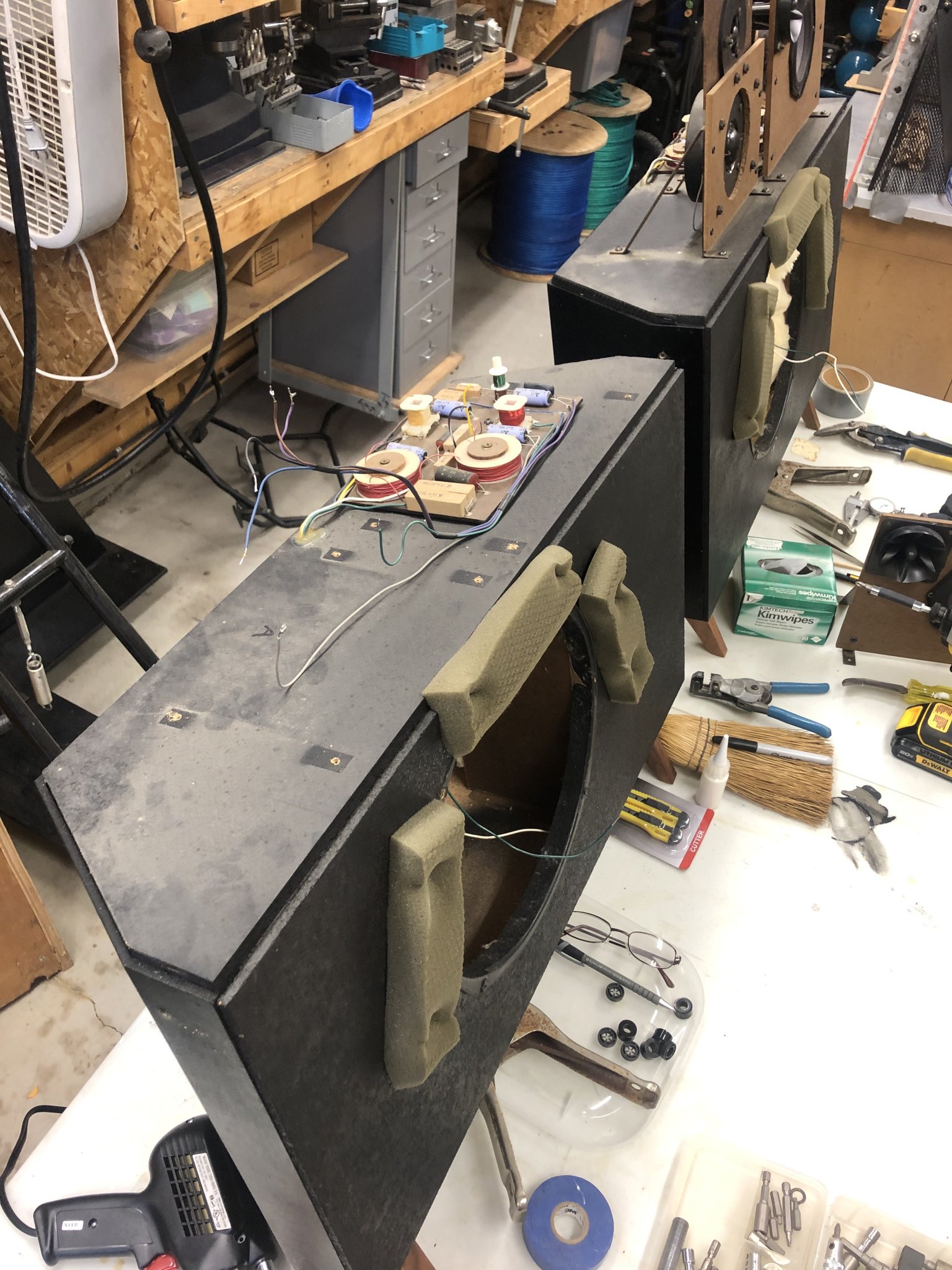

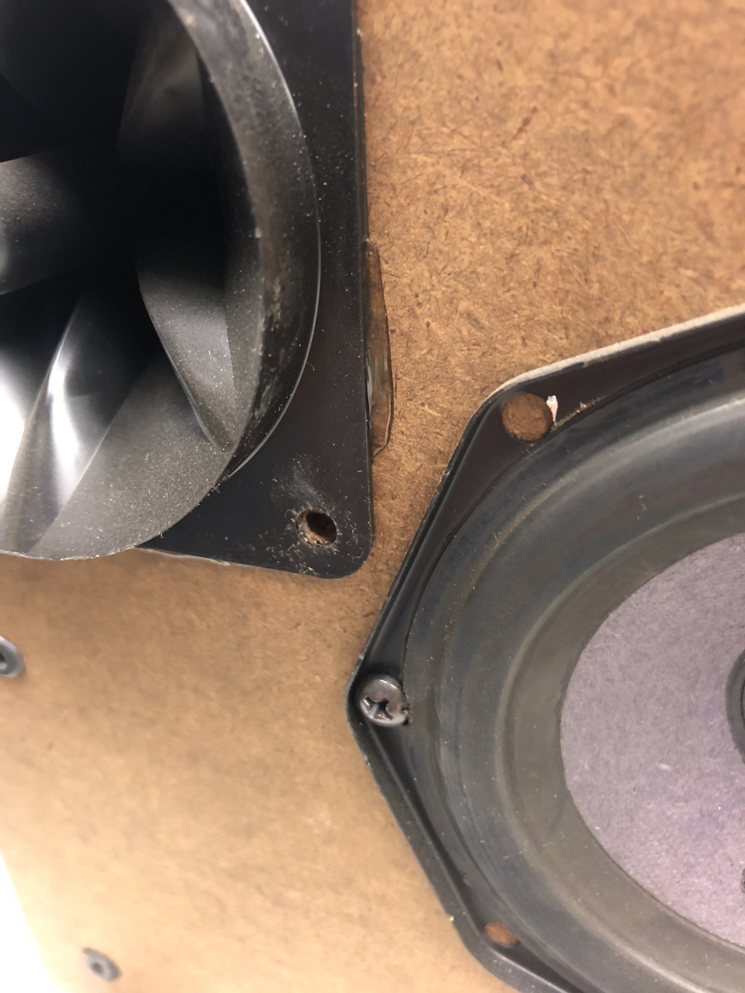

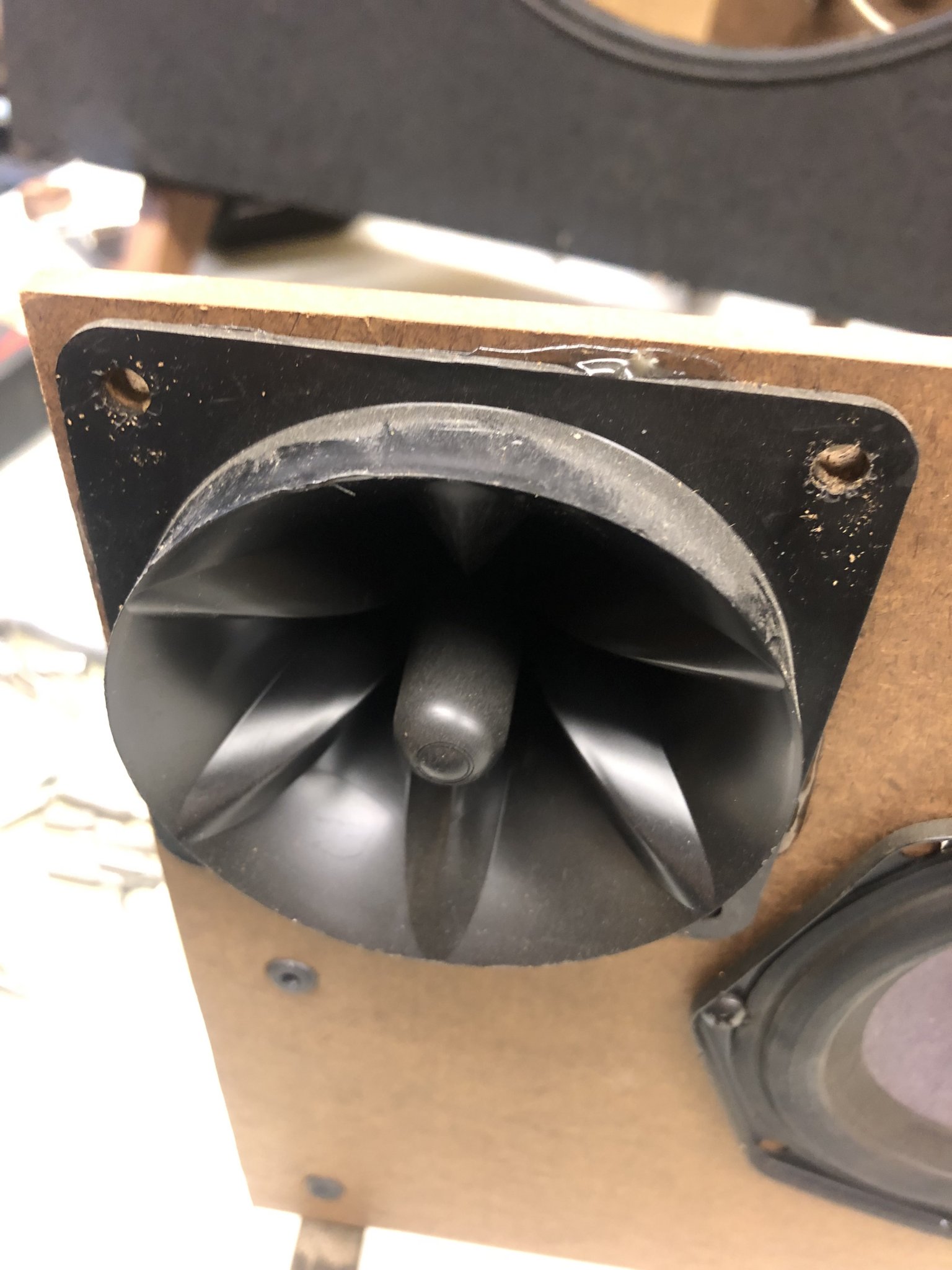

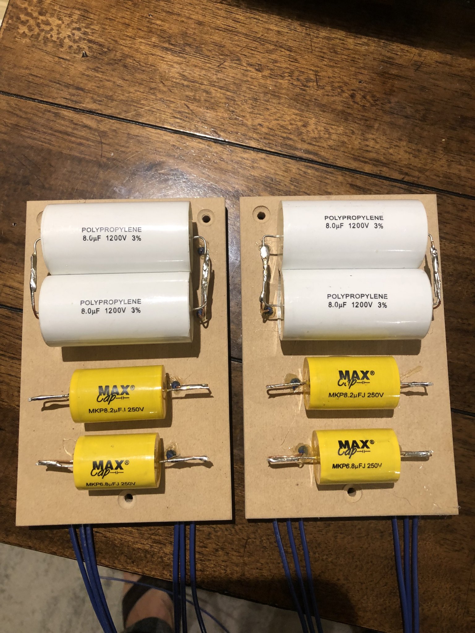

I just began the mirror image work and after desoldering and removal of the baffles I see the Piezo tweeter is epoxied directly to the Bakelite backer board, other than dropping it into a wood chipper anyone have ideas as to how to separate these items?

Don't coat the cones with anything. That's one of those bad tweaks that audiophiles fall for thinking it must do something good because it changes how it looks. It's a good way to make the breakup behavior unpredictable and ruin a driver that's operating in the midrange. They already have cone treatments originally. So, no need to mess that up. Do check the Philips driver, the 5" unit, for surround issues. The rubber hardens with time and cracks, both of which can throw it way out of spec. There are foam resurround kits available for it (it's an odd size) that I can point you to if you need them. You don't want to mess with the drivers in the DQ-10. These drivers were intentionally selected not because they were the best at the time, there were certainly better drivers out there, but because they integrated the best to offer unparalleled coherence for the 1970s. Change how the cones behave, change their tonal character with coatings and whatnot and you'll ruin everything that made these speakers exceptionally good for the time.
Your crossovers are from an older set with all electrolytic capacitors other than on the supertweeter. They should all be replaced by this point. The important caps to address are, yes, the 16uF, but also the 80uF. Either of those going bad will make half the speaker go silent. That said, the 6.5uF, two 6.0uFs (two of the older 6.5uFs were converted to 6.0uF in later revisions, not sure if yours are late enough to reflect that) and the 8.5uF (earlier examples were 8.0uF and 8.2uF, 8.5uF was the last revision) cap. None of the originals should be left in place as they will be either bad, off-value or high ESR and leakage at this point. The Matsushitas (caps with triangle emblem) may still be passing enough of a signal to sort of work still, but those black caps with red ends are guaranteed shot by this point.
Leave the fiberglass in the box. It needs it to damp the woofer and fiberglass remains one of the best materials for that in the bass frequencies. It's just obnoxiously itchy.
Be careful with that piezo horn. The masonite baffle board has a nasty habit of snapping and it becomes a pain to replace short of buying one from a parted out DQ-10 off of eBay. Try a knife and just work your way about it, a little bit at a time, as best you can.
