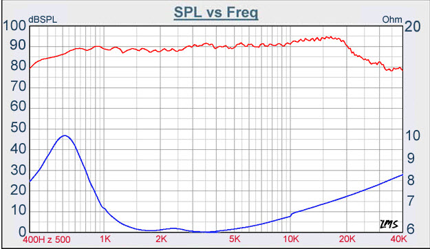

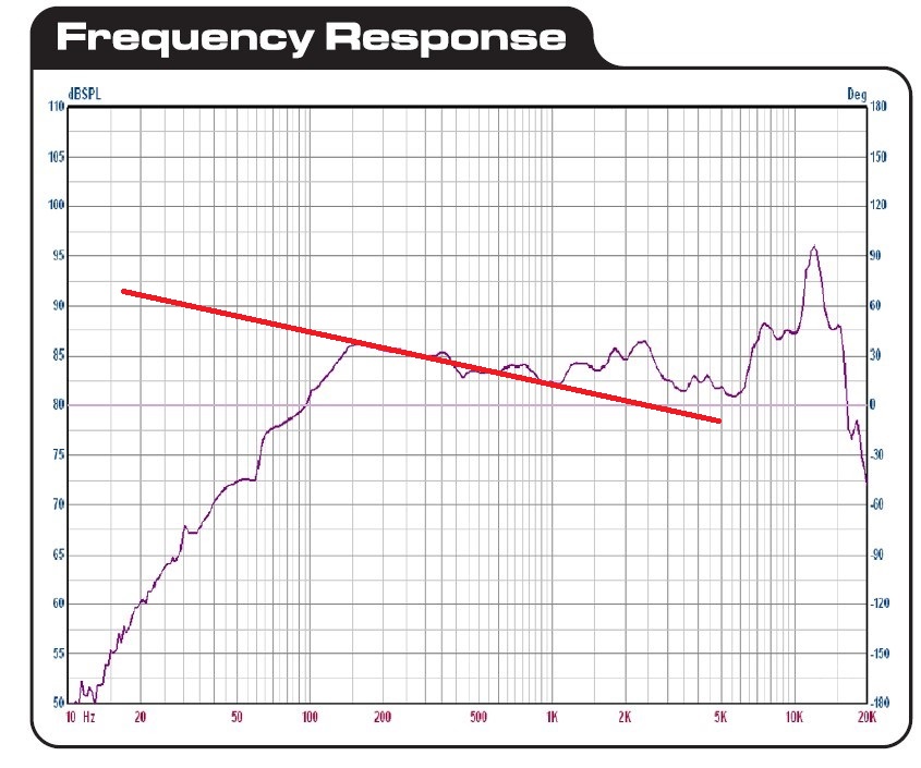

The Dayton RS125-8 5" looks nothing like a ""linear response"" driver.
Dayton Audio RS125-8 5" Reference Woofer 8 Ohm
The references to the 5" driver range (low-mid-range) is from 400 to 1000Hz, maybe a first order (L1=1.27mH) to the mid-range soft dome.

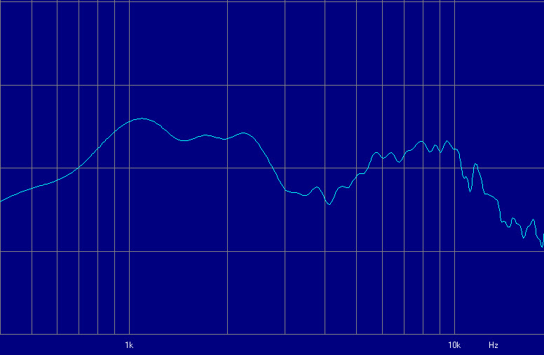

I have, with my Clio system, measured the DQ10 and each single driver individually, with and without the crossover, and came to realize what an ingenious design it is. The key drivers are the Philips 5" mid bass coupler and the Peerless 1 1/2" dome midrange. They have both an irregular response and a fairly high distortion when playing loud and they lack dynamics when compared to modern high end drivers.
The Philips mid bass has a spike at around 10kHz and the Peerless dome has a 5db wide dip at 4 kHz ( See pic 1 and 2 below showing the Peerless with and without network). However when measured individually connected to the crossover they are both, thanks to crossover network, more linear and both cover the range 800 Hz - 12 kHz (the mid bass spike still remains) however with reversed polarity. The fact that these two drivers work in parallel, however in opposite phase, and combined with a time delay (from the listeners perspective unless the speaker is pointing directly at the listener) is the key to the illusion of the 3D-spaciousness the DQ10 projects, a trick some other designers have tried to copy but not with the same success.

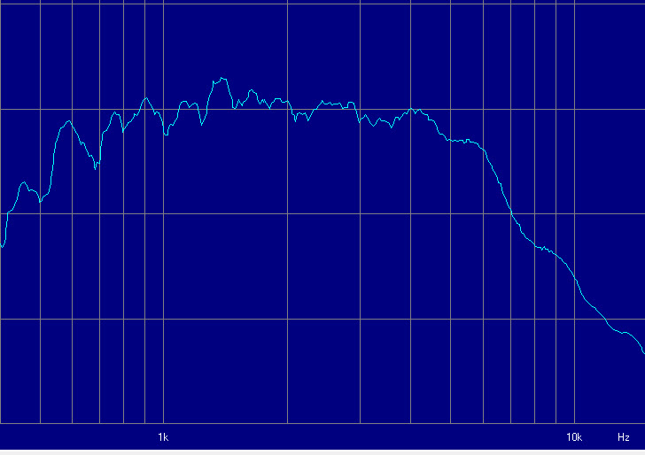

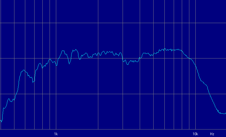

After researching the market I have only found two 1 1/2 drivers that cover the frequency range of the old Peerless:
Mavin DS-1 1 1/2" dome from Electro Mavin. They claim a range of 300-10,000 Hz but don't show a response curve.
Tang Band 50-1426S 2" dome. Has a ruler straight response curve but no longer available from Parts Express.
Tang Band 50-1933S 2" dome. New product to replace 50-1426S.(see pic 3 below)
