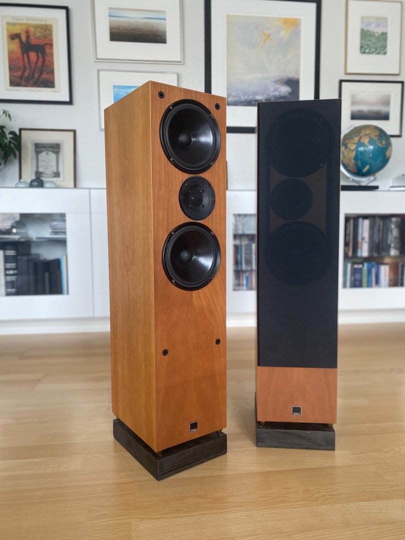

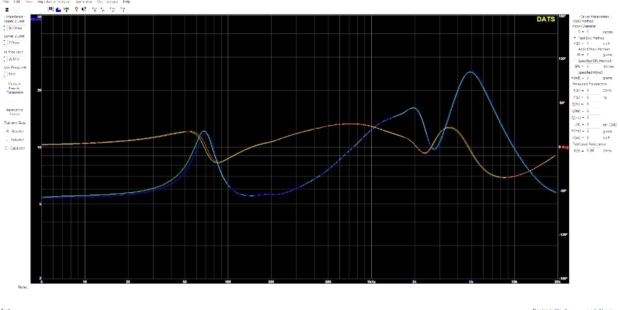

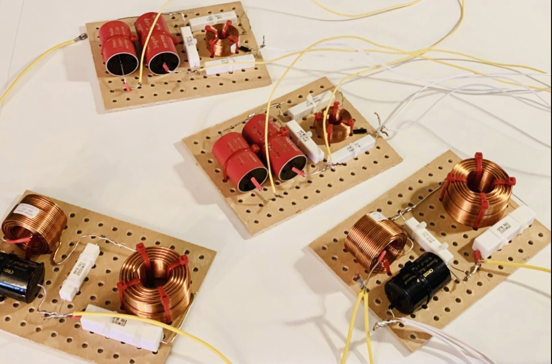

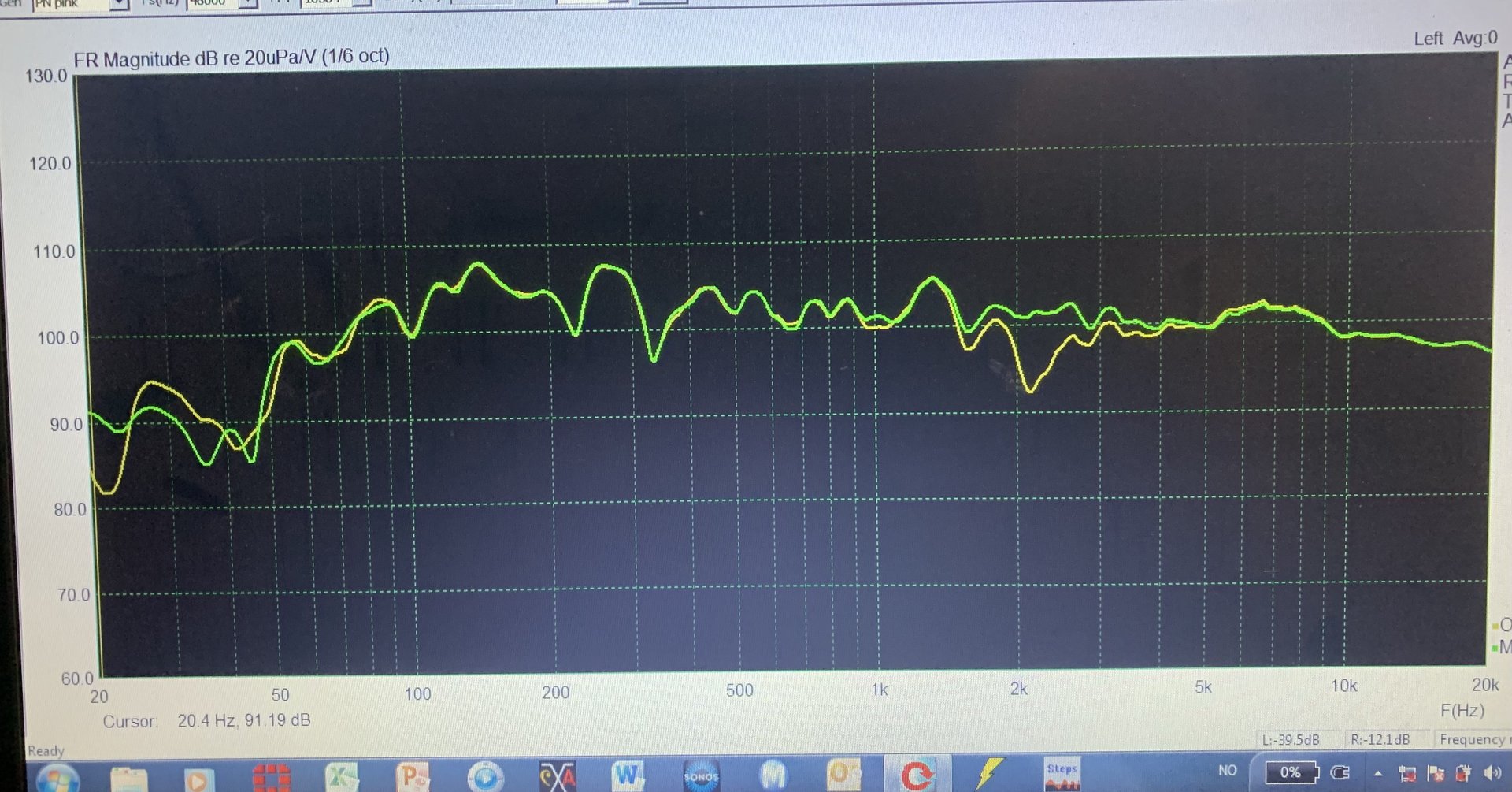

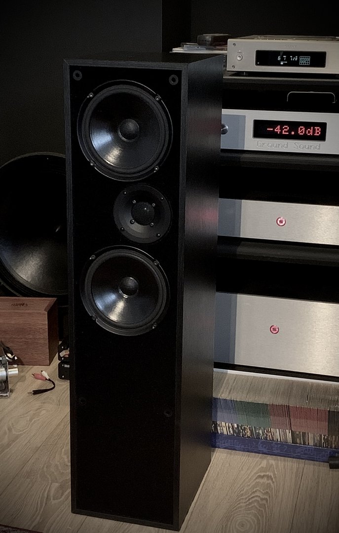

Dali 104 upgrade with Seas DXT tweeter

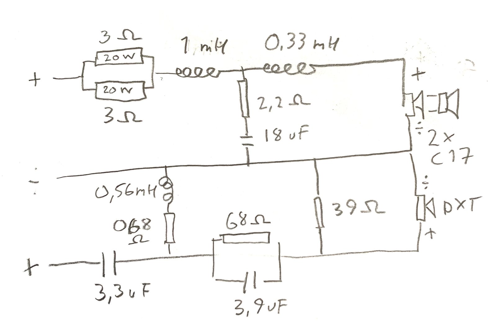

This upgrade gives you extremely low distortion from the tweeter, better pinpointing, better off axis and power response. And the good old Vifa C17 has a magic warm midrange. So if you want a high end speaker on budget who is a easy load for tube amplifiers etc. Good luck 🙂
PS!
1) you must plug the port with foam or a big sock, or even close it with a plate
2) the 0,68 uF paralell resistor on the tweeter can be removed if the 0,56 mH inductor have high dcr
3) yes, it is a series resistor on the woofers, if you dont beleive it sounds good, please find another project 🤭
4) if your sofa is high, make a 10-20 cm base

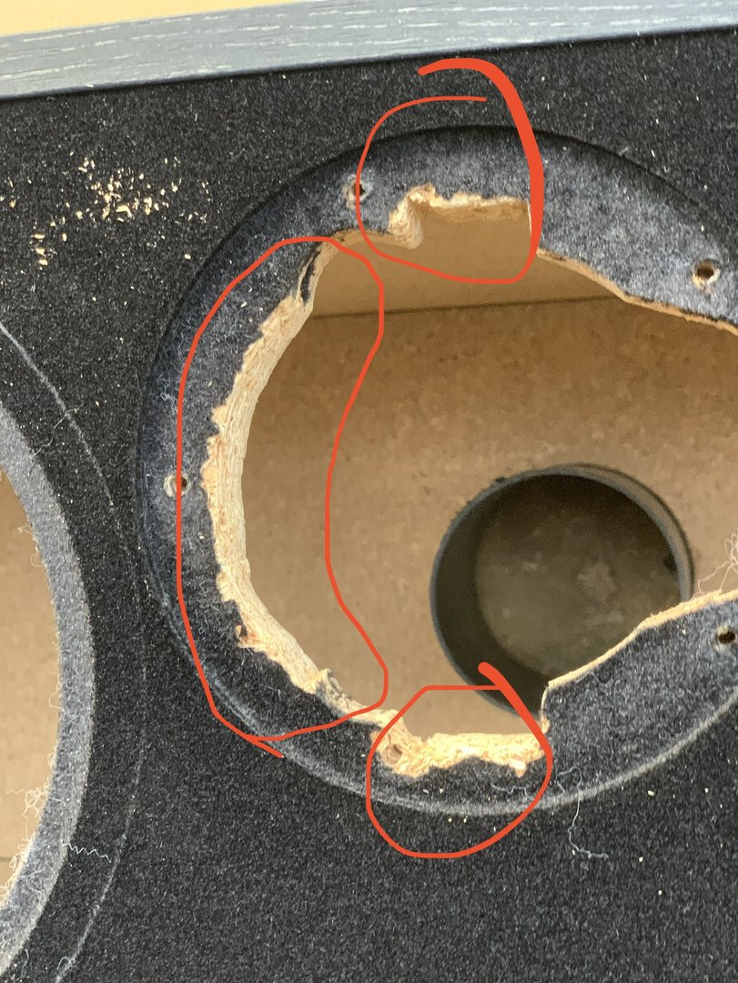

5) be careful when you cut in the tweeter opening, use a lot of gaffa tape to mask and protect
6) a little extra damping with f ex bitumen inside doesnt harm
7) have fun 😊
