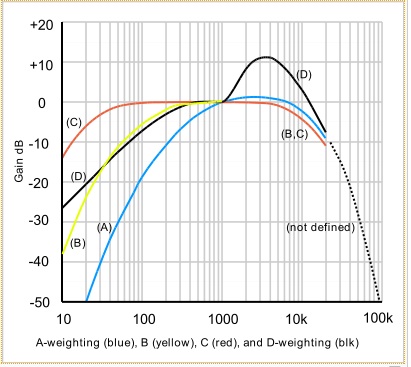

If OSHA (or the more conservative NIOSH) had determined LF was a problem, they would specify unweighted or “C” scale rather than “A” scale, “A” scale rolls off the LF at the rate I noted in post #2, an example of the different weighting curves below.
As far as hearing loss on motorcycles, loud wind noise causes hearing loss over time. I recall a study of highway patrol officers back in the pre-internet era time when “air conditioning” meant opening up the windows. A high percentage of the patrolmen had hearing loss primarily in their left ears, which were exposed to more wind noise.
Short term tinnitus (ringing in the ears) results from exposure to loud sounds, if the ringing persists until exposure to loud sound again after a resting time period, hearing damage will result.
Having tested LF at levels of 120 + dB SPL at 40 Hz, I have experienced less tinnitus from that than from the same exposure time to a mid/ high noise like a saw or router at only 90 dBA.
Art
Is that theory widely accepted by professionals or is it your interpretation?
Ben
This seems to be fairly accepted in academia, I have it from this textbook, Fastl and Zwicker are/were among the foremost experts on this subject, so I tend to trust their research results.
What Art says is of course equally correct, due to the human ear canal acting as a quarter-wave resonator, which offers gains of around 10dB centered around 4kHz, the frequencies from 2-5kHz are often among the first to go (I know this firsthand, as my right ear has over 10dB hearing loss right in that frequency range, despite the fact that it hears up to above 20kHz).

OSHA could have used "D" weighting, which is has about a 10 dB peak centered at 4000 Hz if they deemed it was needed.
They didn't, they used the more common "A" weighting, and worked out exposure based on that curve.
If one is exposed to a specific damaging HF frequency set, such as dentist's drills, the OSHA standards are too lenient, the NIOSH standards are more in line.
