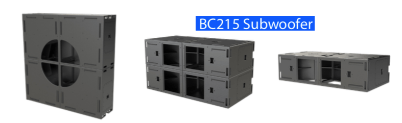

The BC (Boundary Coupled) front loaded horns (FLH) may be arrayed or used singly and still have considerable pattern control well below the wavelength of the baffle and cabinet sides, 112Hz by your estimation.
Increased on-axis forward gain up to +4dB from the cabinet frontal boundary below 70Hz is evident in the "BC18 flat" compared to the "BC218 half moon" vertical orientation:
A +6dB gain when doubling equally driven low frequency cabinets is standard, gain above that level is boundary dependent forward gain.
The BC218 relative lower frequency forward gain is actually more in the single cabinet vertical "half moon" orientation than the two-cabinet "end to end" array.
The BC412 and BC415 use single center mouth locations, the BC215 and BC218 dual side mouth locations offer more options for coupling between themselves and external boundaries.

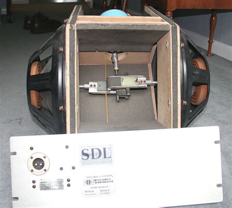

None of the DSL (Danley Sound Labs) loudspeakers use the old Intersonics SDL (Servo Drive Loudspeaker) servo motor technology.Isn't it the drive motor what makes these speakers interesting?
The SDL BT-7 had just over 1" peak to peak excursion, an Xmax of ~12mm.
The linear excursion potential of standard moving coil transducers surpassed the rotary servo motor to belt-drive system last century.

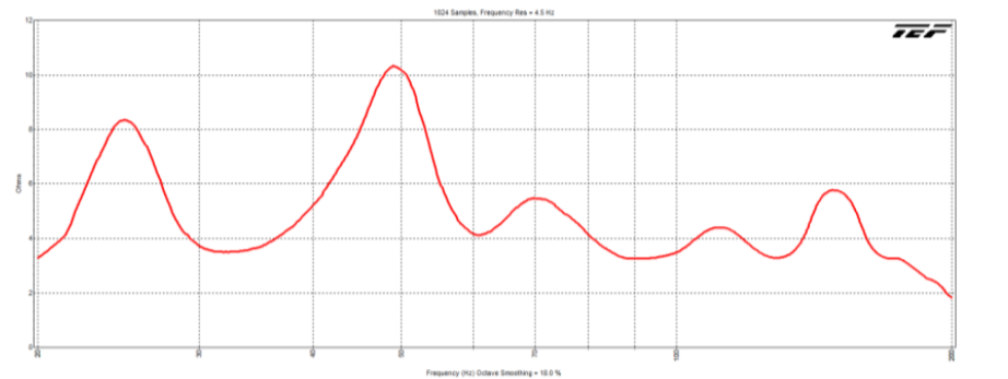

The BC218 frequency response chart in post #4 sensitivity must be weighed against it's minimum impedance of 3 ohms (2x6ohm) at 90 Hz, but at least it is right there on the impedance chart:
Wish more did, it's difficult to compare sub specs between different manufacturers.

Not commercially.Nobody produces these drivers like "old Intersonics SDL (Servo Drive Loudspeaker)" any more?
All motors have thermal limits (restrictions).Practically it could do more cone travel than classical drivers and there are no thermal or thiele small restrictions.
The TS parameters could be measured, but practically the stiff, heavy cones mass caused the belts to shred quickly if run too high in frequency.
The stepper motors Intersonics used would reach their thermal limits at ~1" peak to peak for two 15" cones, and after many initial burnouts, used fan cooling.
They also were a tough load for most amplifiers, later versions also incorporated a transformer.
There was nothing "easy" about the "servo drive loudspeaker" 😉It should be easier to get undistorted sound?
At the time they were developed, there were few or no drivers designed specifically for high LF excursion in horn loaded applications.
Their excursion potential was about double of most drivers of the time, so they could go around +6dB louder at similar distortion levels.
The stepper motors the SDL used went out of production, suitable replacements were more expensive.
It didn't take long (in historical terms) for conventional drivers to surpass the undistorted output potential of the SDL at lower cost.
