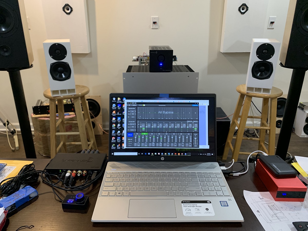

Here is my first test of the DSP408, was to use it for my 2-way PMC TL cone (desribed here), with an Alpha Nirvana 40w Class A amp for the 5in woofer and the Dayton APA-150 Class AB for the dome tweeter. Here is the overall setup in my lab:

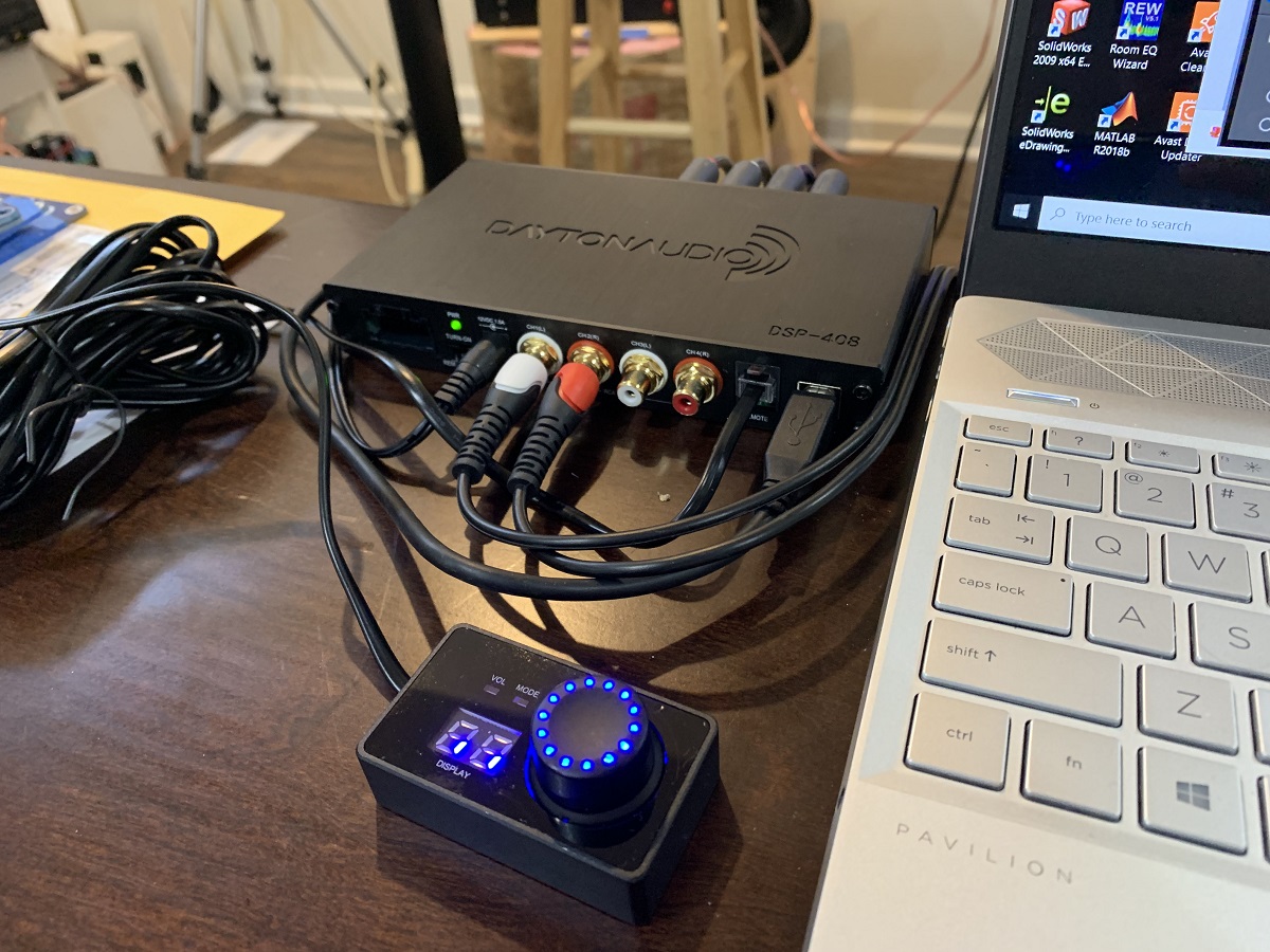

Here is a closeup of the DSP408 and remote:

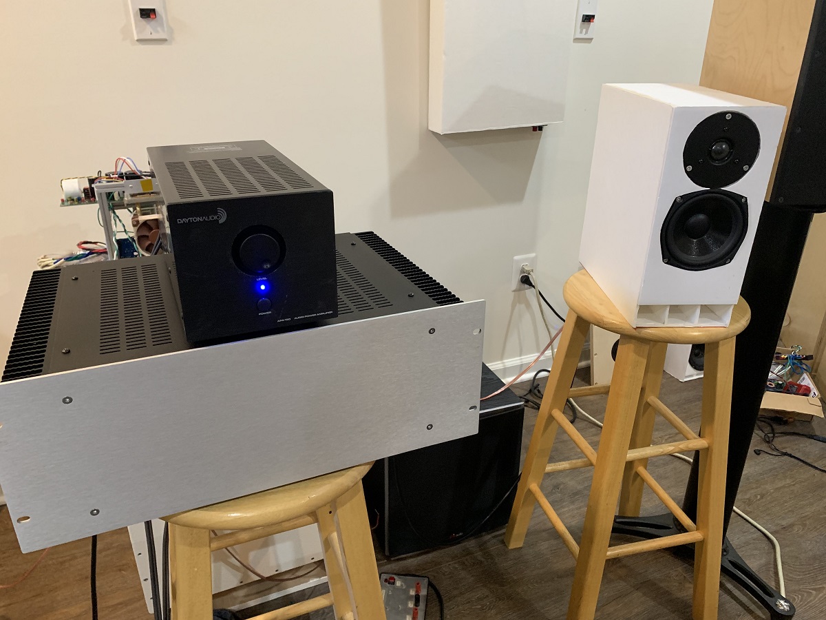

Here is a closeup of the amps and the speaker:

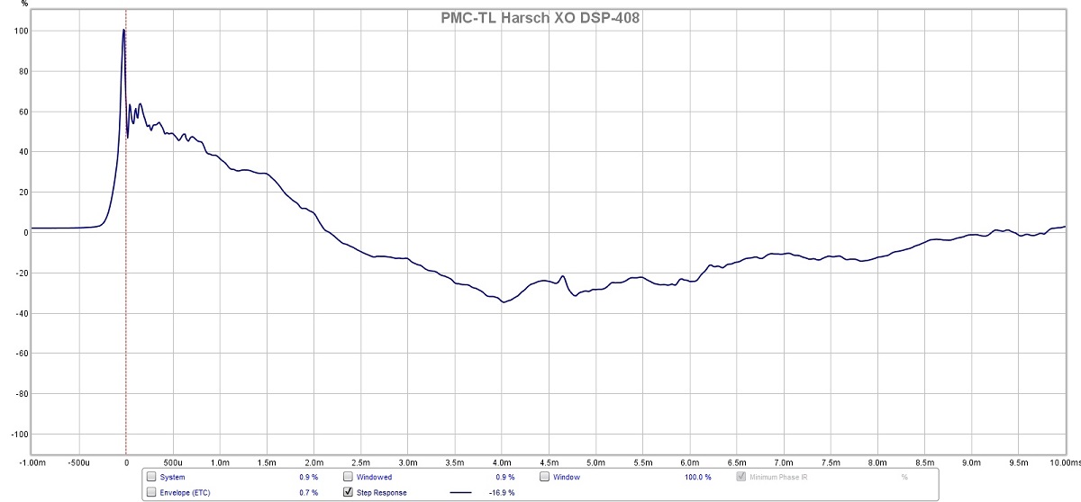

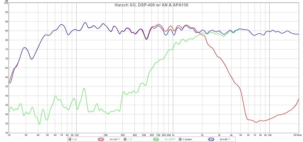

Here is the measured frequency response of the speaker with a Harsch XO (described here) quasi-transient perfect crossover:
Here is the measured step-response of the Harsch crossover - this is better than I was able to achive with a miniDSP for some reason. The right triangle is distinct and less "loaf of bread" shaped. It may be better amps, I don't know as last time I did this was using a pair of TPA3116's.
Overall, a very respectable performer and easy to use. I set all this up in 15 minutes from turn-on.

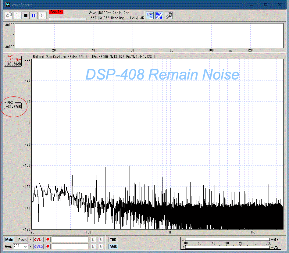

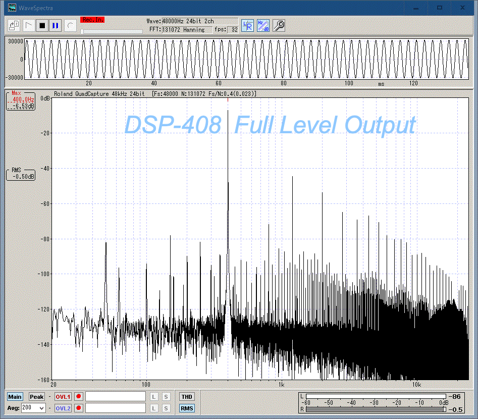

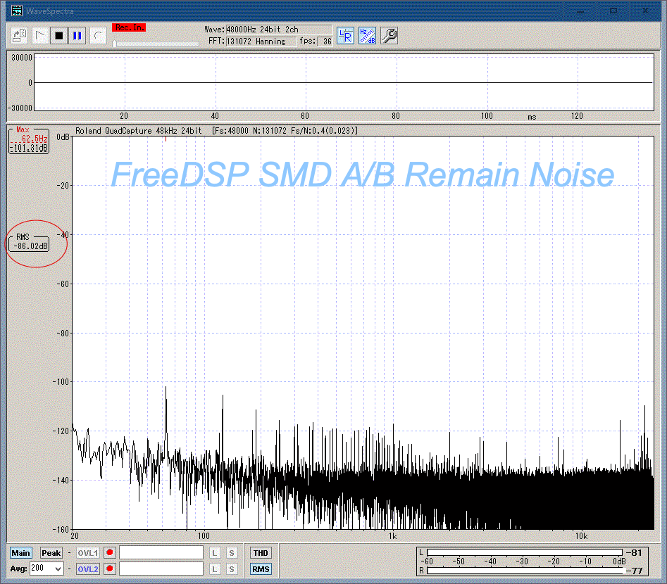

DSP408 Actual Performance Checked

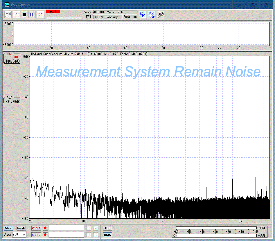

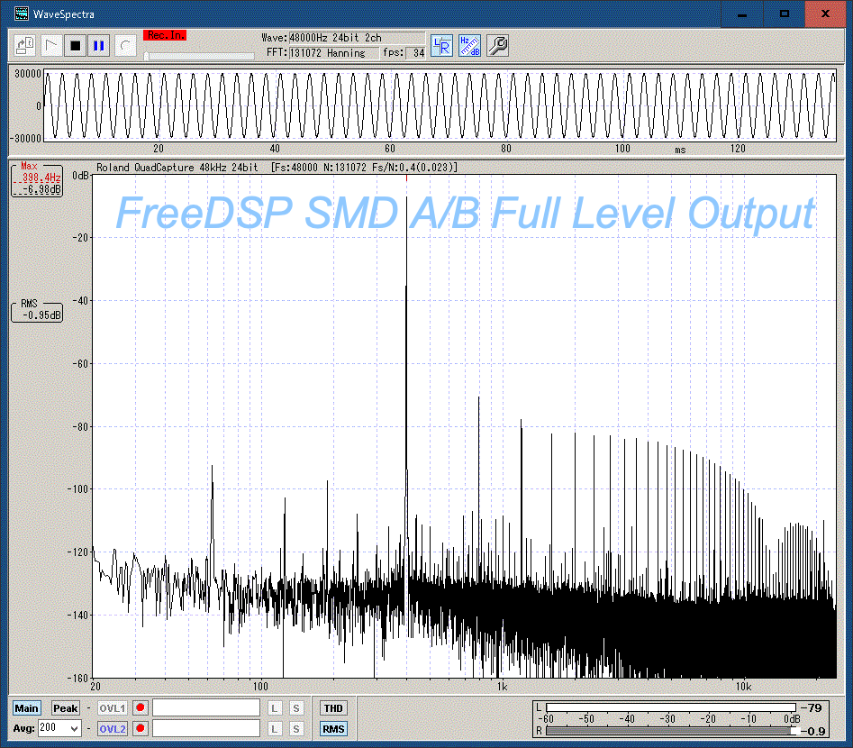

Hi Frabor-San,
I have DSP-408. So I checked the remain noise spectrum.
I used Roland QuadCapture USB-Audio I/F. Sorry, this device has a lot of distortion (Soft Clipping H/W). As a matter of fact, we can not know the sound fidelity but it's enough to see the remaining noise level.
I also attached FreeDSP SMD A/B Board measurement results, so you can compare the characteristic differences.
The attached figures are as follows...
1. Measurement System remain Noise
2. DSP-408 FULL LEVEL OUTPUT
3. DSP-408 REMAIN NOISE
4. FreeDSP SMD A/B FULL LEVEL OUTPUT
5. FreeDSP SMD A/B REMAIN NOISE
Now I can say the ADI specification is real and Non-Weighted.
DSP-408 remain noise level was almost close to my FreeDSP SMD A/B.
I wonder Dayton's specification (≥115dB) is missing some important condition(s) note such as A-Weighted, CCIR-Weighted or Muting, etc...
Additional information:
FreeDSP SMD A/B is my design. It designed as Unity-Gain and 2Vrms I/O. Inverted phase DAC output filter design.

Hi Frabor-San,
