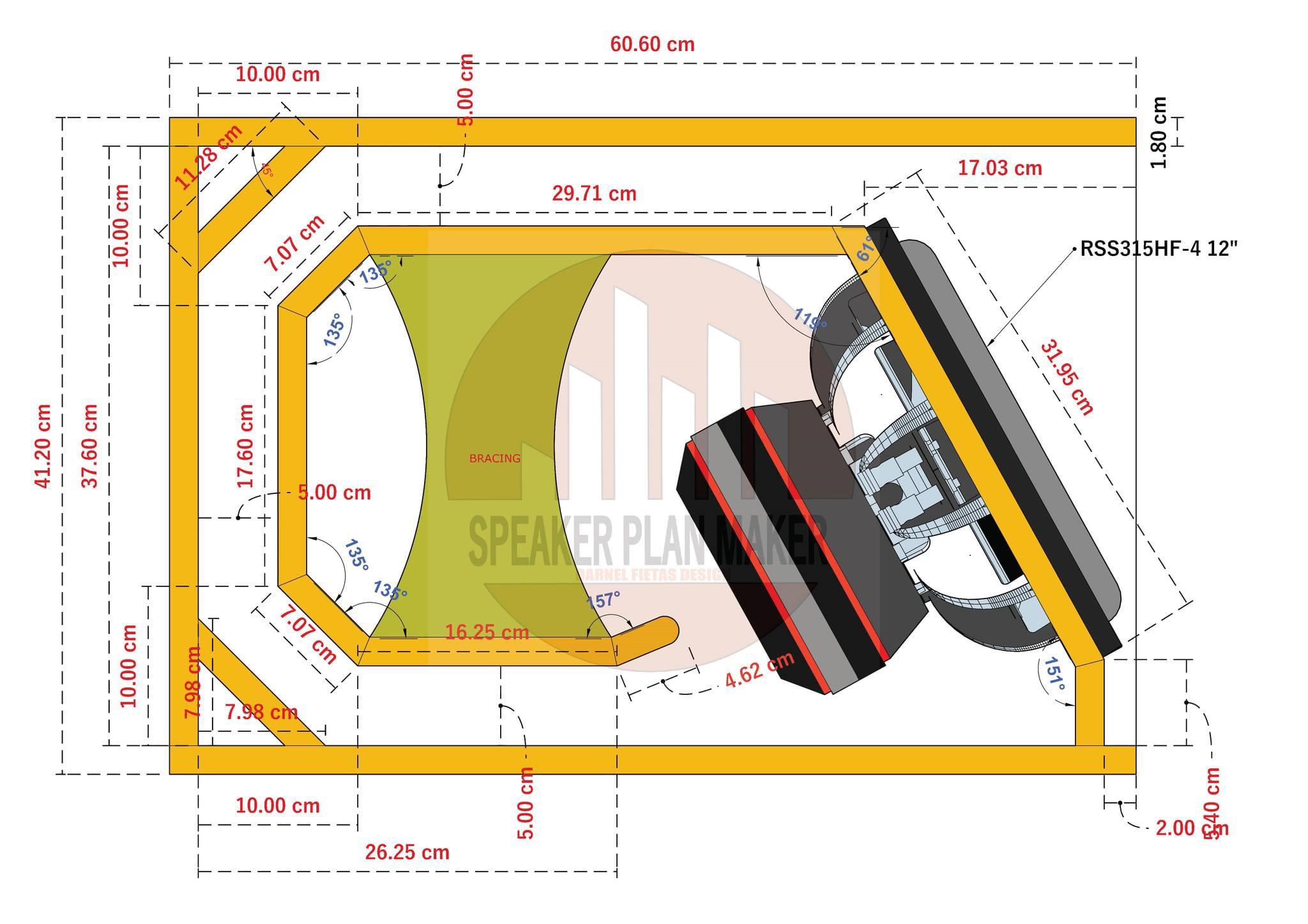

I've just finished modelling and drawing up a vented enclosure for the Dayton Audio RSS315HF-4 12" Subwoofer.
Can anyone give me a critique on the design or see if I've made any errors?
I've modelled it as an 80L vented enclosure, tuned to 24.35 Hz with a 200w input signal. The amp is a 500w BASH plate amp. I'll set the HPF to 20 Hz.
I've read in some forum that the driver displacement is 3.8 L but no idea if this is correct.
Any input would be greatly appreciated.

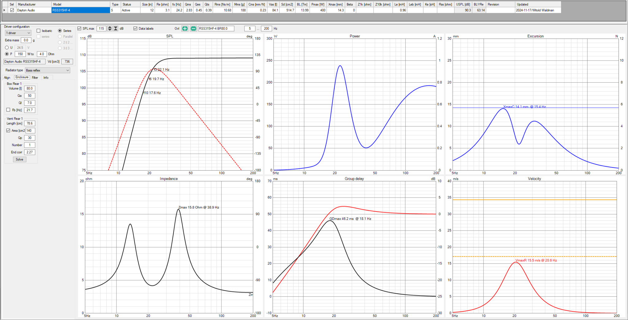

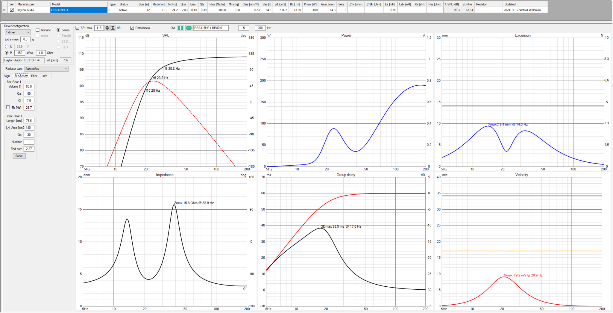

I created a VituixCAD model of this driver in your vented box. The results are shown below and are quite like yours in many respects. I adjusted the input power to correspond to 150W re 4ohms to achieve a maximum cone displacement of 9mm at about 32Hz.I've just finished modelling and drawing up a vented enclosure for the Dayton Audio RSS315HF-4 12" Subwoofer.

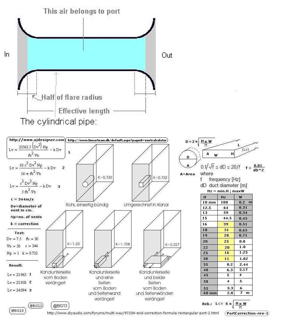

You will notice that my computed SPL response curve sags a little compared to the one produced by your simulations. That is due to the lower tuning frequency of Fb=21.7Hz, which results from using a vent end correction of k=2.27 instead of k=0.732. The value that I used is the best one that I know of. Maybe someone else can chime in and confirm this value or propose a different one. Here the low-frequency cut-off point is f3=27.1Hz.

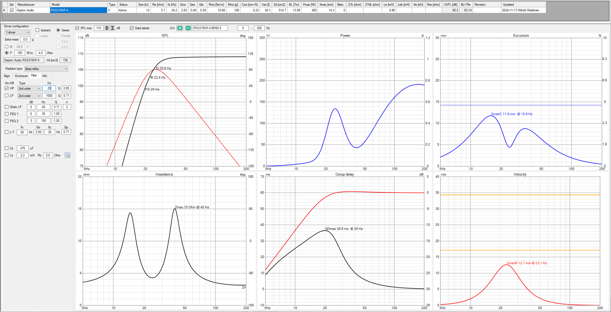

You mentioned that you intend to use a 20Hz high-pass filter. The results look like the following with a 2nd-order Butterworth 20Hz high-pass filter added. The displacement below Fb is considerably reduced, and the low-frequency cut-off point is still quite low, being at f3=30.8Hz.
With a little bit of EQ at around 20Hz, say by adding a 2nd-order 20Hz high-pass peaking filter with a Q=0.85, it should be possible to achieve the result shown below. The displacement peak below Fb is only increased slightly, while the low-frequency cut-off point has been significantly reduced to f3=25.6Hz. That's a 5Hz reduction, which would be quite worthwhile in getting the best performance out of the driver in this size of enclosure.
There was an error in the previous simulation that included the use of the peaking high-pass filter, as the model used k=0.732 instead of k=2.27 as the vent end correction factor. Apologies for the oversight.
With k=2.27 and a 2nd-order 20Hz high-pass peaking filter with Q=1.20, producing a boost of about 2.4dB at 25Hz, the results of the VituixCAD simulation are shown below. The low-frequency cut-off point is now f3=22.1Hz, and the driver's Xmax is reached at 15.4Hz. Note that very similar results could be achieved by simply applying a parametric EQ of 4.6dB at 20Hz with Q=1.20 on top of the 2nd-order 20Hz Butterworth high-pass filter.

I don't like slot vents, especially those as wide and narrow as you have shown. You would likely be better off with one of these on either side of the enclosure, for vibration cancellation. This way, you won't have any any problems with vent chuffing.

A slot port does not compare favourably with a round one, its area is pretty small, and the length to area ratio is very high. (If it's limited by what you can fit in the box, fair enough...).
No port shape compares favourably with a single round port!

With the slot port, do he dimensions matter if the air velocity remains below 17.5m/s?

Round is certainly the most efficient, but for those of us that prefer moving towards aperiodic, the high aspect ratio ducts are the way to go. 😉
The only issue that I can see and others have addressed is the ratio of the slot port. Simulation programs will only get you so far with the behavior here. A stead fast rule for slot ports has been a ratio of no more than 1:8 which is about the threshold for laminar flow of air.
My suggestion would be to reconfigure your drawing/plan including a suitable length and cross section port to give you your desired tuning. Don’t sweat the small stuff…..if your off a liter in displacement or 5% of the port calculation, that’s well within the variance of the system overall.
Your drawing doesn’t show any internal bracing?……..I’d add at least one window brace spanning top to bottom and side to side. Two would be better of course. And don’t forget to line the inside with a suitable wool/fiber material. Enjoy!

That driver in 80L performs well. I would just change to a round port and do the final port length tuning by measurement after it's built. I always make my ports removable initially to make adjustments. Your port has 2 curves and a poor aspect ratio which will perform worse than the good ol pvc pipe.So should I build this box? After correcting the port length for the radius of the internal flare?
I'd go with 4" round port as long as you can fit the pipe length of about 45cm. Much easier to built and flexible to tune. Just keep in mind this pipe will resonate at around 390Hz (you can use a LPF to cut before) and will take about 3.5 liters from your box.
