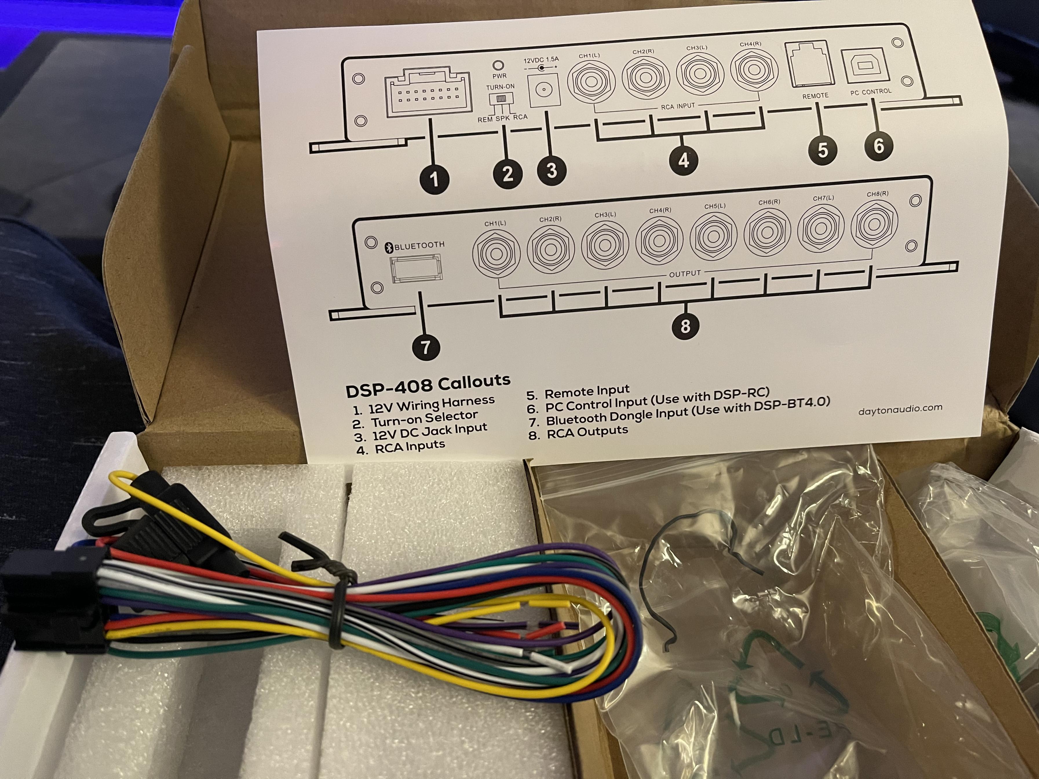

Does anybody have any knowledge of these? I see you can run high level straight into it and then out rca? So can I run in two speakers (3 ways) and out the 4 inputs into an amp?
I’m basically trying to put this before an amp so I don’t have to use individual power for each speaker driver. Not sure if this is possible or not?

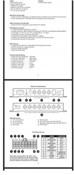

Here’s the manual for it.
https://www.daytonaudio.com/images/resources/230-500-dayton-audio-dsp-408-manual(2).pdf

This doesn't seem to have high level outputs for driving speakers.
Isn’t that what this wire harness is for? Connecting speakers directly into it then out rca? I’d imagine the voltage is higher connecting to this harness compared to rca.

Yes, but look at the high level input impedance. This is looking for a signal voltage to drive low level electronics. The output impedance spec also shows this wasn't meant for driving speakers.Isn’t that what this wire harness is for? Connecting speakers directly into it then out rca?

Are you asking if you can place the DSP between the amplifier and the speaker?
I don't know what would happen or how far you could get away with it if it worked. Contact Parts-Express customer service and ask them.
Yikes, i hope that's not the idea....
You'll blow the holy hell out of it between amp and speaker..

The manual states:
High-level Inputs: The DSP-408 features 4 high-level inputs which are most commonly used in car audio applications from a stock radio. When using the DSP for this application, switch the turn-on selector switch to “SPK” mode.
It adds that maximum high level input is =< 8 volts.
It seems common use would be pre/line stage out (or integrated amp receiver with pre outs & amp in) to the DSP-408, then out to as many as 8 channels of amplification.
