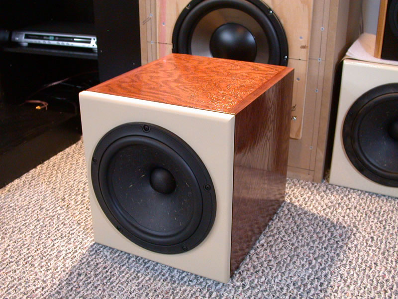

I've used the 15 inch, 500 watt Dayton RSS390HF-4 15″ Reference driver in a sealed sub, and I can say it's very nice indeed.
You can see my sub in the System Pictures gallery for subs.
