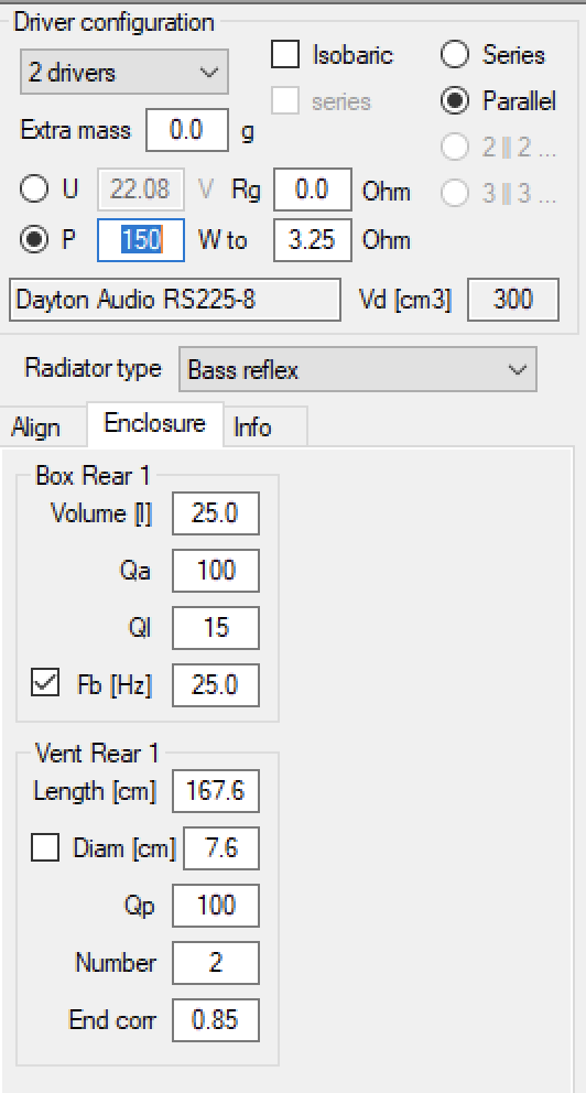

Ok, beginner here with limited experience. I have a pair of Dayton PS180-8 and a pair of RS225-8, looking for advice on how to best employ them. At one point I had the PS180's in a simple vented enclosure based of Dayton audio recommendations and they sounded descent. No low and a little harsh on top end. After reading some post I see a notch filter should help. Any ideas would help.
Real question is is it possible to make a fast system with them? or does it even make since. Looking for quality sound with good low end.
Dayton RS225-8 + the PS180-8?

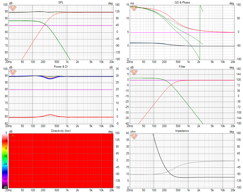

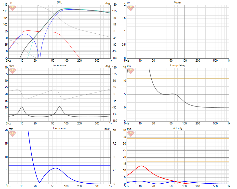

I played with crossover in sim.
Once you smooth out the PS180
it will average around 94 dB
So adding in the 86 dB 8" woofer
requires a lot of padding to make it work.
Basically likely 180 dollars worth of crossover parts.
to get a response similar to many 8" fullrange speakers.

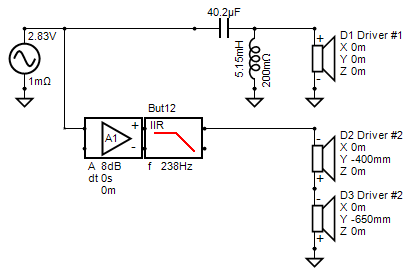

I would just run the series notch on the fullrange
to balance the sound.
And call it a day.
Bass wont improve, but wont be hidden
by the 105 dB highend.
So bass actually will sound better
since the speaker is being balanced to
around 94 dB
Likely use the Reflex you already have
and smooth out the highend with the series notch.
easy and low cost with such a small inductor.

Basically for a passive solution.
The 8" woofer is only 86 dB
So padding resistors are added to the fullrange to get a response match.
You would be padding around 8 dB.
Using a fullrange, then adding assistance for bass has been done.
Since you already have the woofers. just find a fullrange with a better sensitivity match.
Great thing is usually a 3" fullrange will be around 84 to 86 dB
and a small 3" has smoother top end.
So a good match for a 86 dB woofer.

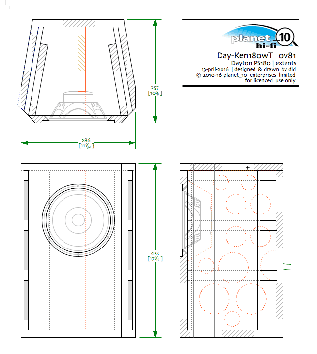

Fostex FF85wk, Mark Audio Alpai r5.2/3 (or CHN-50 on a budget) are my favorite 3”. The rumoured MAOP 5.3 is probalby a real gem.a 3" fullrange will be around 84 to 86 dB
ABout 86-87dB. Make really good midTweeters.
Here FF85wKeN used with a pair of Silverflute W14eN. Large choice of woofer impedance and series or parallel give a whole lot of sensitivity choices (2 4Ω in series here, no padding on the mT)

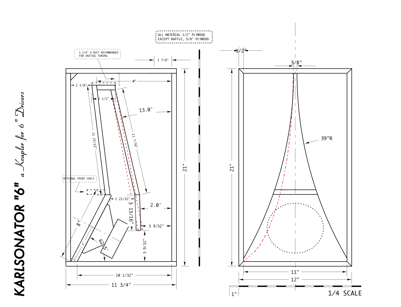

Oh yeah.
Perfect.
I'll be the first to admit.
Hearing with your eyes, can make accepting the side mounted woofer
a bit tough at first.
Once you accept the form factor and realize it maintains
a narrow baffle, and as a tower gives plenty of volume.
Great design.
after you model/measure the woofer response.
love it even more.

An ML-TL with F10 about 35 Hz anechoic. Pretty much omnidirectional up to above the 450 Hz (passive) XO.… as a tower gives plenty of volume.
