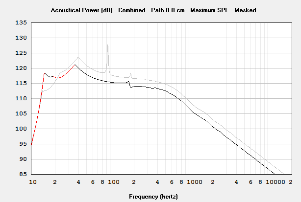

??? Thought I deleted this message as the sims were different pi space! Anyway, UM/580 W Vs SI/750 W 2pi
Could you explain the graph a little? I'm not sure I understand it and why you are using 580w for the UM and 750w for the SI.
Also, I can't tell if you are being sarcastic or genuine about the SI blowing the doors off the UM.
In sealed boxes of the same size, say 6cuft, or ported boxes of same size and tuning, say 10cuft tuned to 20-22hz, and fed a max of 750w will these two drivers perform in a very similar way? I love the look of the UM cone and frame, but if the sound is no better than the SI and I don't really need higher power handling capabilities then I'm not sure if the UM would make sense. It really stinks, though...I guess should have bought one 10yrs ago when the old specs applied.
The red part of the trace is where the UM is exceeding its Xmax @ 580 W in a ~892 L/15.5 Hz Fb T/S max flat vented alignment, ergo down low the UM is limited to a useful 580 W Vs the SI's 750 W rating in a 270 L/16 Hz EBS vented alignment except over a very narrow 'peak' in the 10-20 Hz BW, so really doesn't count in the 'scheme of things'.
As I noted, I posted it before realizing it was an 'apples n' oranges' (invalid) comparison due to differing pi loading of each (half space Vs 1/4 space) and thought I had deleted it, so in retrospect guess I should have had a mod delete it (reported it just now to save any future confusion: edit, at this late date they chose to leave it as is).
In the above vented alignments; at > ~580 W the UM will exceed Xmax below ~35 Hz and by ~17.5 Hz will be 4x over and by ~8.75 Hz will be 8x over, so somewhere along this BW it will bottom out and assuming it's like drivers I've seen self destruct long ago it will 'grenade'/burn up/spit out pieces of voice coil, maybe set fire, hurt someone and/or property, etc.; the SI OTOH will produce significantly less peak SPL below ~22 Hz @ 750 W.
So in ~short, none of this was meant to answer your specific questions, just me posting a quick comparison I did for myself to 'highlight' just how different/dramatically these new specs altered which to choose, which at a glance the UM is still preferred for when wanting < ~ 22 Hz output at any useful SPL.

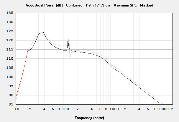

Hammer Sandwich -- if I'm interpreting you correctly, these two are now pretty close in terms of performance in similar sized sealed enclosures especially at the watts that I can throw at them. So, two SI 18 at $400 is a better deal than 1 UM at $290 or even two UM at $580 on a cost-to-performance measure.
GM -- to simplify things, it sounds like you are saying the new specs of the UM make for a substantially larger box requirement as opposed to the old specs. So unless digging below 22hz, just save some money and get the SI drivers. The SI want large boxes, but now the UM's also want equally large boxes.
I have Winisd but am not sure if I am using it correctly. I will try to model both in there for ported boxes, however would somebody better at this stuff be willing to throw some relevant graphs of these two in apples-to-apples boxes of 10cuft tuned to about 20-22hz?
I haven't used WinISD since 2008? once Hornresp was expanded enough to suit me; regardless, UM @ rated max 1000 W (shadow/faint/gray) - SI @ rated max 750 W in 10 ft^3 net/22 Hz Fb comparison (both sims are with 'Le' distortion enabled):

So if ported is out and they perform similarly in sealed, then may not make sense to do the UM over the SI for some sealed enclosures.
Plus, looks like the sale ended on the UM, so they are back to $340 each instead of $290 each. For a mere $60 more than a single UM one can get two SI's, so even with the cost of another full sheet of MDF for an additional cabinet, it seems like a "no brainer" for my wattage, space and dollar budget.
