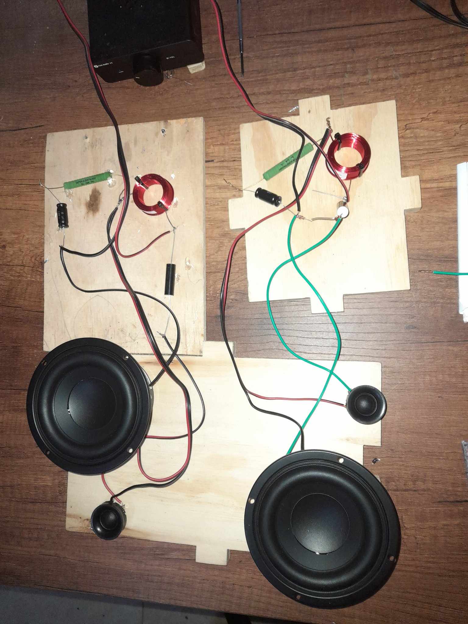

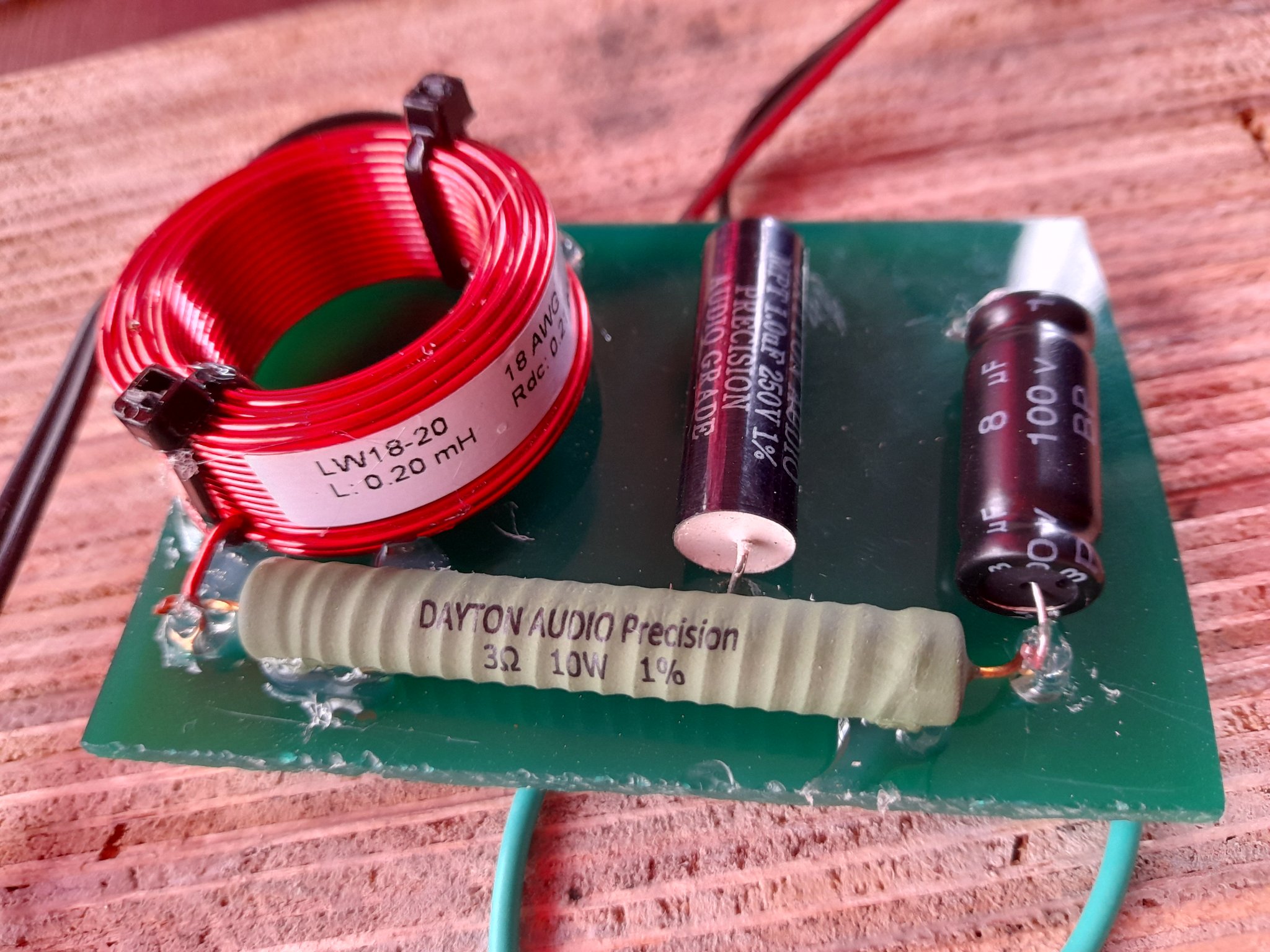

CROSSOVER:
3 OHM 10W RESISTOR
0.20mH 18 AWG COIL
8.0uF CAPACITOR
1.0uF CAPACITOR

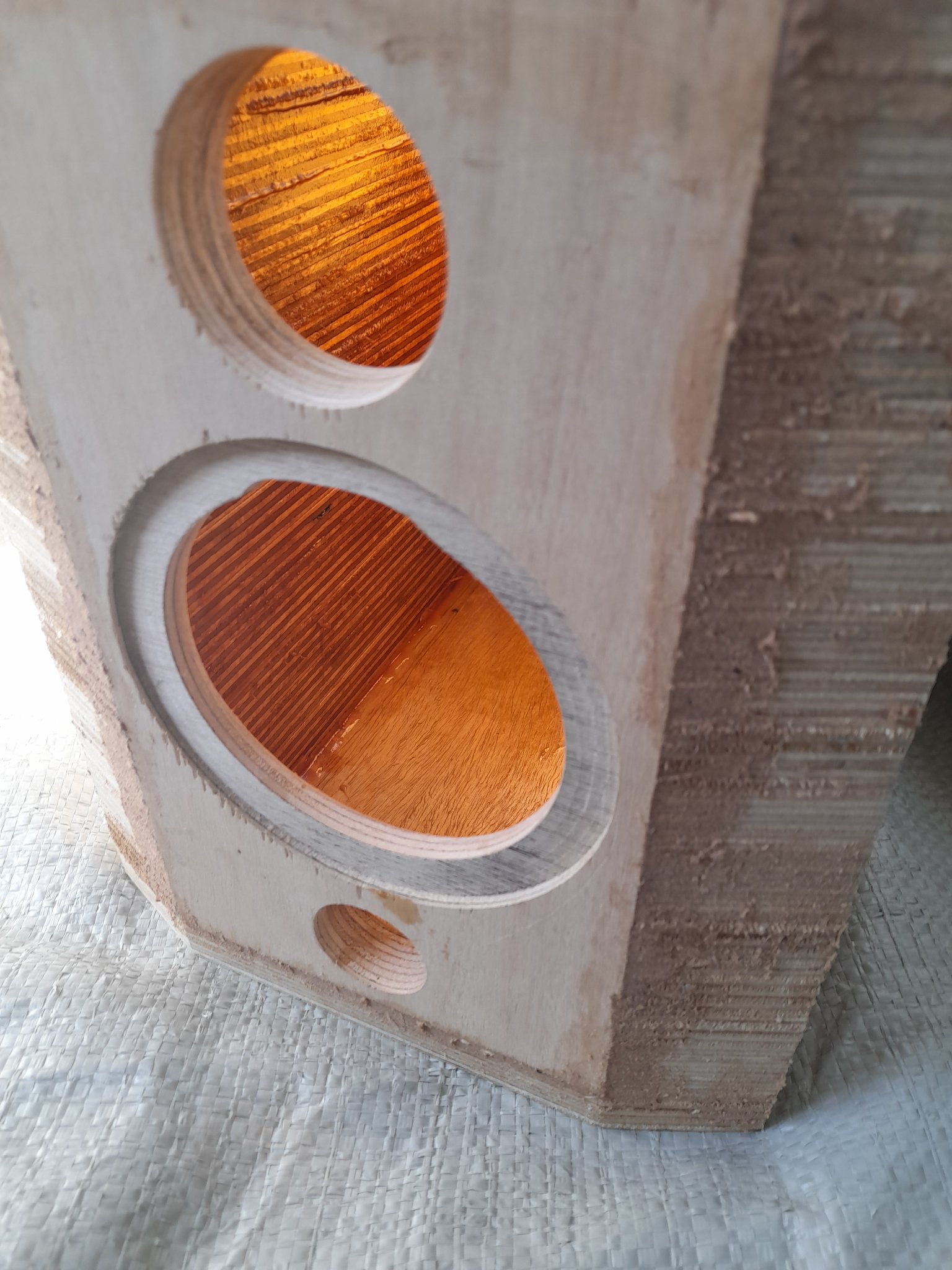

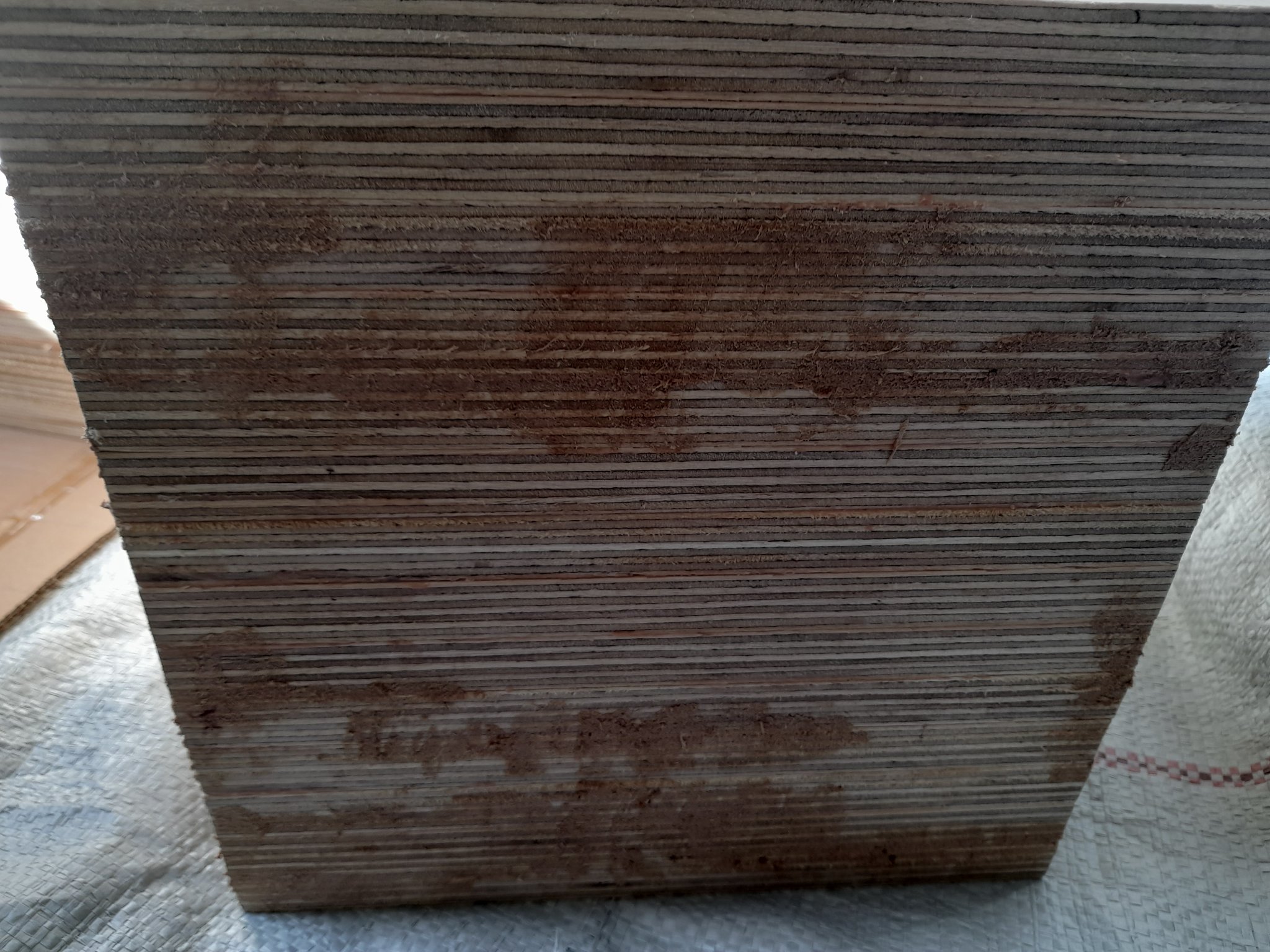

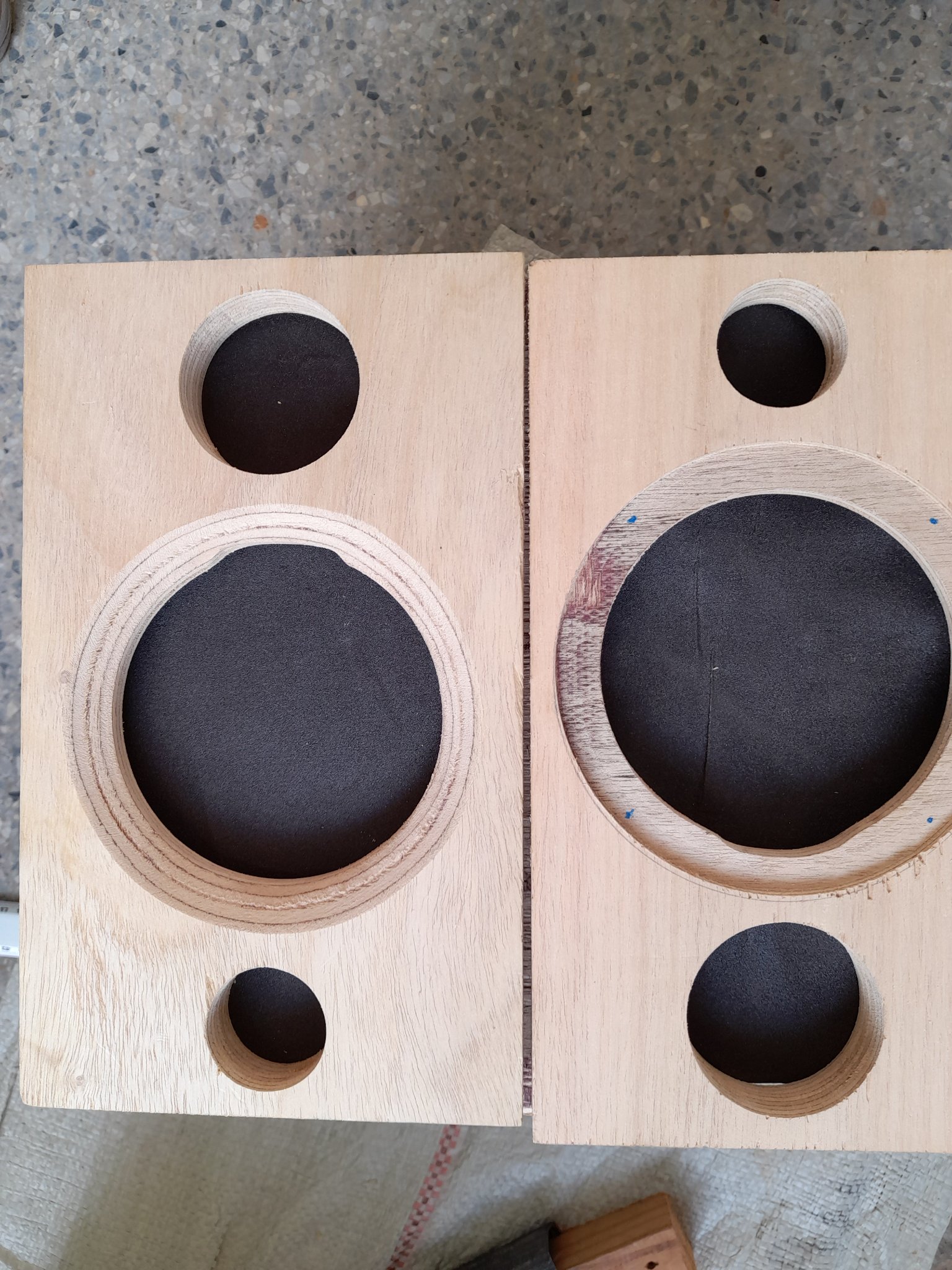

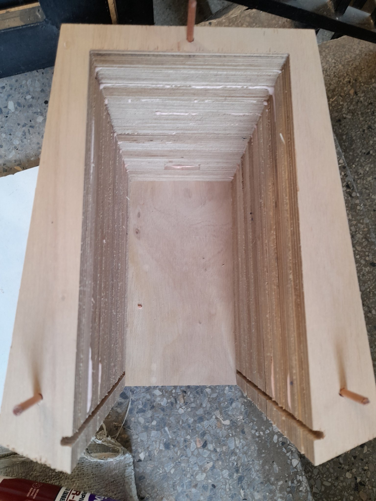

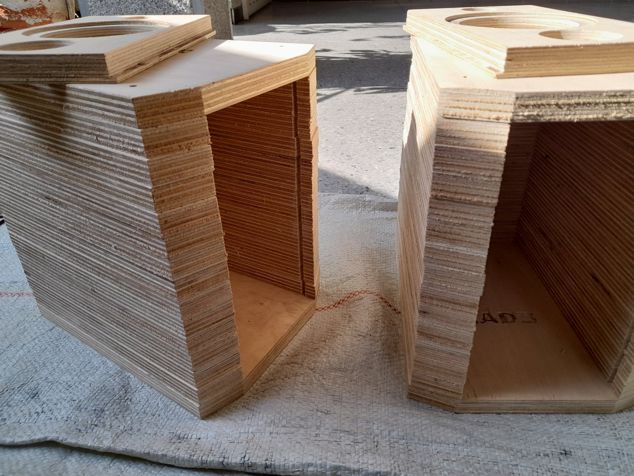

I do changes in the cabinet outside dimensions, trying to apply the theory on Direct Radiator Loudspeaker Enclosures by Olson Harry.. also to impress my Dad on what carpentry with cnc can do now days.. the internal dimension where the same that other builder used on Mr Duane design and call it the ¨Deluxe version¨ as he made it a litter bigger and change the crossover components to polypropylene versions on the capacitors. The original enclosure is 8” tall, 6”wide, and 8.5” deep.

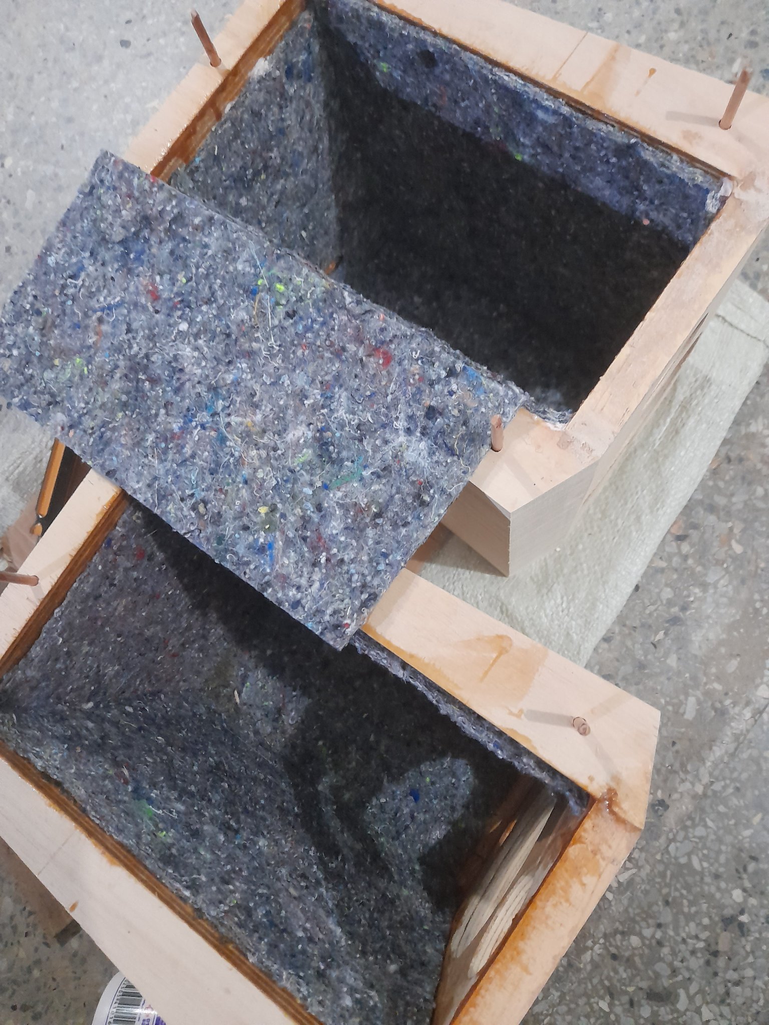

The enclosure material is 18mm pine plywood, lining the internal walls with recycled denim, the material used on car trunks/carpets.
I think i don't have anything more to cover so here some pictures of the build process=

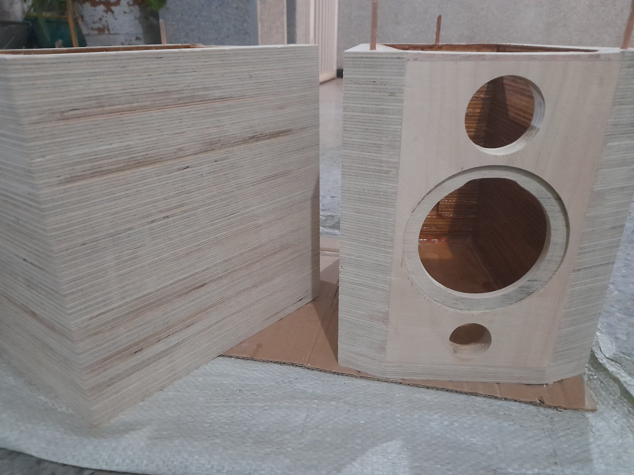

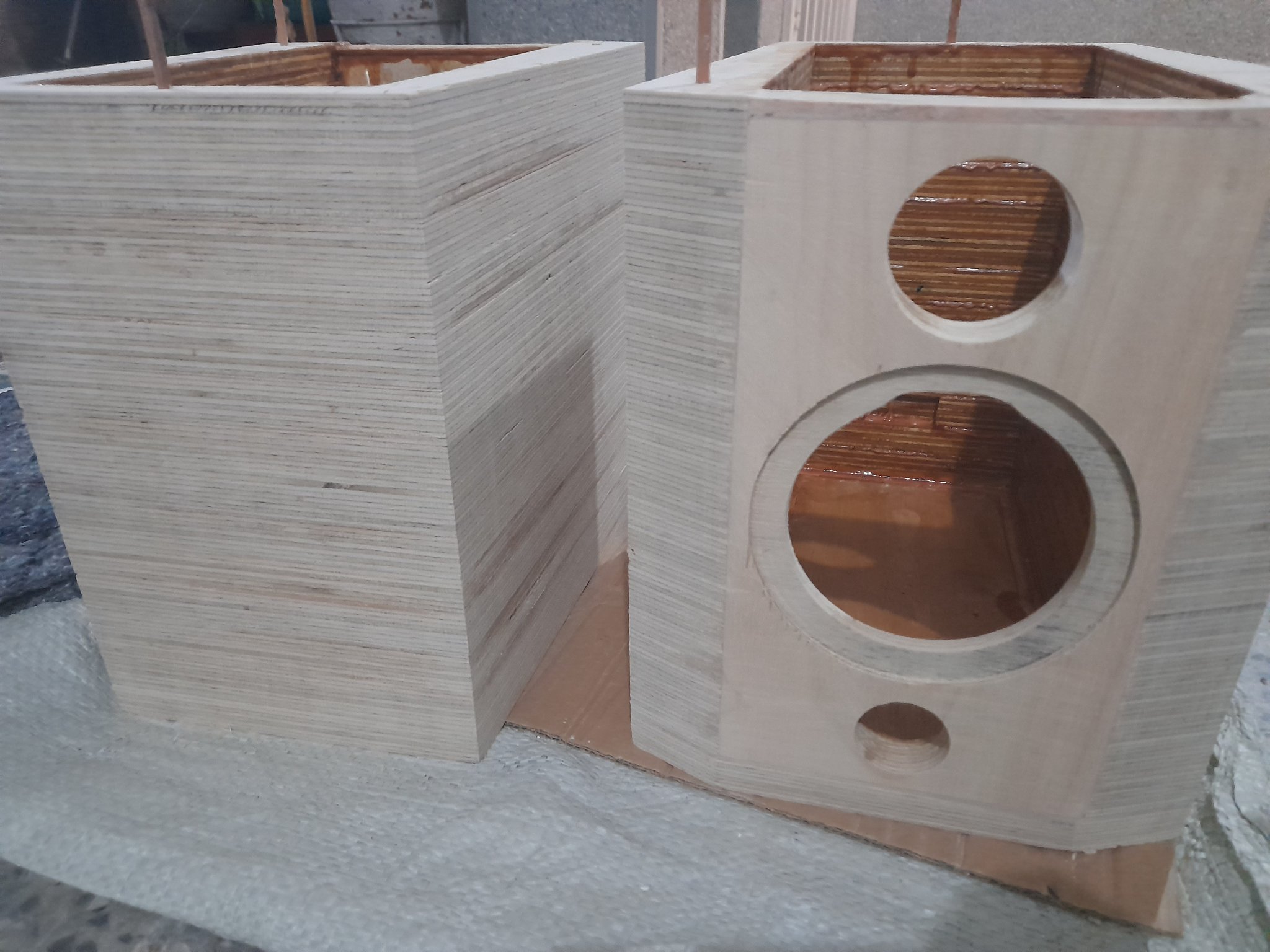

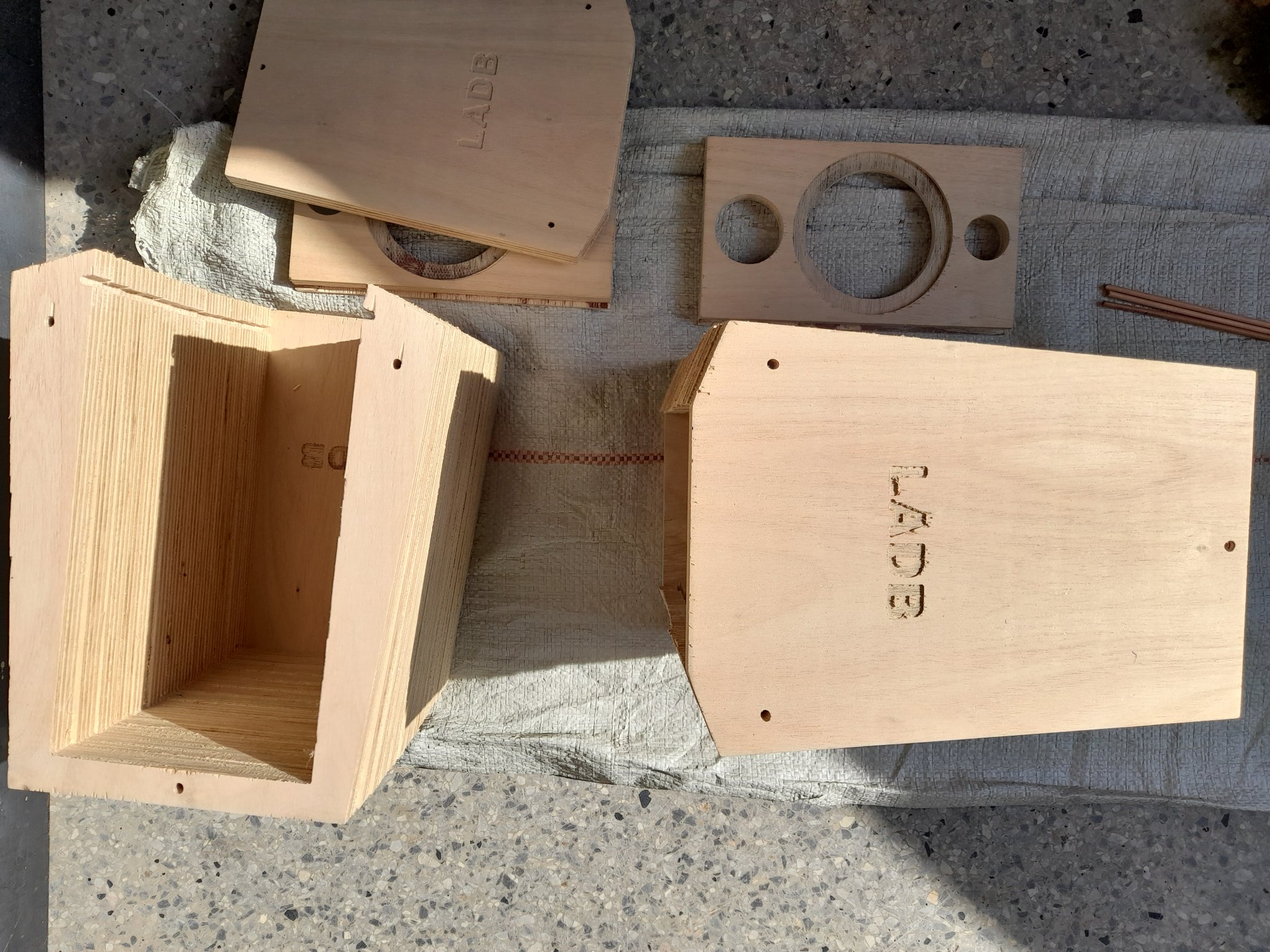

FLAT PACK..To call it in that way

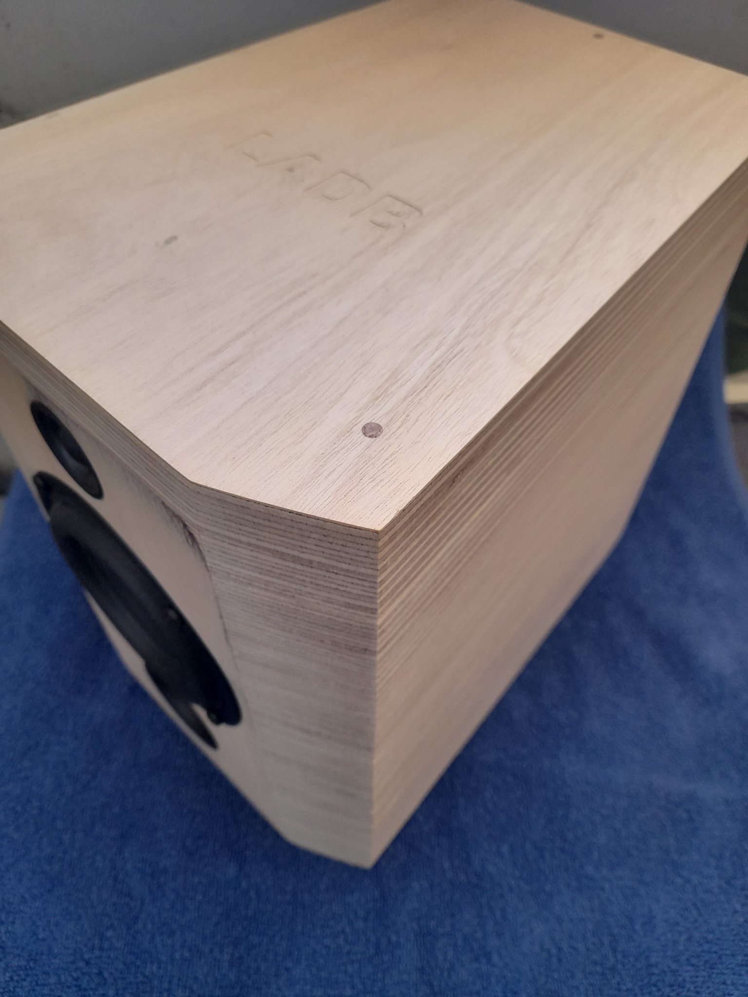

The letters on the top are my dad´s name initial..in case you are wondering
Baffle -- recess cut for driver to be flush mount and release on back to let it flow

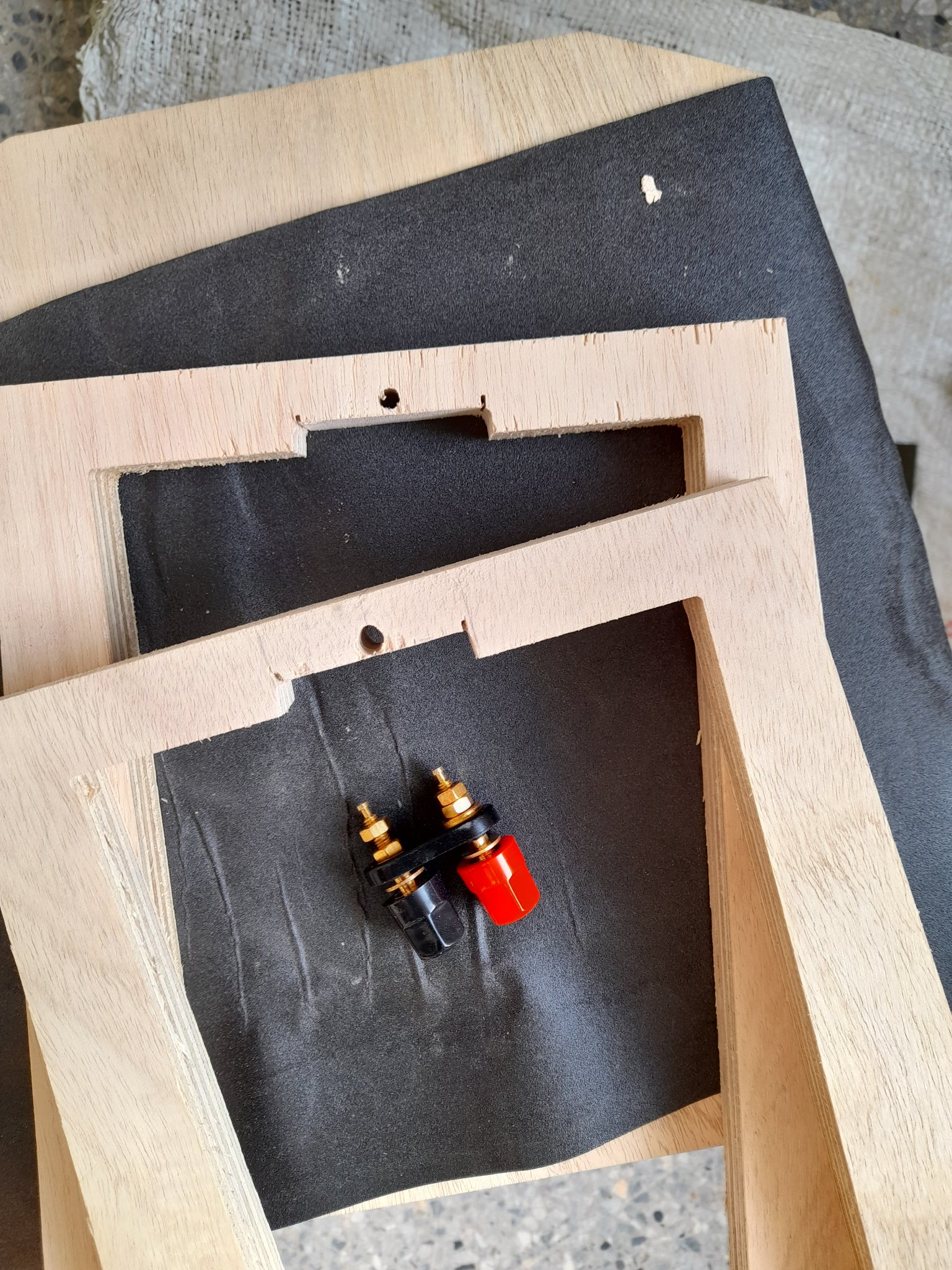

Binding post cut manually done, as the cnc guy ¨forgot¨to do it...not finished in this photo
Glued together - I'm missing a photo with the internal material--next time i post
Crossover assembly - testing - finished

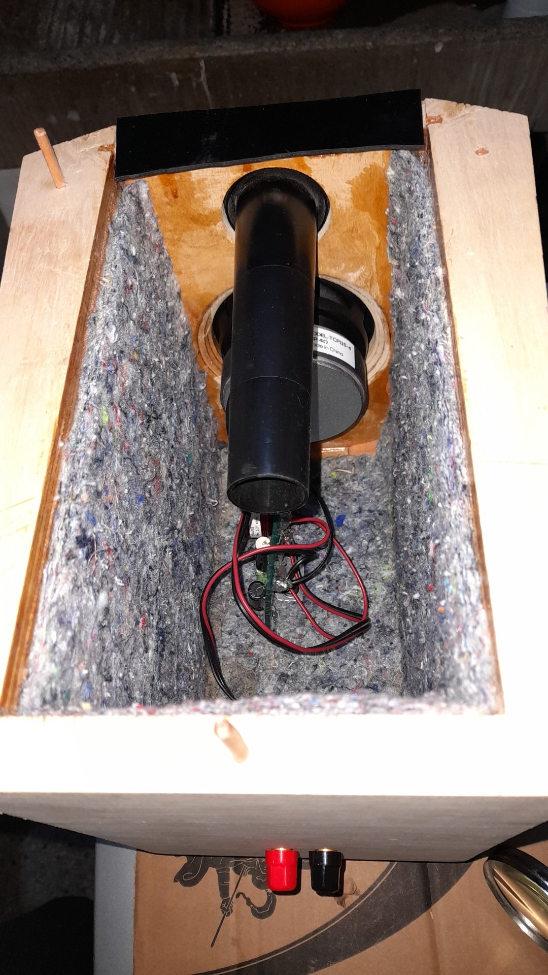

and the Ufoken enclosure with Markaudio CHR-70.3 that i did as my first diy speaker that i want to compare against this 2way design

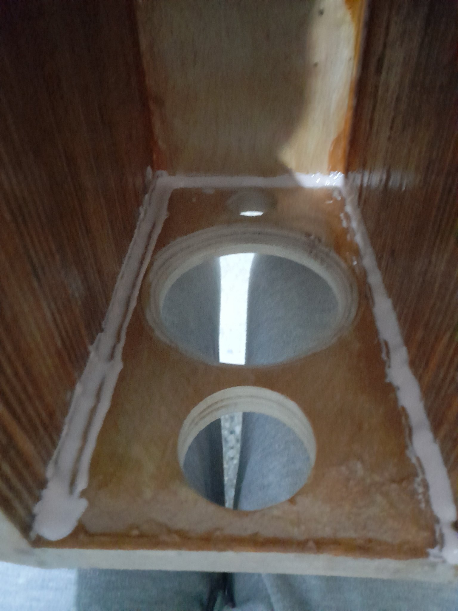

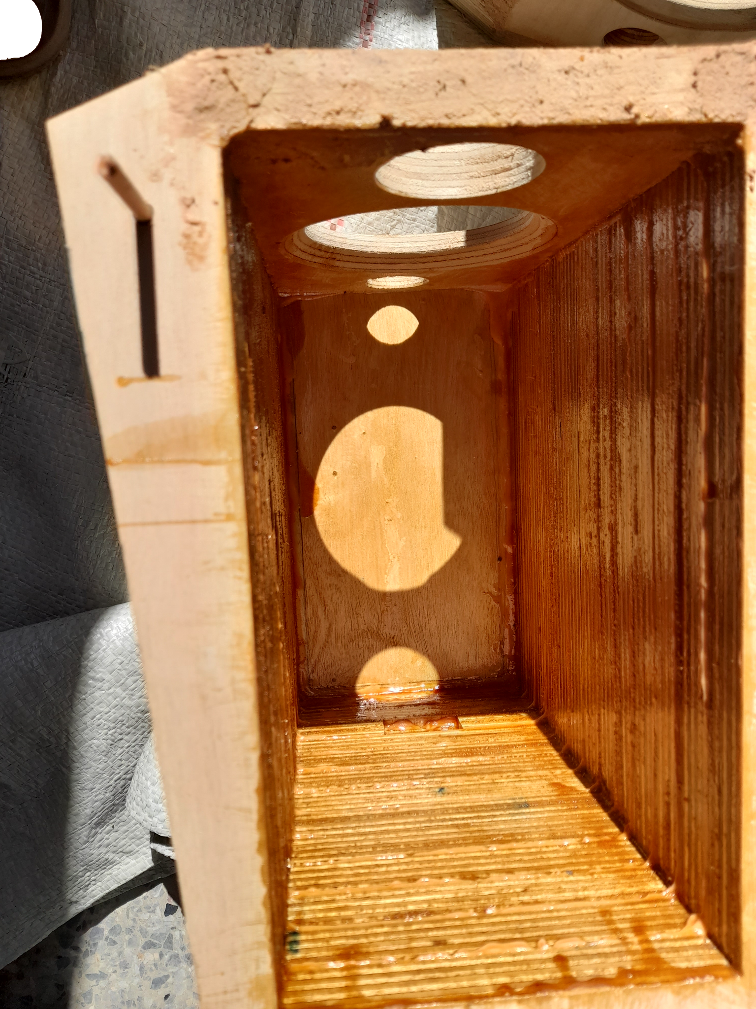

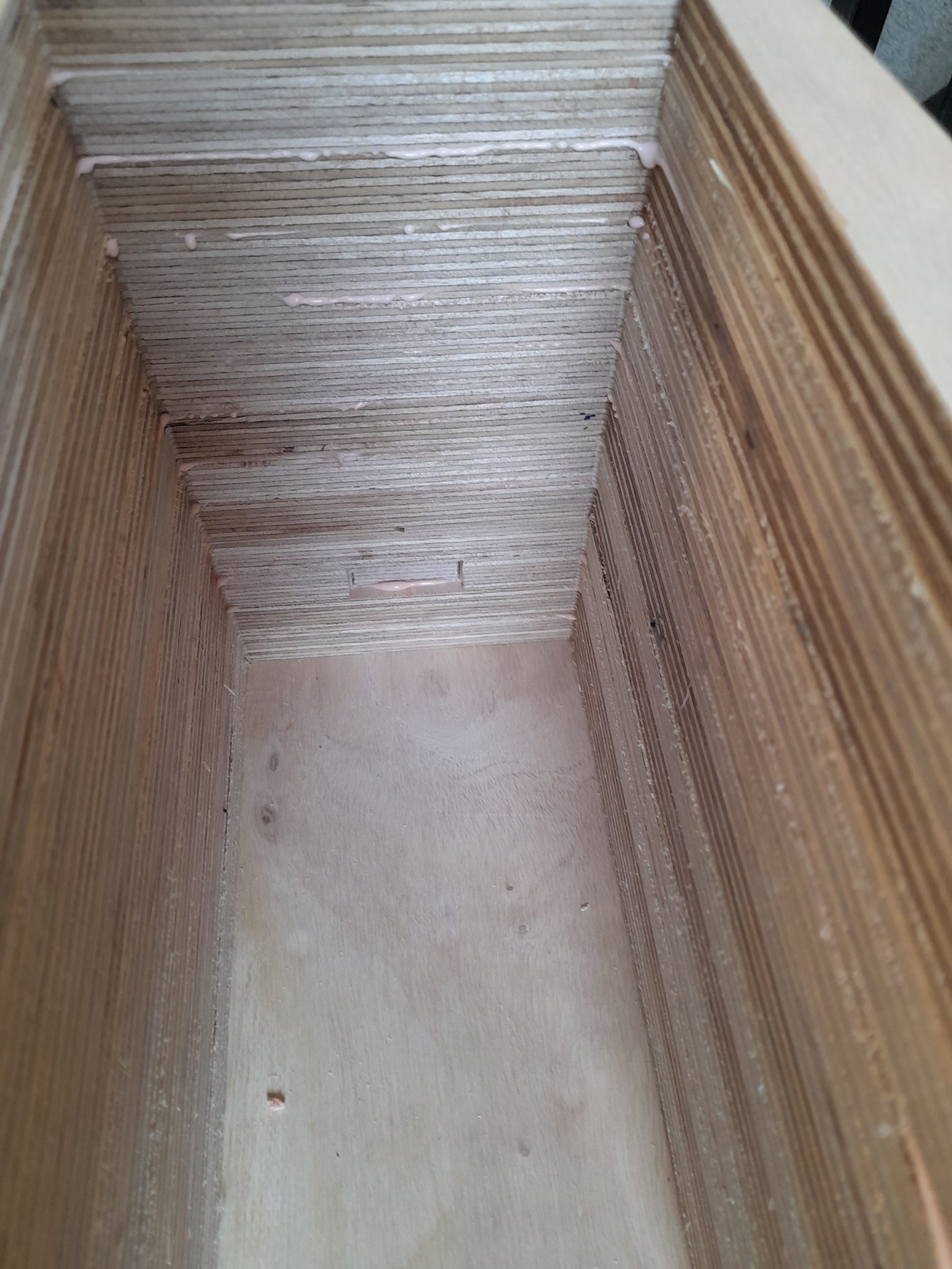

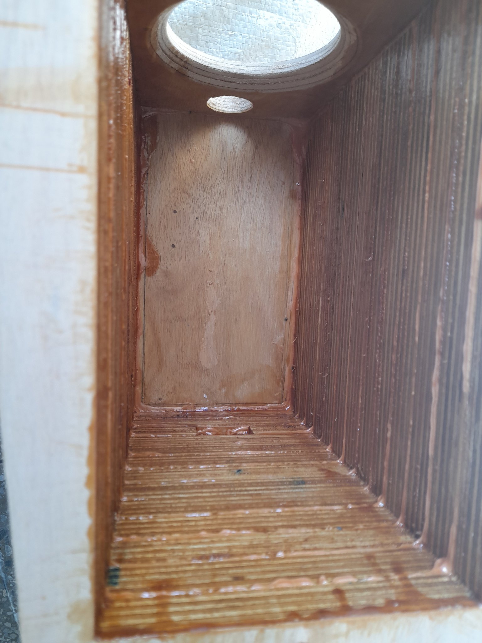

Sealing the internal cornes
After receiving an advice from a good designer …Wolf... I applied about 2 coats of sealant to the internal walls to prevent any possibility of air leaks between each layer of wood. Something that i didnt think before.
A hand/rough sanding after filling in the imperfections.

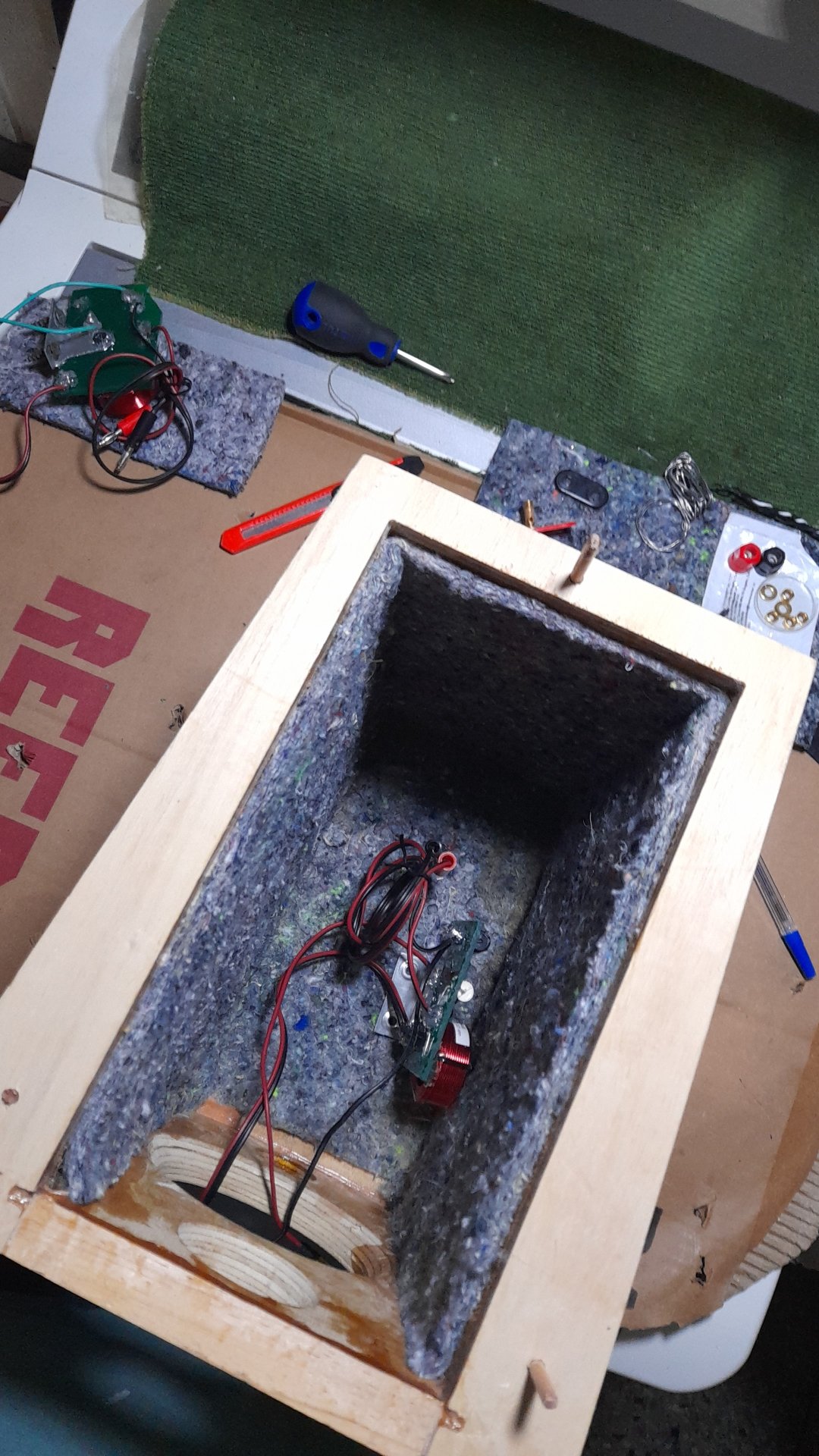

The insulation material is already glued in.

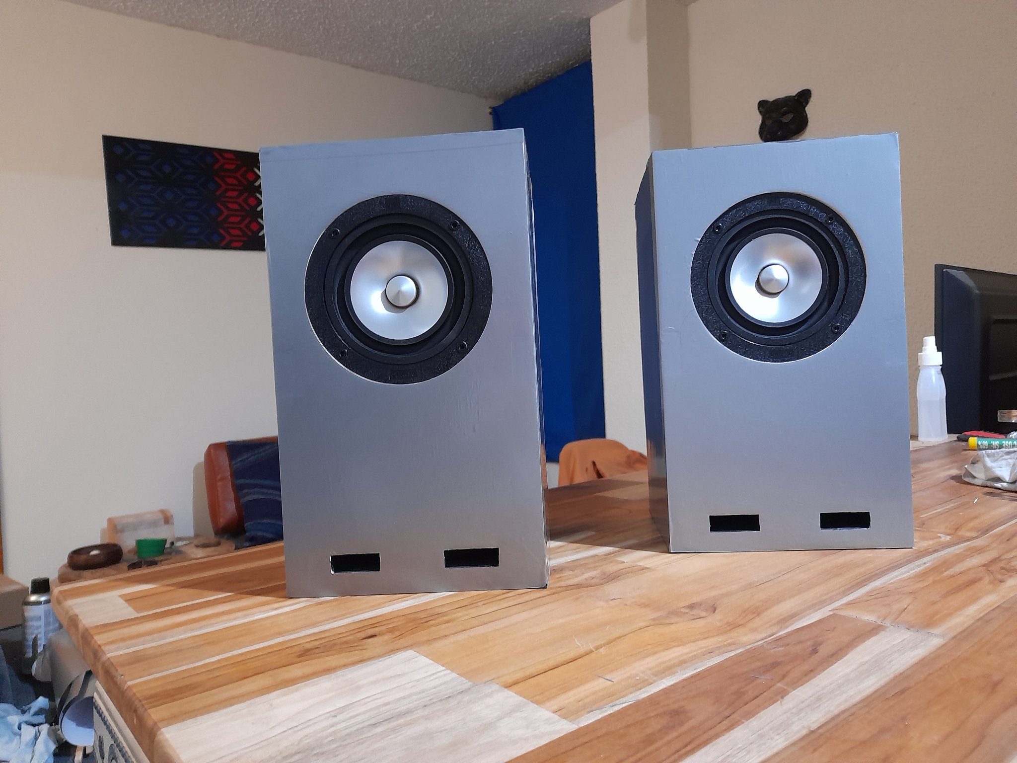

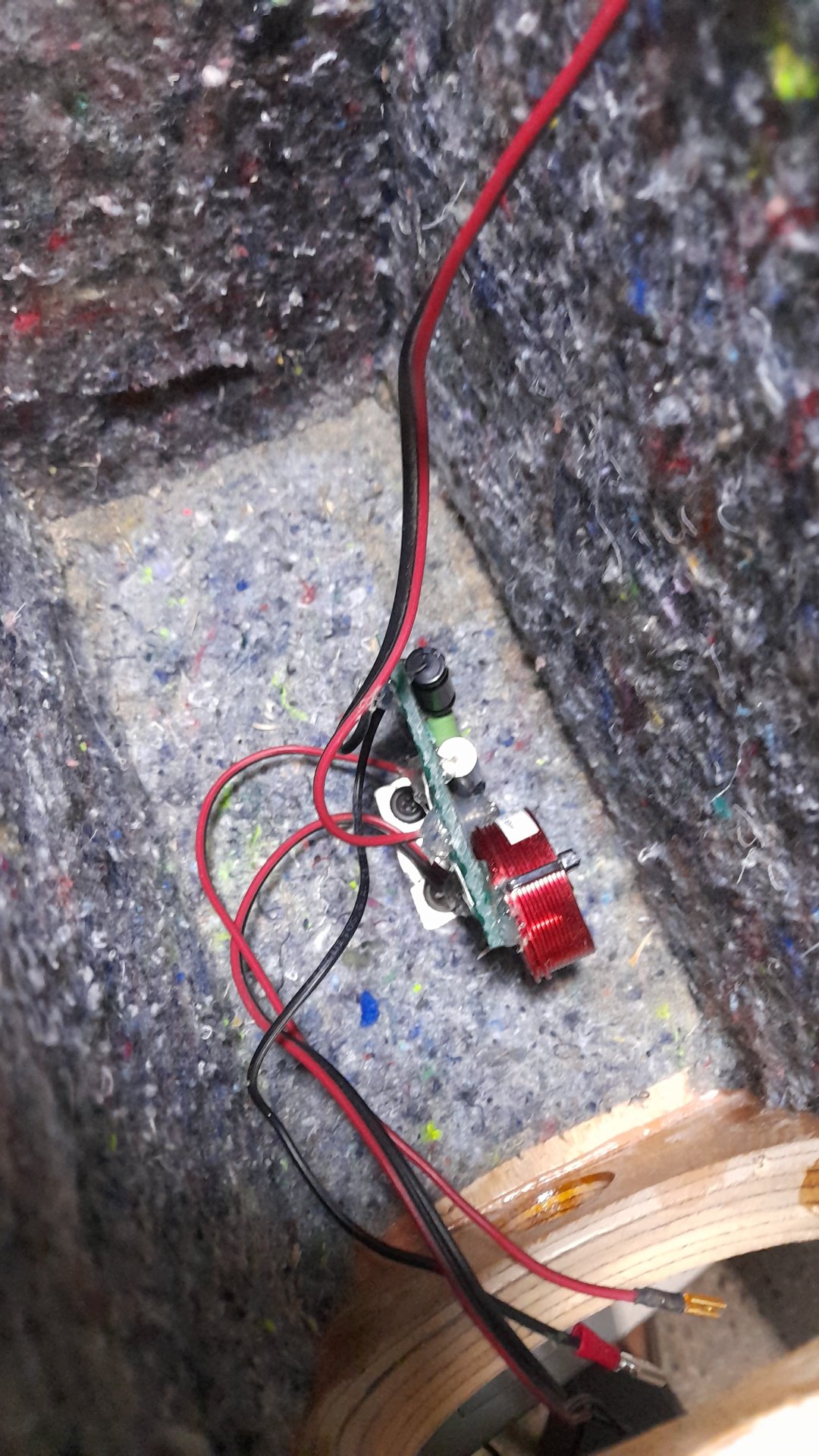

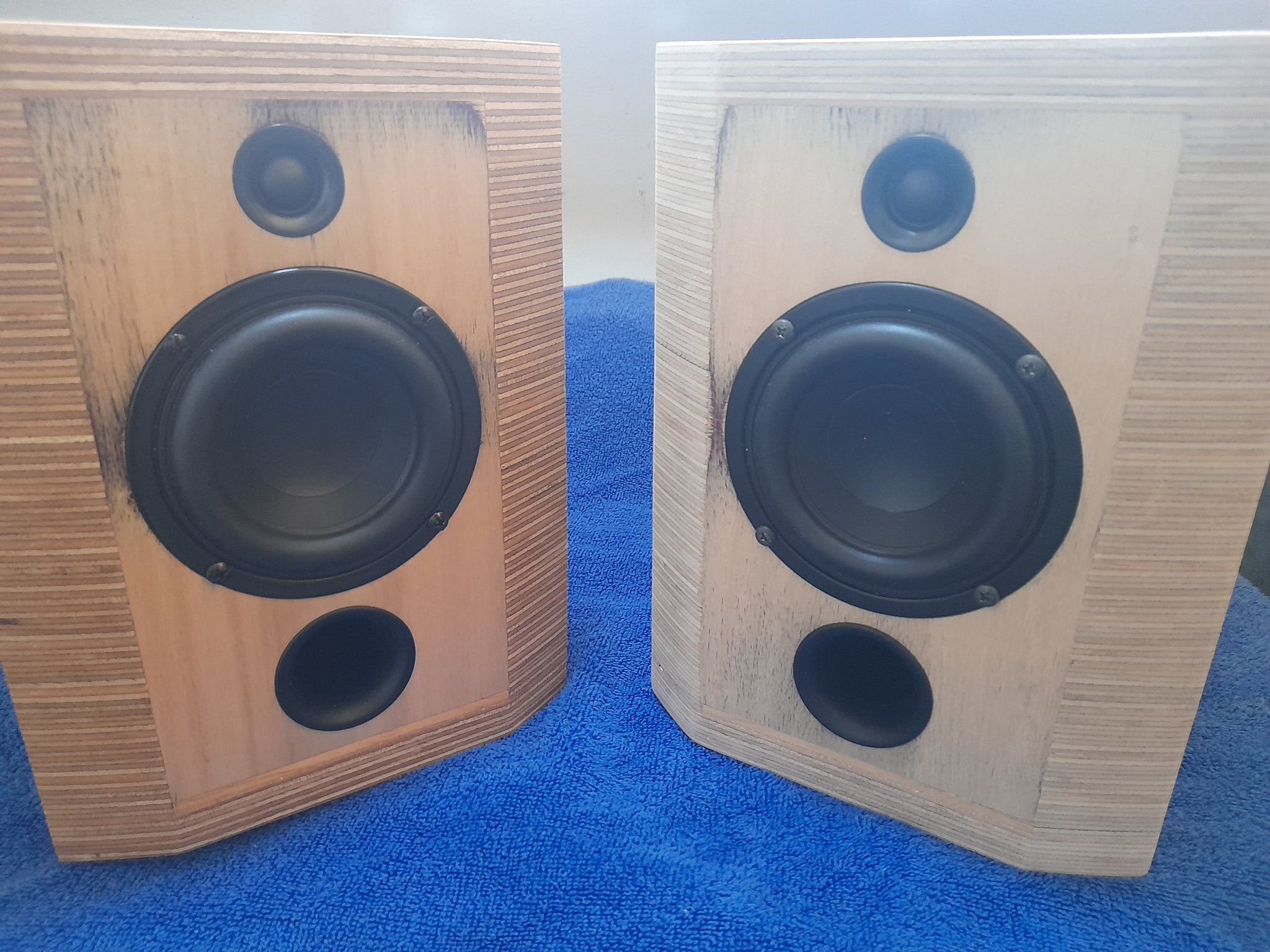

Then proceed with the installation of the crossovers inside the box
Then sealing of the wood after sanding with 80, 240 and 320 grit
And the final coat of mineral oil.
