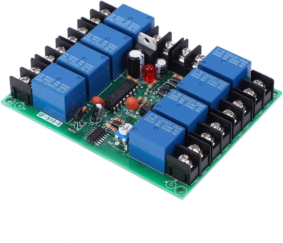

If the DBX does produce the noise, add a muting circuit to the audio output of each noisy channel.
This is just a series resistor followed by normally closed relay contacts shunt to ground.
The relay coils should be directly powered by the AC line.

Unless I find a crossover that will not have a pop on turn off, I will build a box with four DPDT relays and a supply that will allow them to turn off quick.
