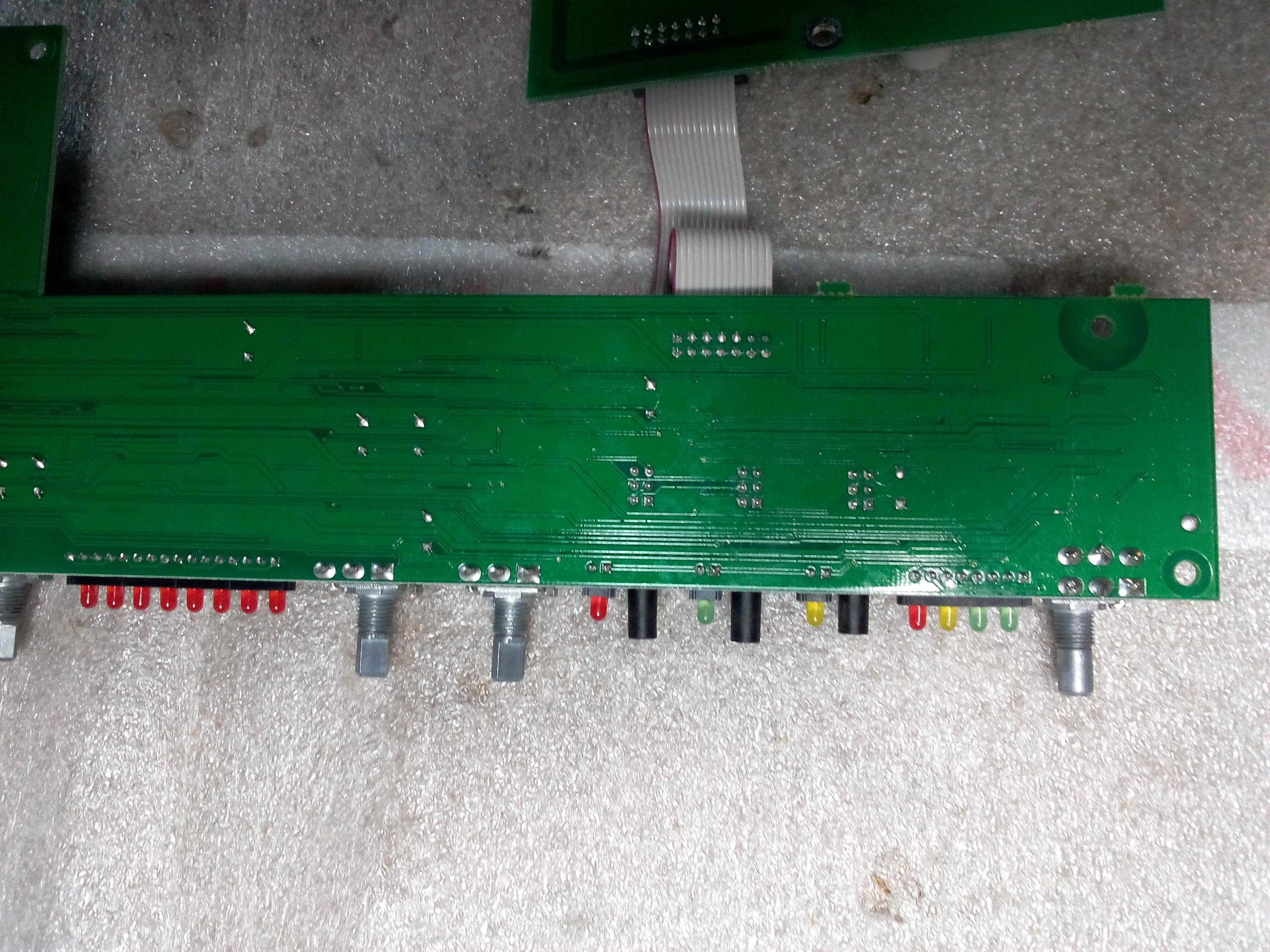

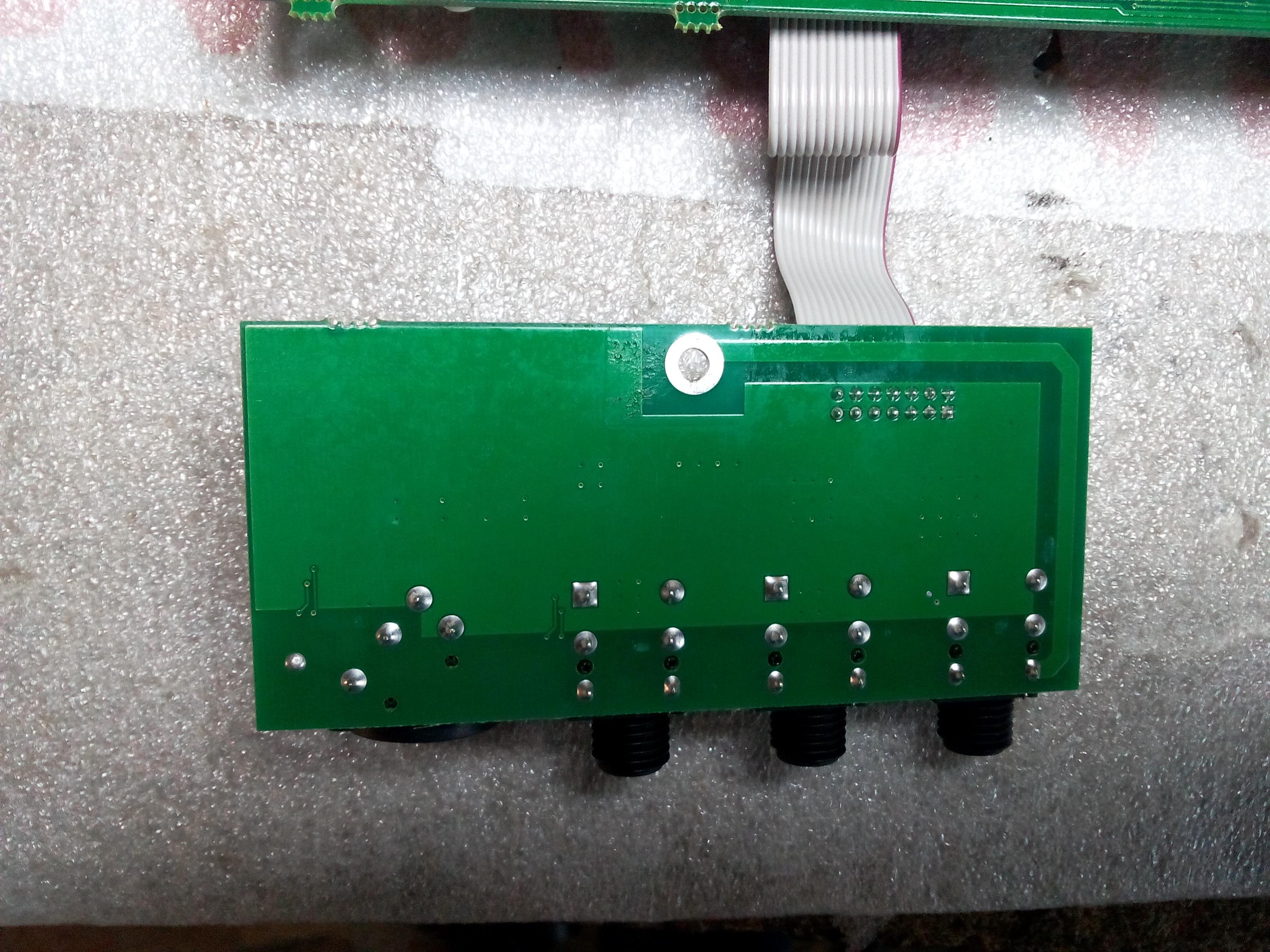

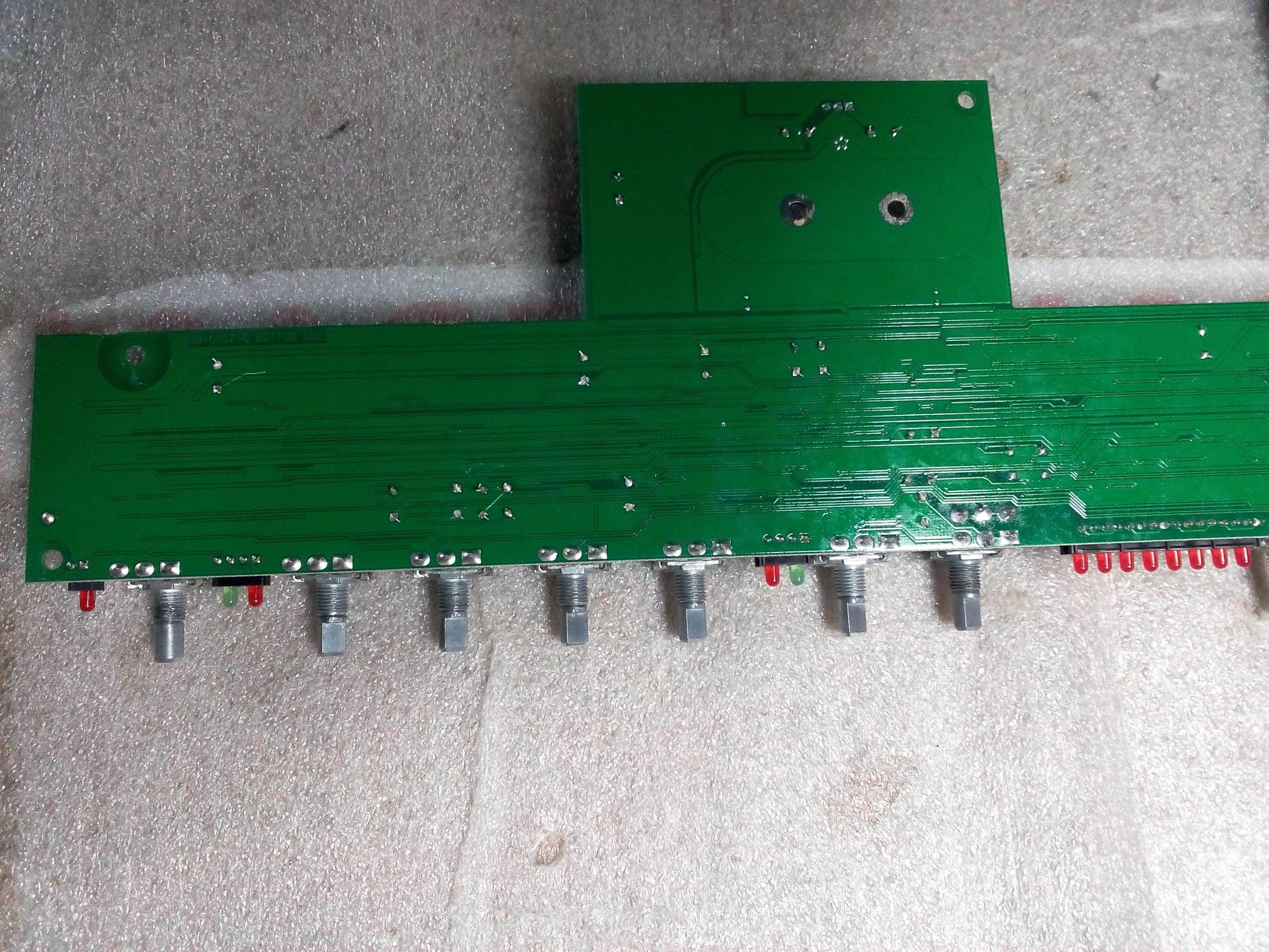

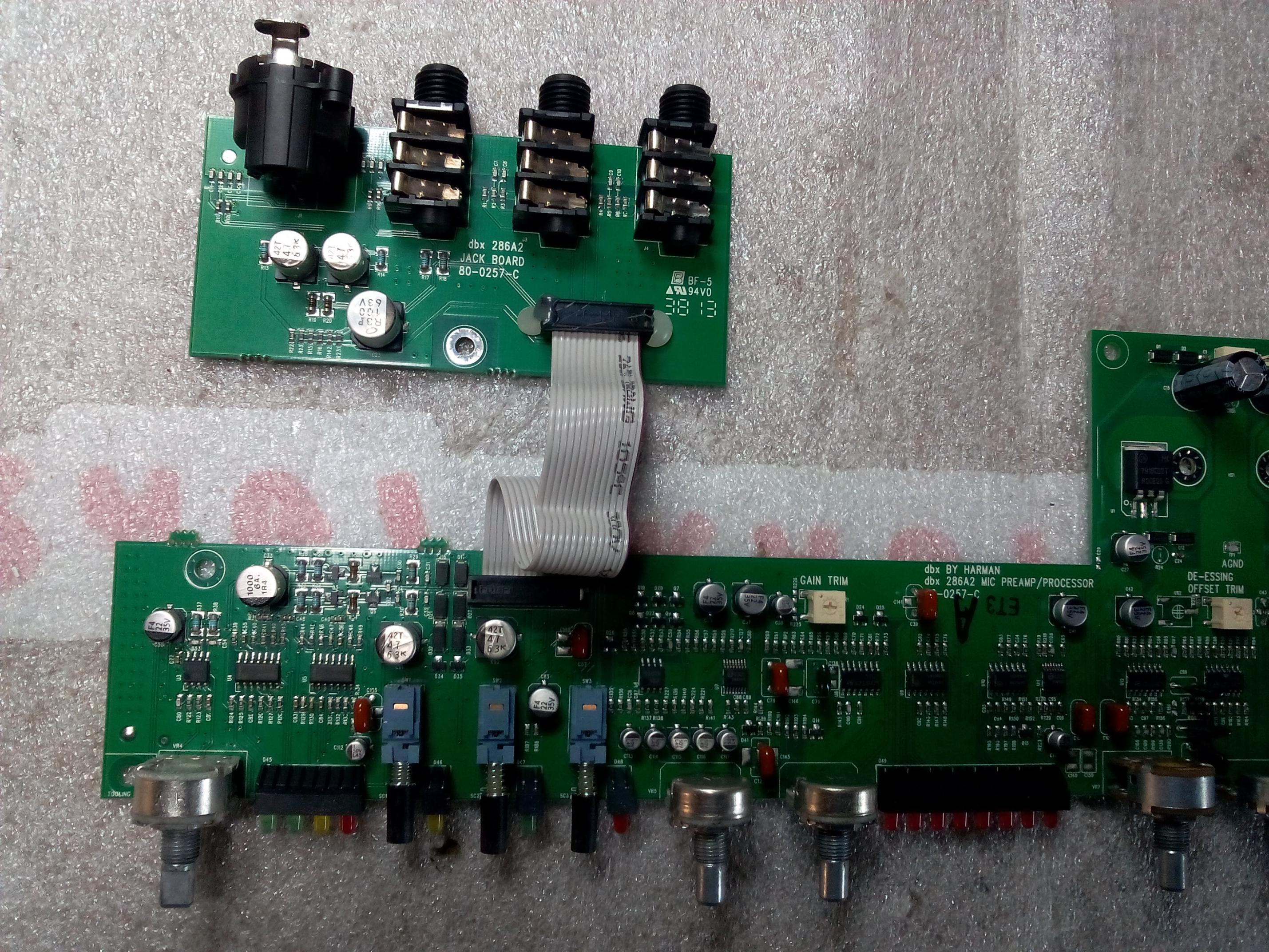

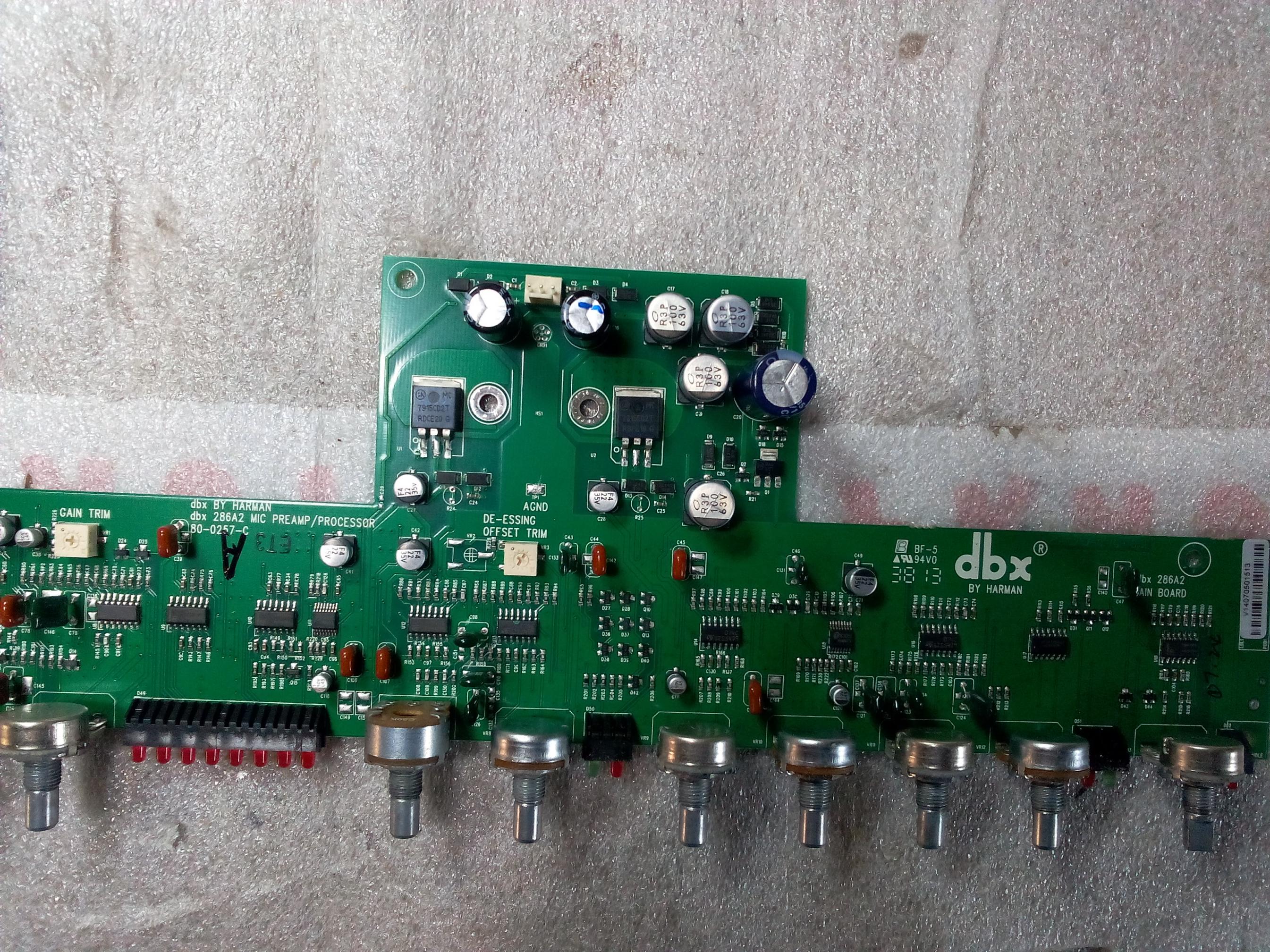

Here are some pic I took from the upside of the mainboard as well as the underside. I cannot make out any kind of ferrite core inductor.
There is also a schematic for this DBX286S, and it seams like there are no 6.81 but 2.0 kohm matched resistors feeding +15V to pin 2 and pin 3 of the XLR mic input.
On the first picture on the top left are the rectifiers, stabis and caps for the +/- voltage. On the right it looks a lot like a cascade to double or triple the voltage, probably followed by some kind of regulation. At least the high voltage rating of the caps (63V) support that theory, and nowhere else than in the phantom power supply such a voltage rating would make sense.
I would check the diodes and change all the caps there.
