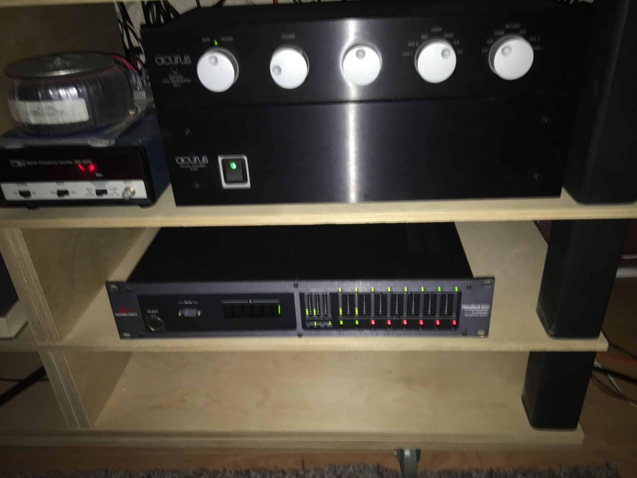

Well, you know I've been on this site for a while and I've had an end game in mind for my stereo system. These days I find myself convalescing to some degree, so things are pretty slow around my house, so I got the time and all the hardware. This project is based on what I think would be the best diy system to play with building active speakers and have the most flexibility when tuning a multichannel active speaker system while still having a way to easily switch back to an everyday system that can run a fully passive system for everyday listening that doesn't consume as much energy.
Recently I was able to horse trade for a dbx 4820, well I don't need to tell you that this is just what I was hoping to base this entire system around. It has direct balanced digital inputs, room correction, a multitude of features for sound contouring and measuring. I guess I could have gone the minindsp way or deqx but these solutions just don't seen as interactive and I just wanted to take another approach.

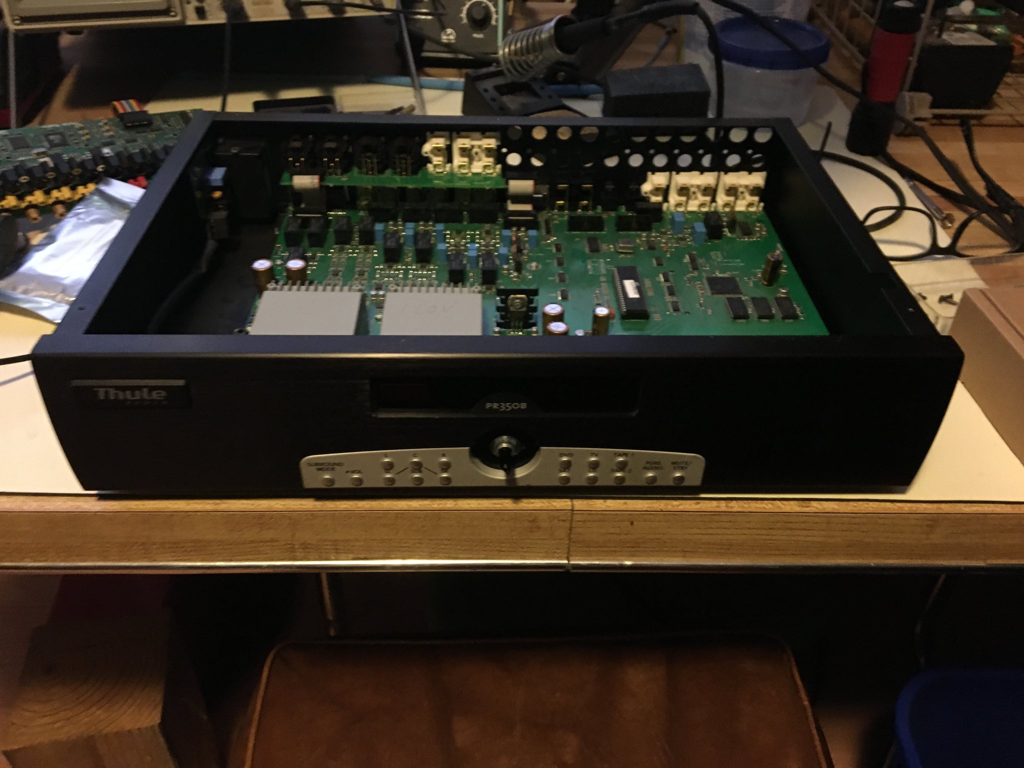

The only problem with the 4820 is there is no easy and cost effective solution to controlling all the 4820's channels volume simultaneously. It needs to be good quality. What I really need is a serious 6 channel preamp that also has a feature to run a separate amp and speaker system for everyday listening. I scoured that net for something suitable and came up with the Thule PR350. This is a really decent analog preamp, looking a bit more into it reveals that it has a completely seperate digital and analog sections and the seperation between the circuits (for the most part) it controlled by mechanical relays. That sounds like it would be super simple to modify into exactly what I need.
So the features on this preamp that I will use are the direct 6 channel RCA input to control volume on all 6 mono amps powering the active speaker setup and then the preamp also has a feature to have a separate direct XLR in to XLR out with simple buffer and volume to control the passive setup. The opamps are mostly OPA2134. These are excellent quality opamps. The volume control is handled by several lm1972 ic based volume control chips. These are excellent volume control ic's and are still in production today and seen in some seriously high end gear.
So you see how this project is going to play out, I'm not really sure anyone else is going to be interested but for the curious I will post my progress on this thread. The first step is repairing the Thule, it has some blown opamps but the control circuit is in great shape. I've used this preamps direct XLR feature for many years. It is a really high quality direct volume control. The circuit for this feature even has it's own little, highly regulated power supply. It's a beautiful preamp.

First order of business is repairing the Thule, it's been broken since I got it, although I've just never needed the features that were broken so never bothered repairing it. Now I have a purpose for it!

in case any are wondering about the Acurus equipment in the photo these are the posts of my rebuilds of an Acurus RL-11 and A-150.
https://www.diyaudio.com/community/threads/acurus-a150-rebuild.355971/
https://www.diyaudio.com/community/threads/acurus-rl-11-rebuild.377026/#post-6785830
I was always surprised that no one ever commented on my a150 rebuild. That is such a popular amp to rebuild and as far as rebuilds and upgrades go I think I took it about as far as you can go!
anyways that is probably what will be powering the passive side of my project mentioned above
