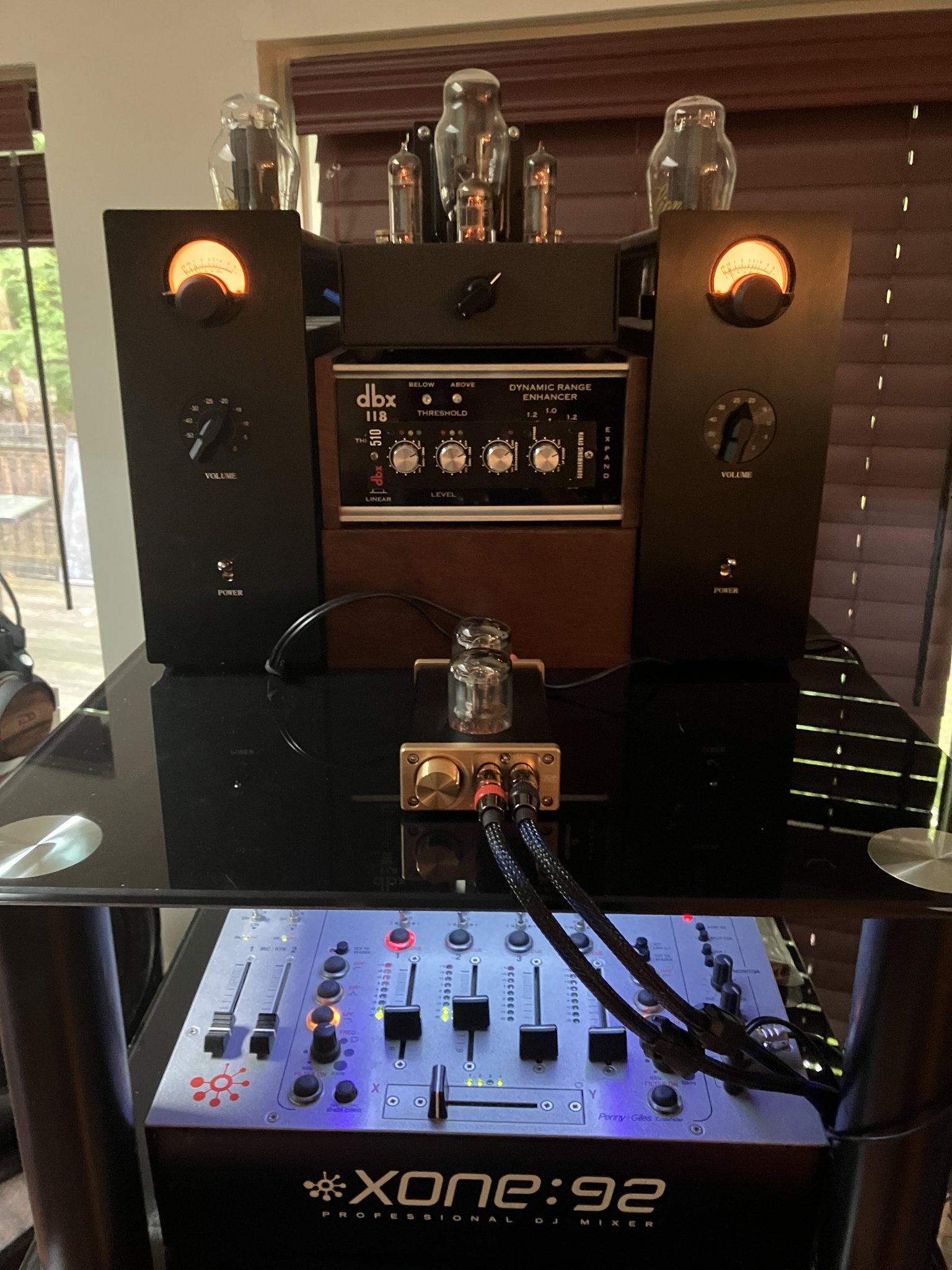

I've added a DBX 510 sub harmonic synthesizer to my setup.
I mounted it in a vintage DBX 118 box.
The description is below. It really adds a new level of sub bass and feeds a Carver and CSS sub.
It does need a bi polar +/- 15 volt power supply. Linear preferred.
I like it.

Looking good. What music do you use it on? I tried it with pop music but did not like the reduction in clarity.
For all of us interested in how this works, there is a schematic of the DBX 120XP floating on the internet. It starts with bandpass feed of the bass. It is clipped to a square wave and fed into a flipflop, which halves the frequency. This lower frequency square wave is used as a control signal, to toggle a gain stage between inverting and noninverting. The original bandpass feed is passed through this stage to synthesize the subharmonic.
