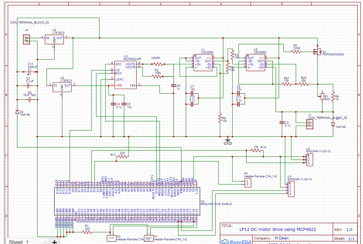

Here is a snip of the circuit I have. Its controlled by Arduino and I have a PCB stacked onto a MEGA board. To explan some details J4 is DC in. J1 is connection to the motor. R1/R4 is set to match the terminal resistance of the motor. U8 is for Hall sensor. P3 is a momentary action switch. Im using U9 for LCD display and P1/P2 for LEDs for speed warnings. Voltage is controlled by a voltage DAC where im using both channels output A for course adjustment and B for fine adjustment. There is more than enough resolution to control speep very accurately.
And the Arduino program is copied here...

Hello deano1712,
very nice work.
Two questions about it:
1. Is the alignment of the two diodes (D1, D2) correct?
2. Is the thermal compensation via the resistors (R1, R4) necessary at all?
You are measuring the speed of the disk directly. All errors are compensated for there.
And the thermal changes take place very slowly.
Greetings
Thomas
Thomas
Yes sorry looks like the diodes go the other way. R1/R4 are not for thermal compensation it's for load compensation. It's possible to set it up to achieve a constant speed with variable load. This is useful to improving speed accuracy when stylus drag varies (which it does). However I believe the main benefit is during startup. Om my LP12 it gets up to speed within 8 revolutions. This is fast enough to be OK by the time you can move the tonearm and lower it. There is no need to wait. If the motor is supplied by an uncompensated voltage motor starts much more slowly and it's a matter of waiting or giving the platter a helping hand to get it going.

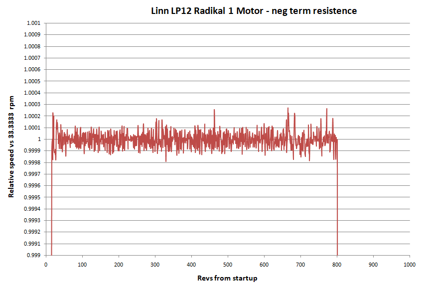

The platter responds quite slowly to speed corrections so if you try adjust more than once per rev I expect it could be unstable. I have found measuring every rev and making adjustments every one or two revs works well. THe speed trace below is my setup with the drive circuit shown which seems more than accurate enough for a turntable drive.

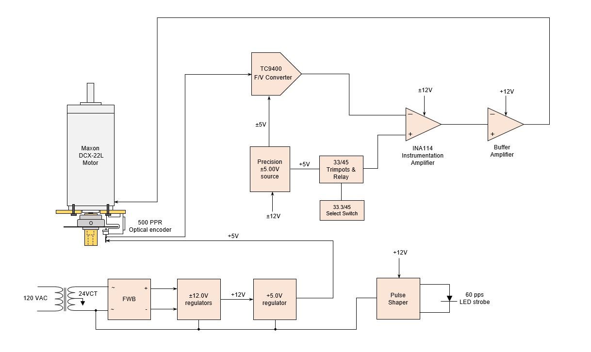

One means of increasingthe feedback loop accuracy is to attach an optical encoder onto the motor. Such an arrangement with a 500 PPR encoder provides several thousand readings per platter revolution. The large platter inertia will require that the electronics loop be filtered down to a significantly lower frequency. However, the error signal will still be proportioonal to the RPM error, I designed and built such a circuit as a replacement for a Papst motor. Space considerations forced me to mount the encoder directly on the motor chassis. However, Maxon does make motor/encoder combinations that would save you a lot of mechanical design and machining effort. I'm including a block diagram of the circuit as an attachment.
Jeff

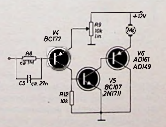

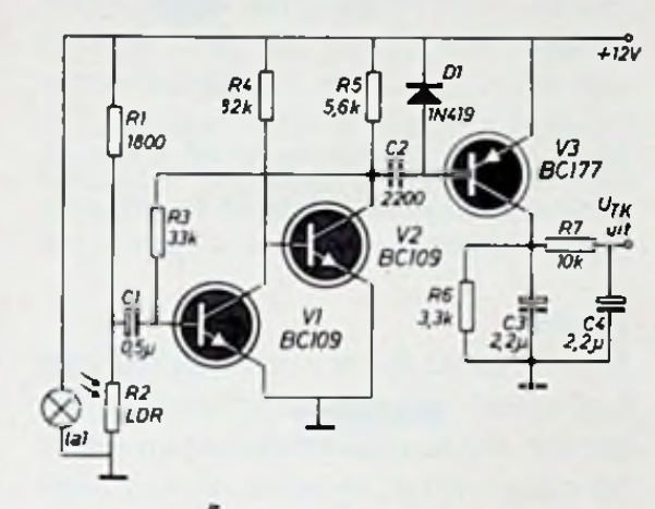

I have to smile when I see that a basically very simple analog control loop has evolved into something into an Arduino system. If that is 50 years of progress...
Back in 1980 when I was a student I built my own turntable lacking the funds of buying the Philips 212 which I actually desired.
This circuit was published in the Dutch magazine Radio Bulletin in March 1976. The first part is the optical speed sensor and the V/F converter with its output at R7. The next part is the motor controller. The input of the controller R8 has to be connected to R7.
C3/R6 determine the V/F conversion constant. The circuit was designed for a DC motor at ca. 2800 rpm and 4 pulses/rev. V4 is the actual comparator, R9 sets the speed.
According to the article C5 was needed to get the control loop stable. The V/F has a (fairly large) time constant. A time constant in the feedback loop is a problem for stability. Hence C5 was added to compensate. I assume a heavy platter or a time constant in the motor control circuit which is large in comparison with the V/F also helps in stability.
If I had to redesign the circuit today I would do a proper control engineering analysis. However I knew this after I graduated in 1983. And in 1984 when I still believed in progress I purchased a CD player.
The light bulb / LDR can be replaced by a modern optical sensor, it does not have to be slow.
The DC motor driving circuit has to be adapted for the motor requirements and modern transistors. Although real audiophiles might advocate the use of the Germanium power transistors for better audio quality.
The complete edition of this magazine can be downloaded here: https://drive.google.com/file/d/1VkrB77BC2-MSPZvcAyNXbNBbVoF0t50e/view?usp=sharing But it might be of limited use because it is in Dutch. And it is a scanned so hard to copy & translate.
Since I object against posting links in this forum to sites where you have to register first, I attach the article. Although I am aware of the limited use due the language barrier.

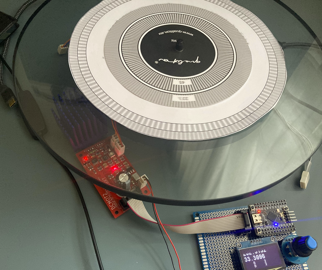

Hello,
I want to develop a (for me) new motor drive, with dc motor. For first, I want to make it work with DC motor, with PID startup and slow I maintaining.
Next, I will make it work with Papst async motors with controlling the frequency of the 3 phase drive.
Back to DC drive for now, at the moment I use no feedback, only manually control what the motor gets (yes, the speed is measured and on the oled, but it is not used yet in the routine). I would have 2 questions to those who use DC motor drive with the simple stabilized Voltage/Current source with no feedback (where the speed is adjusted with a multi turn trimmer).
1, when I find the Current/Voltage to maintain 33.33 RPM, if I stop the platter, it takes about 30s to reach 33 rpm again. Is that normal?
2, If I leave it turning for a day, it is drifting about 0,3-1 rpm away from 33,33. Is that normal? How do you handle that? You keep adjusting it?(The 0.5rpm drift is measureable with the strobo also, it is a very, very slow move of the bars.
Thanks!JG
