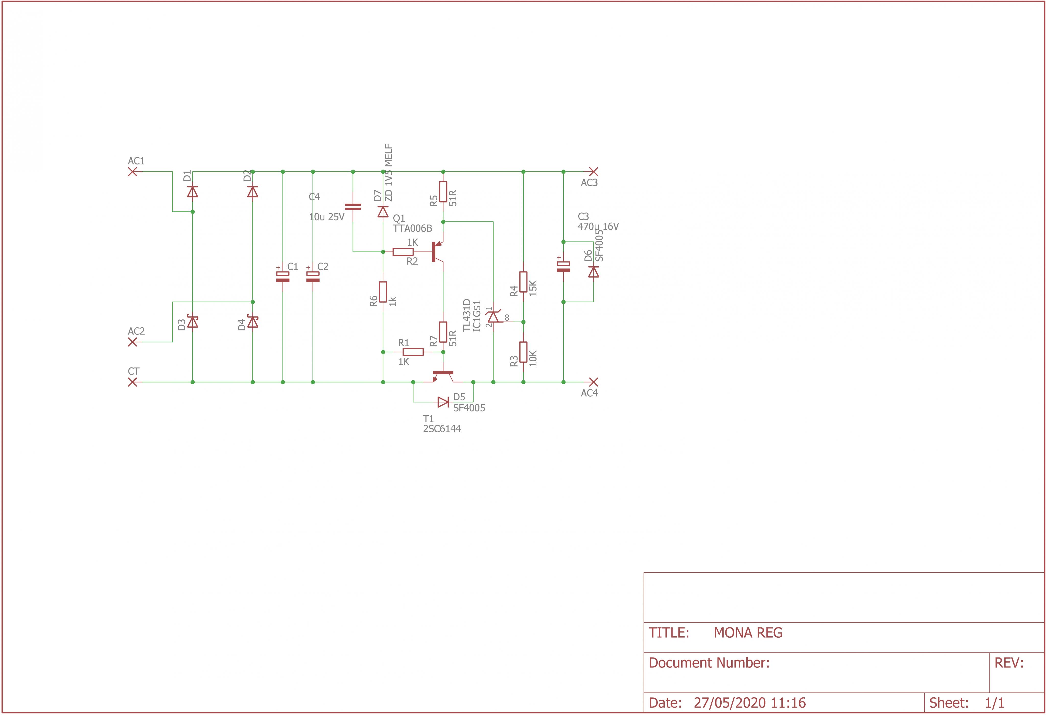

There was a schematic posted by Mona before in a different topic, cannot remember which one. I ran with that and this is the result, it works in simulation and i have a nearly completed design for it that is through hole somewhere.
The PNP TTA can be a plain BD140, and you may need to revisit some of the component values to get it to work. For the pass transistor you can try 2SC6144 or a logic level FET.
For diodes i wouldn't stress it too much, SB540 skottkeys is what i normaly use for this kind of thing.

Thank you for your comments, suggestions and advice. I have moved the design forward and am awaiting the arrival of some components to test out some of the ideas I have. I can always fall back to using the LM317, which I have working for both the standard and elevated heater supplies (the pcb is also designed) but felt there ought to be a more efficient way to generate the DC heater voltages using contemporary components.
