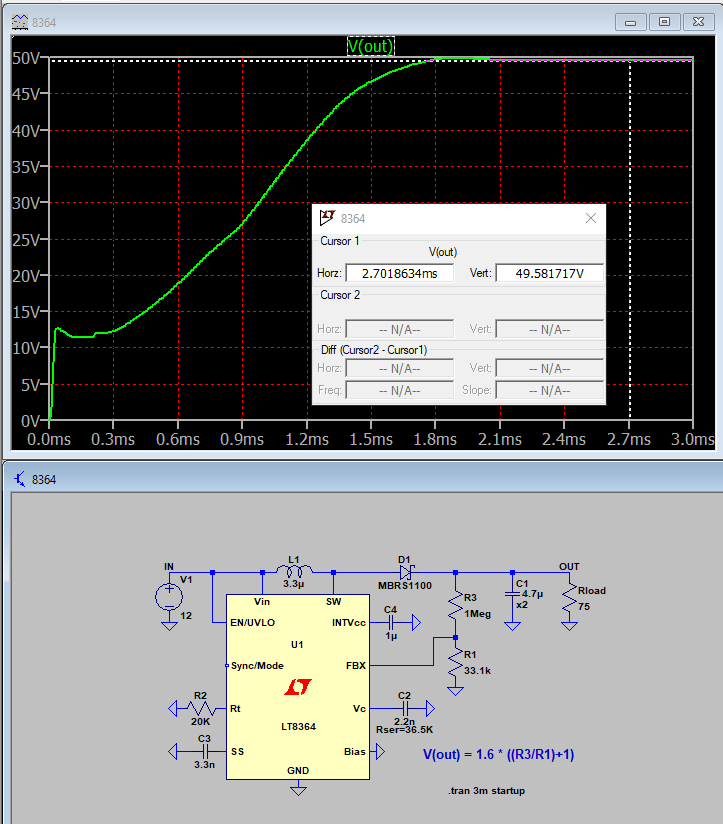

There are almost too many to count. I would use either Linear Technolgy or National Semiconductor stuff. If you go to national.com and select the Webench on-line app, you can put in the specs and it will give you a list of appropriate chips and design a complete power supply automatically, for the one you select. At linear.com, the free LTspice used to do the same thing (and still might), by selecting File then Switch Selector Guide. Both sites have TONS of application notes with DC-to-DC converter (aka switchmode power supply) schematics. And there are many, many chips that can easily do 5 to 10 amps. So your current and power requirement should be absolutely no problem, in that sense.

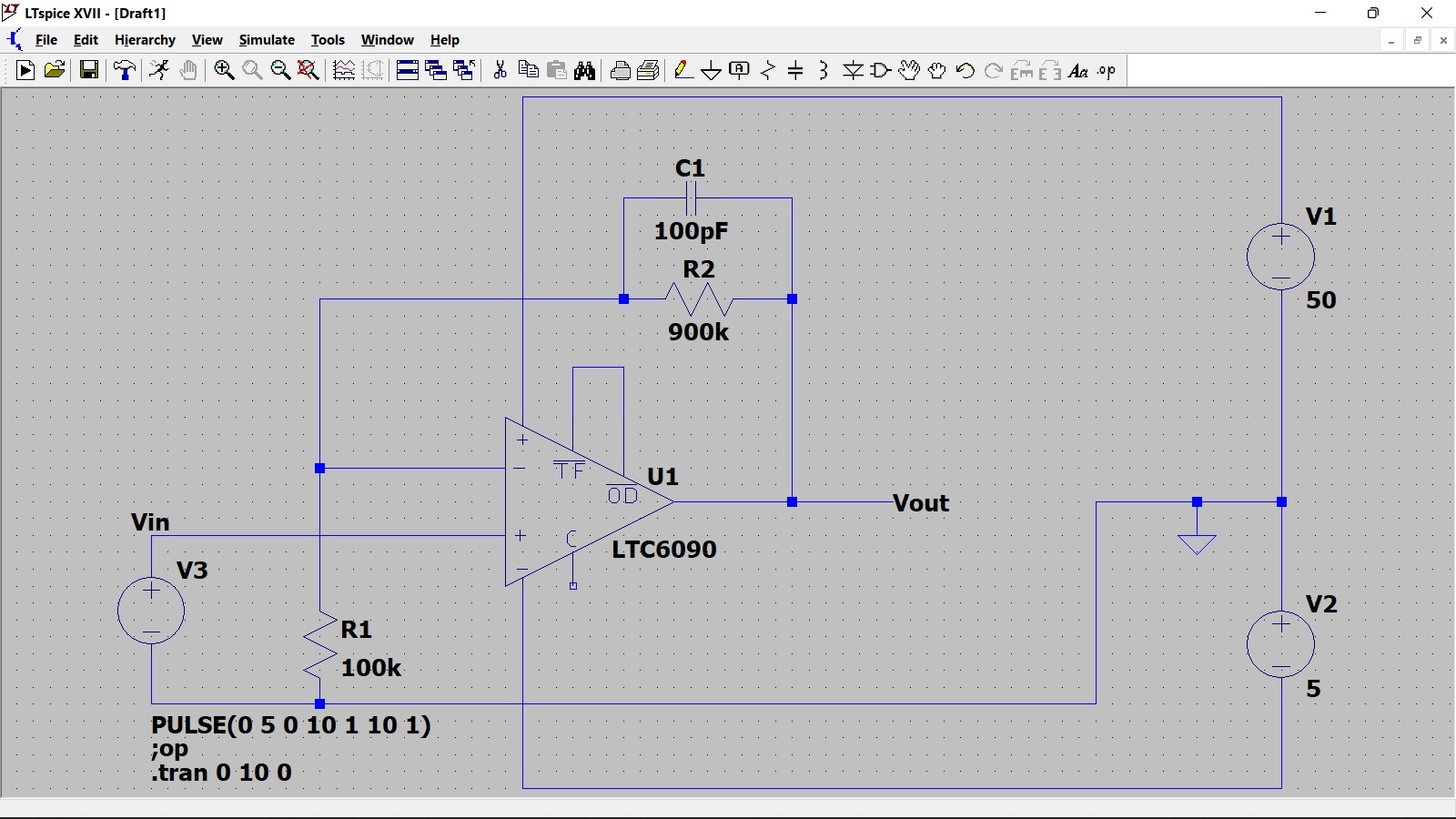

The big problem I see is the power supply needed, the 0 to 5 volt into 0 to 50 volts could be the easy bit if you use a high voltage opamp configured for whatever gain you want. That is the simple part.
The problem is that to get to +50 volts output swing needs a supply a bit over that together with a lower voltage negative rail of even just a few volts (to allow the opamp to get to a true zero output).
There are opamps available that have a total supply voltage rating of 140 volts (like the LTC6090) and probably lots of others that fit the bill as well.

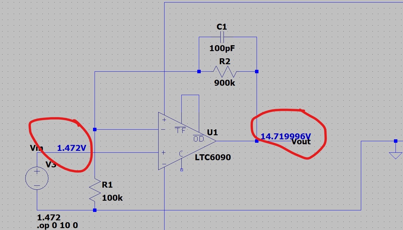

Something like this. The 5 volt rail just gives a negative supply. If the circuit is self contained then this can be derived from a single rail by means of a Zener or LED.

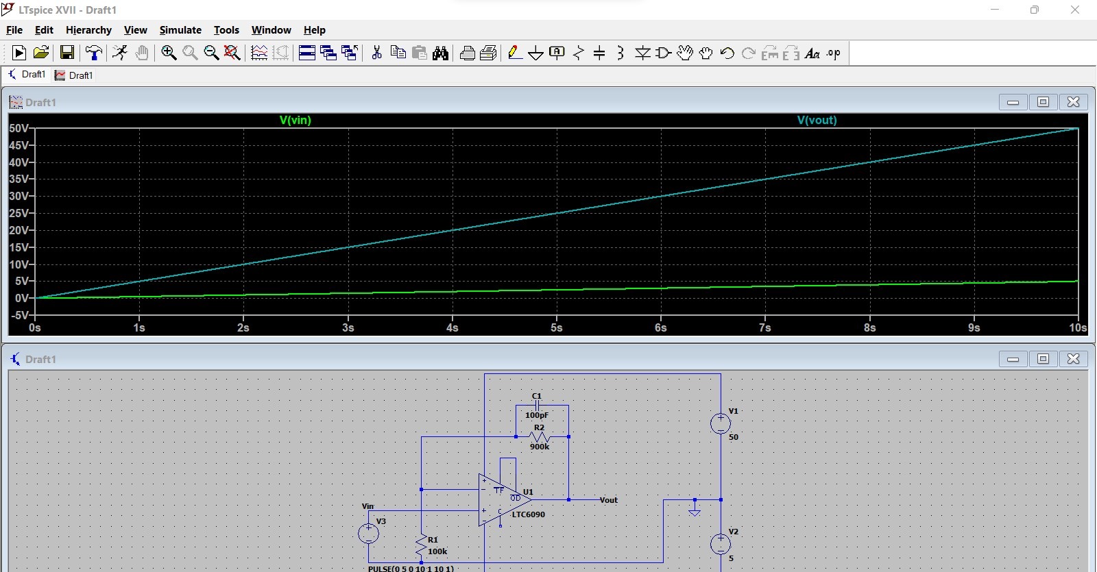

This shows the input and output voltage tracking between 0 and 5 (0 and 50) volts. The DC gain is set by the ratio of the resistors (900k/100k) + 1
High values give lower current consumption but can be any values that give the required ratio.
Final shows shows the accuracy, it is essentially determined just be the tolerance of the two gain setting resistors.
The cap is for stability (to prevent oscillation).
