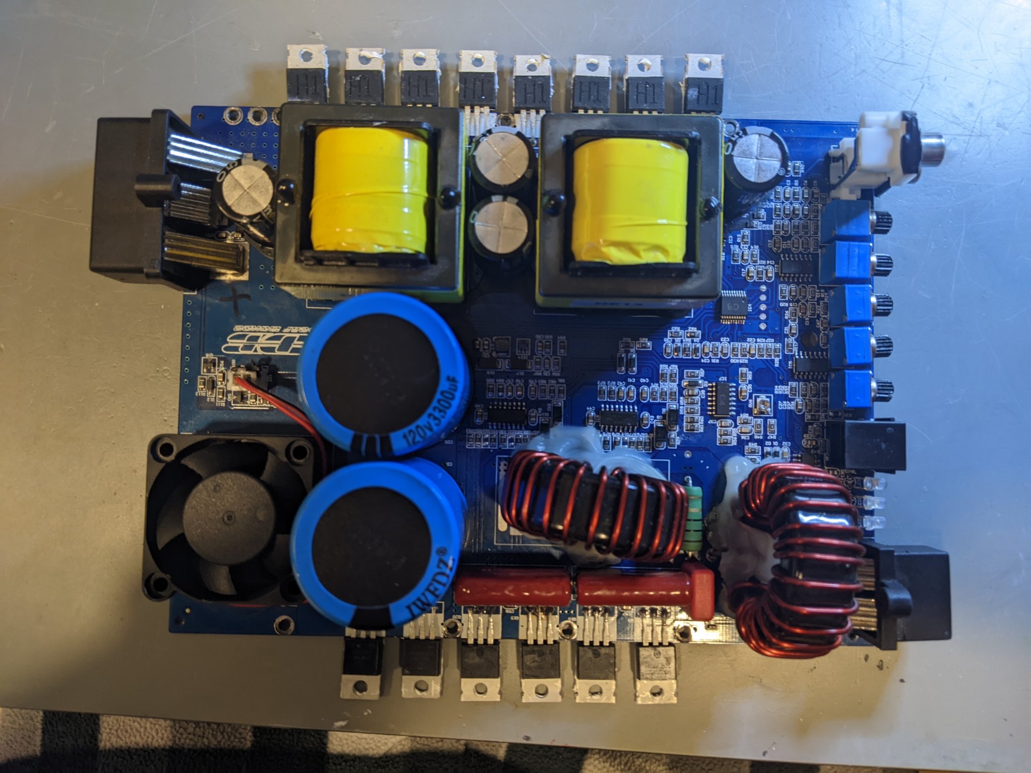

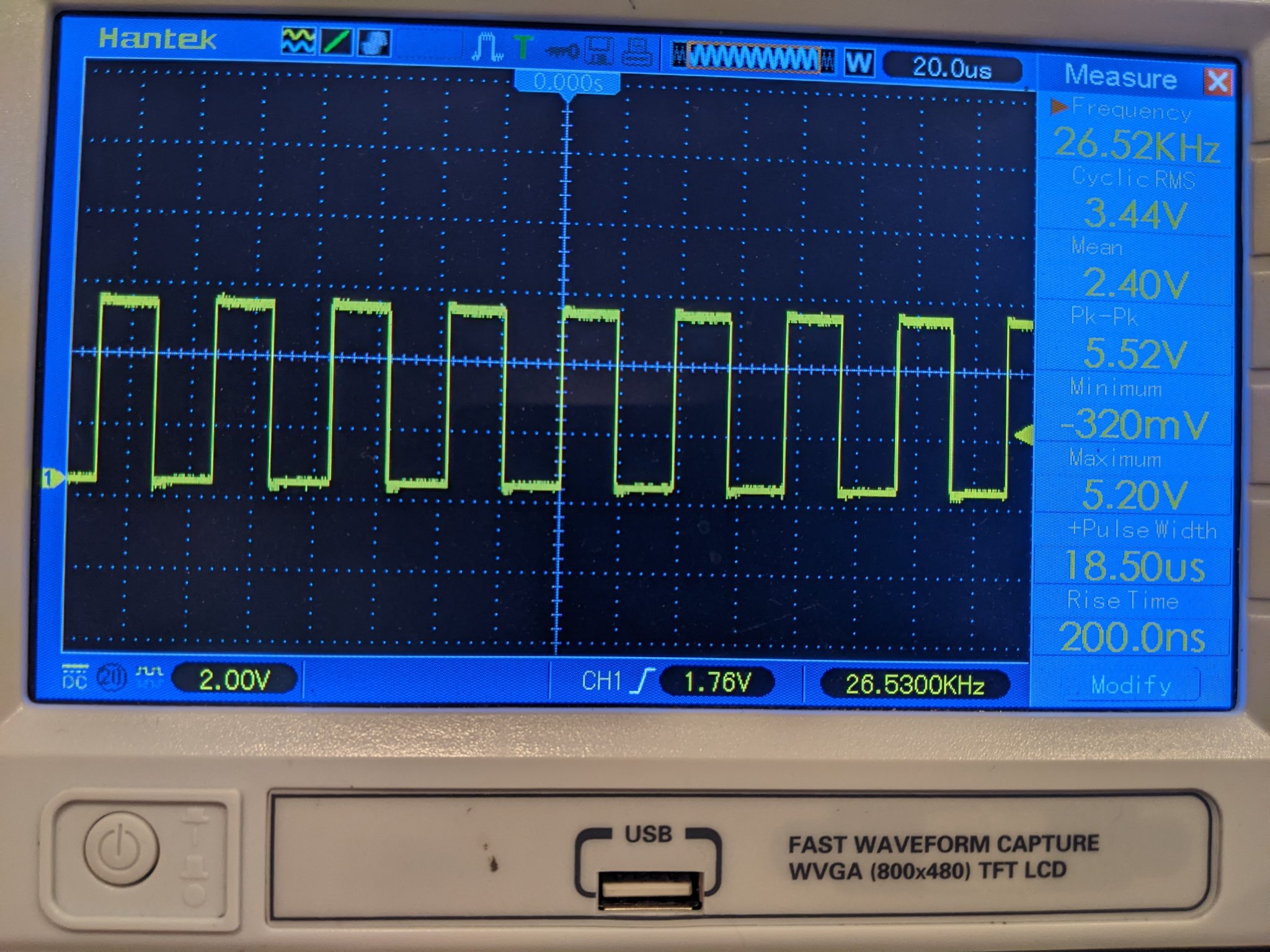

Purchased this amp a couple weeks ago.
Arrived with fake irfb4115s (reworked). Rdson of those parts was in the 170mOhm range. Also bridges we're blown, irs20957s chips likely bad, and some rc filter damaged.
I have legit irfb4115s in, new bridges and all else patched up.
The amp has a couple issues with starting and running above 14v though.
It takes considerable time to start, the power supply pulses, LEDs all blink, and rail caps slowly charge, it starts eventually. I removed the rail caps and they measure ok. They are back in now of course, didn't run amp with them out.

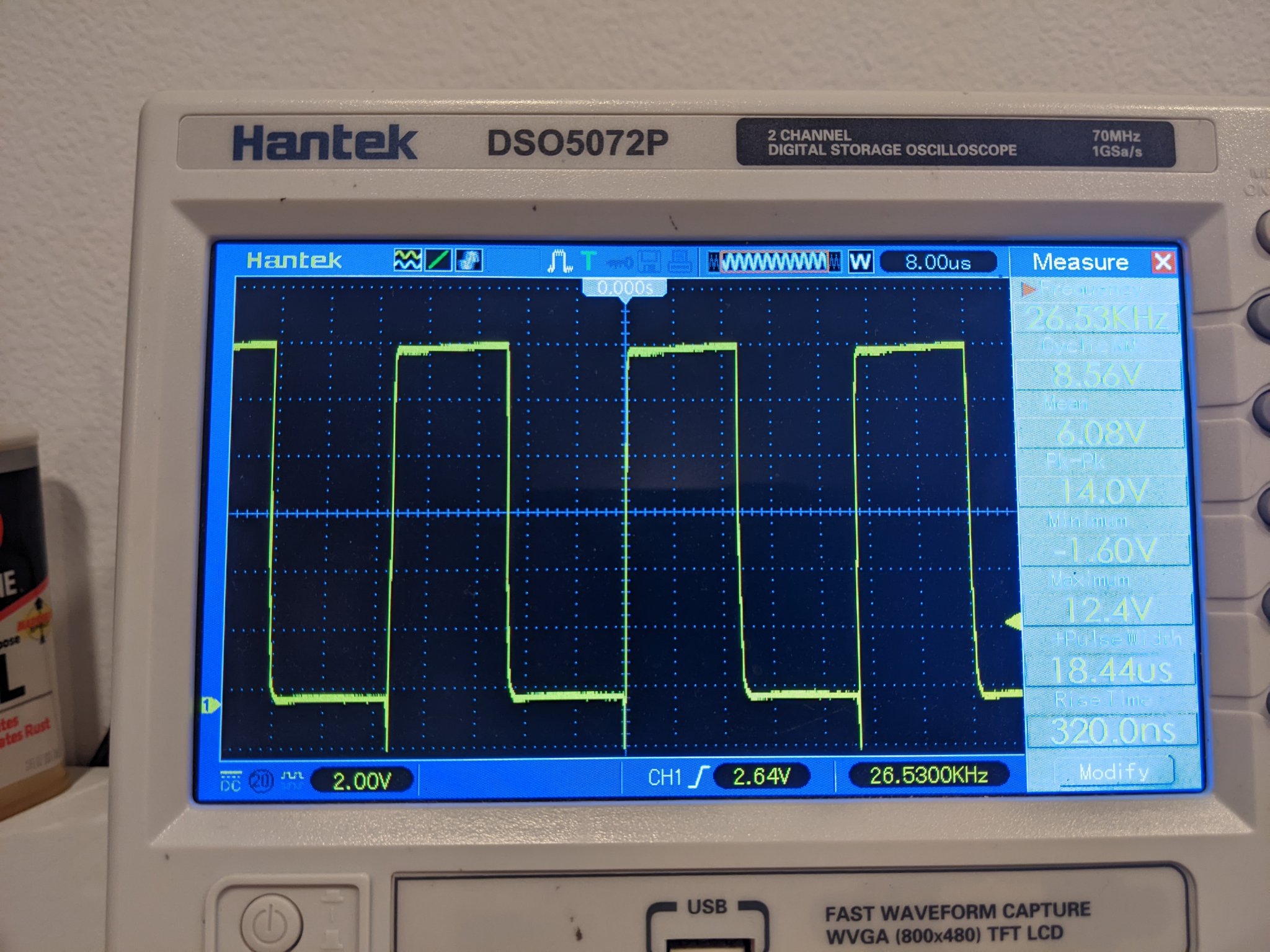

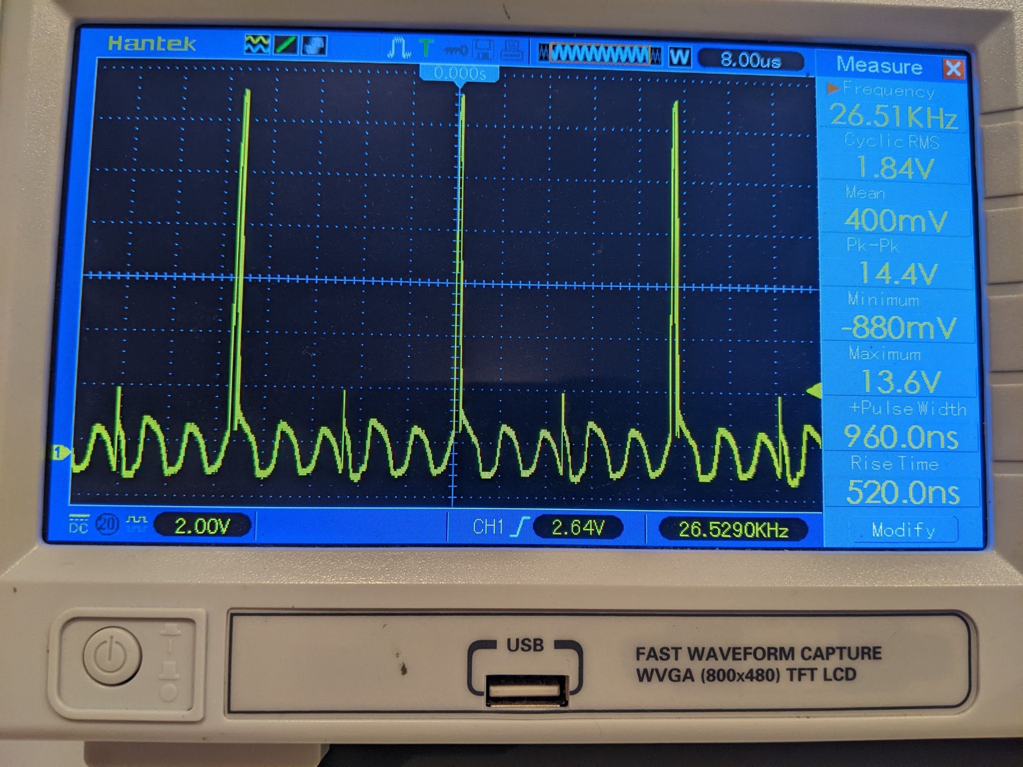

If I get it started and run it over 14v, the power supply waveform goes from good looking to a narrow high amplitude pulse and current draw decreases from 1.3A to about .7A and bounces around. Rail voltage remains ok, but is clearly in unhappy state. 7524 driver chip becomes quite hot.
Was considering ordering driver chips but the waveforms look the same on input and output when acting up.
Any ideas?

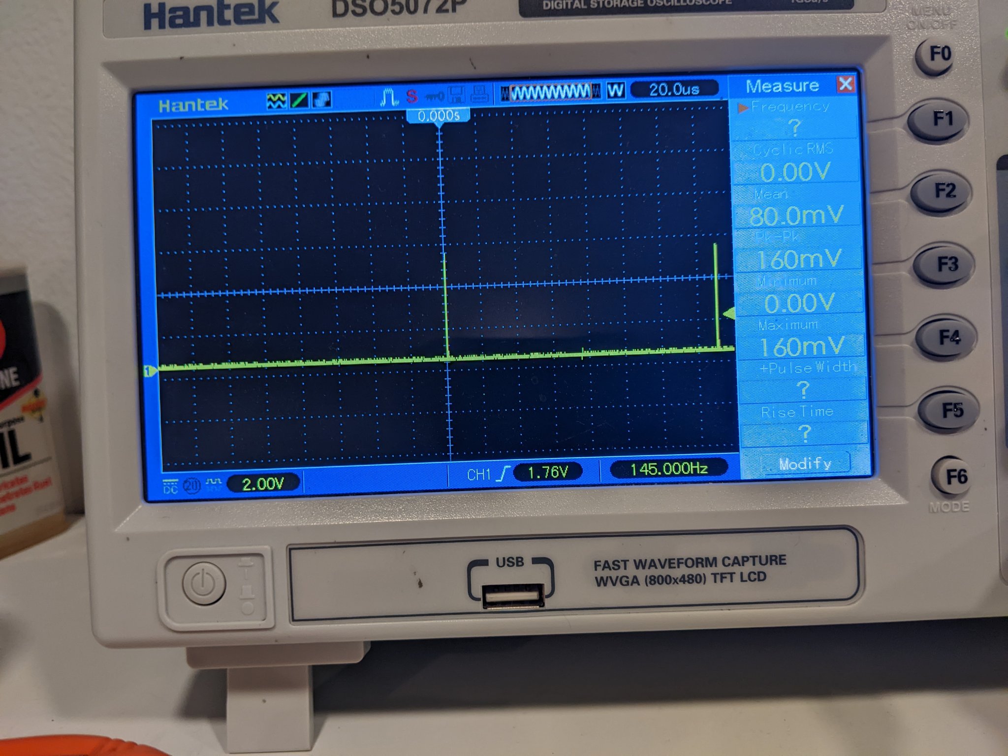

Are you sure that the amplitude increases when the pulse width decreases?
Is the change in pulse width abrupt or smooth?
What's driving the 7524?
The microcontroller is driving the driver chip.
Shots of ps gate and 14.1v and 13.1v input. I guess amplitude didn't go up much in fact.
It abruptly changes.

This is how the microcontroller regulates the rail voltage and isn't a problem.
Make a note of the DC voltages on the MCU when the amp refuses to power up and again when the amp is functioning to determine which input is causing the startup problem.

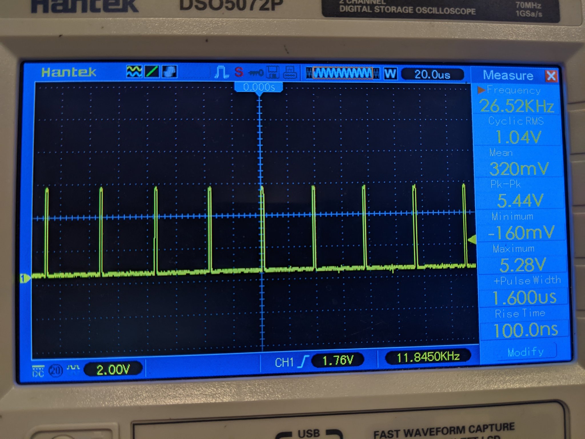

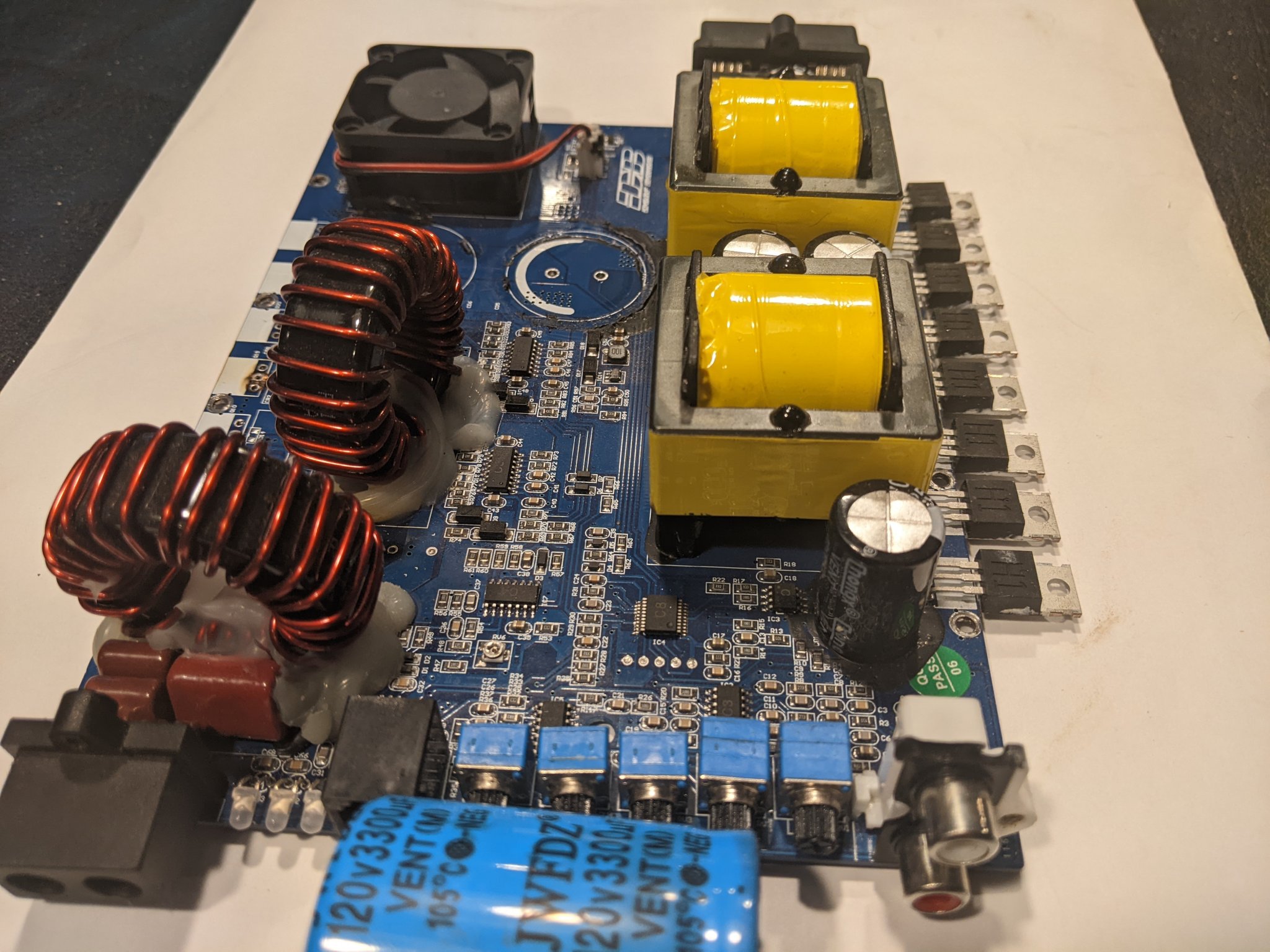

Poked around for awhile figuring out micro pinout. Figure this will be semi useful for these Brazilian cheapo amps.
Pin1 buffered remote turn on in to micro
Pin2 led
Pin6 driver out
Pin11 measures gate switching on outputs. Output gate to 1k to cap to small diode bridge to micro.
pin12 led
pin13 led
pin14 rail voltage measurement 22k/1k
Pin16 driver out
pin 17 through diode to irs20957 pin2 mute
pin20 gnd
Focusing on pins 11 and 14: 11 goes from 0 to 5v once it's alive and output gates are switching. Pin 14 slowly rises with each power supply pulse but is about .68v when alive (10.8v supply).
Nothing is getting unusually warm once alive, amp is out of chassis, but it seems like something is holding the rail voltage down. It takes quite awhile to turn on while the leds cycle.

Quite a few pins pulse when the supply pulses. Pin 6 and 16 of course. Pin17 pulses half a volt up when power supply surges. Pin11 pulses with surge. 14 rises a bit with each surge.
