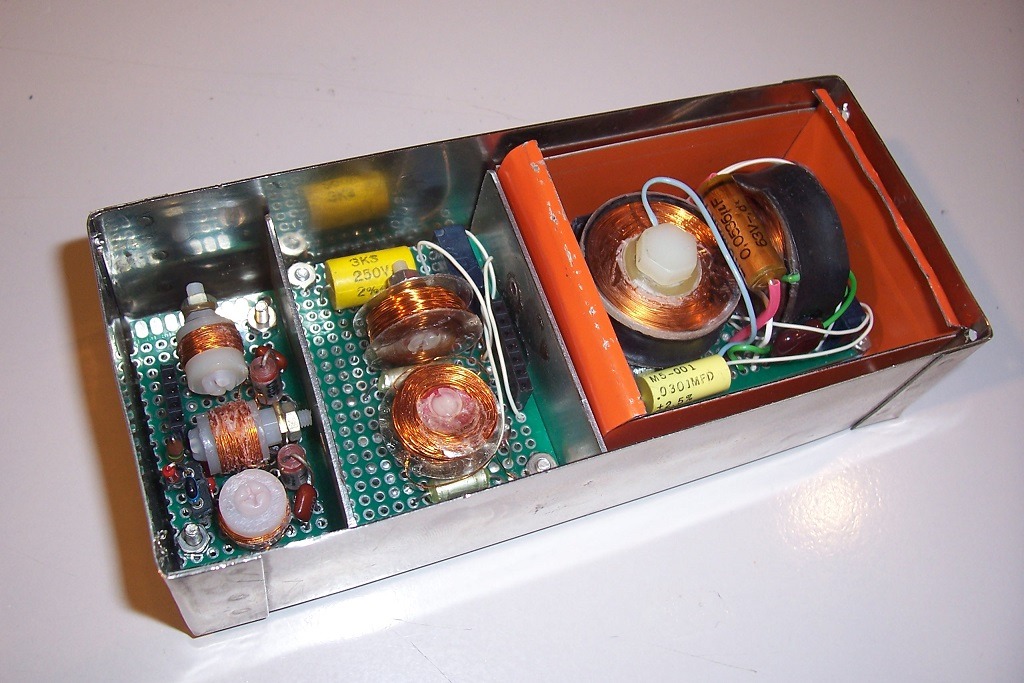

This is what I have built so far:
The three filter sections each have a primary, individual shield, and the whole is housed in another mumetal secondary shield.
In the final design, there will be two additional shielding boxes, as it is the weak point of air-core filter coils. I may need to add another one, of the active, electronic variety.
The 1MHz is already properly equalized, but it was the easiest one
