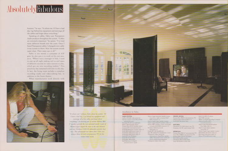

Arnie Nudell did make one pair in piano black which ended up as the rear channel in a loopy hollywood high end home theatre!
I'd venture a combination of the high end audio pricing itself into a niche market (while TVs took over that media tech focus in the household), the vast improvement of driver technology that allowed for lower distortion, higher excursion, higher power handling drivers that could reproduce similar SPL (but not PVL) with fewer drivers in less space and the rise of the "slow bass"/"nothing below 35-50Hz" myths in the hobby that made actual bass reproduction and antithesis to "good sound".
That would be Fabio. Yes, that Fabio. He had an incredible system back in the day and even had one of two pairs of Krell MDA-600S monoblocks (bridged Krell KSA-300S with a KAS style meter).

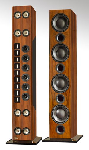

Nola Grand Reference VI Gold:
I'm sure if we look hard enough there will be more similar concepts around.
These bass towers will work much like distributed subs would do. Each driver will have a slightly different distance to room boundaries and working together they even out or average out a lot of room anomalies.
Couple it with todays availability of DSP to get very enchanting bass but in my humble opinion arrays work even better in the midrange, where they avoid (or rather average out) the floor and ceiling reflections.
For bass distributed subs might be cheaper though to get pretty much the same effect. These arrays are a lot less flexible of where to put them than 4 or more subs and will still interfere with parallel surfaces.
