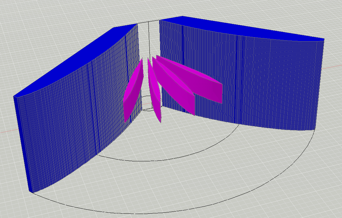

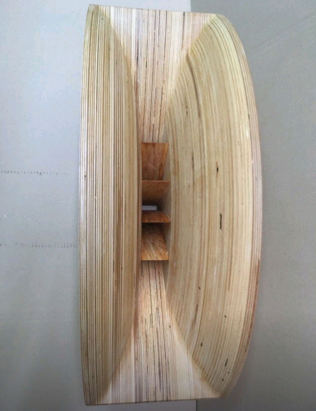

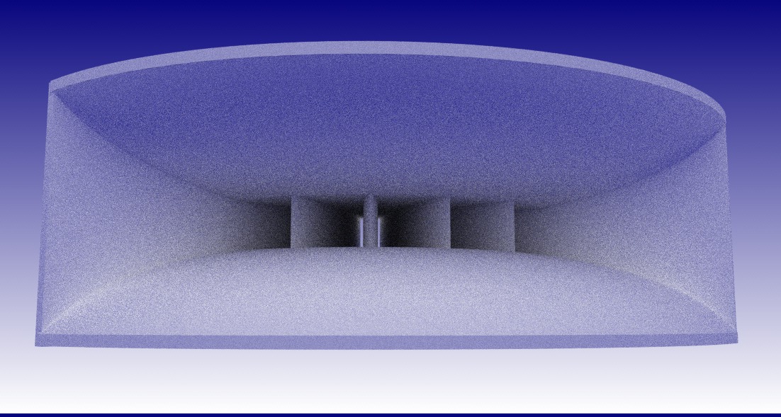

I've also emailed Athos Audio for a quote on his Yuichi A290s and they look great. The question now is whether the phase vanes are beneficial to HF dispersion using the coax drivers I have due to the HF element only radiating in the center portion and not covering the full opening diameter - i would assume the vanes may block HF radiating from the outsides of the horn and therefore hurt HF dispersion (the very thing they are supposed to help with using a traditional single element driver). Not sure how to figure this one out.

The vanes shouldn't get in the way if the wavefront has the right shape to begin with. What having the vanes there allows, is to create the correct expansion without the vertical having to reduce and then expand again. Having multiple vanes also distributes the diffraction of that expansion.

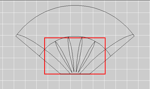

I've made drawings of the Yuichi. As you can see (ignore the red box) if the wavefront is spherical the then vanes do not specifically help, and they do not hinder. In other words they aren't intended to force the highs to do anything.
Reactions: 1 user
@AllenB - That makes sense. I'm quite sure the HF from the DCX50 isnt coherent across the entire diameter of driver not having the room or distance to turn into a laminar wave front (partially due to the extra diameter it needs to expand to), so it must be spherical for the most part. The potential shading by the vanes of the smaller spherical wave front was thought to be partially blocked from reaching the outer sections of the horn.
